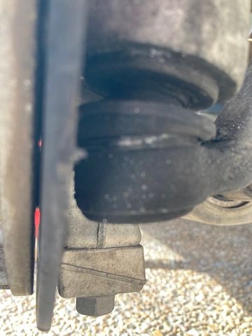

It got warm enough for me to go and pull the wheel off. Everything looked ok upon my first inspection and the there was no play in the wheel bearing. I took pics of everything with my phone. The ball joint looks like it is the problem, to me anyway. The control are bushings are ok but since the car is 16 years old I think I will just replace the entire control arm. Now the question is do I have to go oem or is there an aftermarket brand that is recommended?
