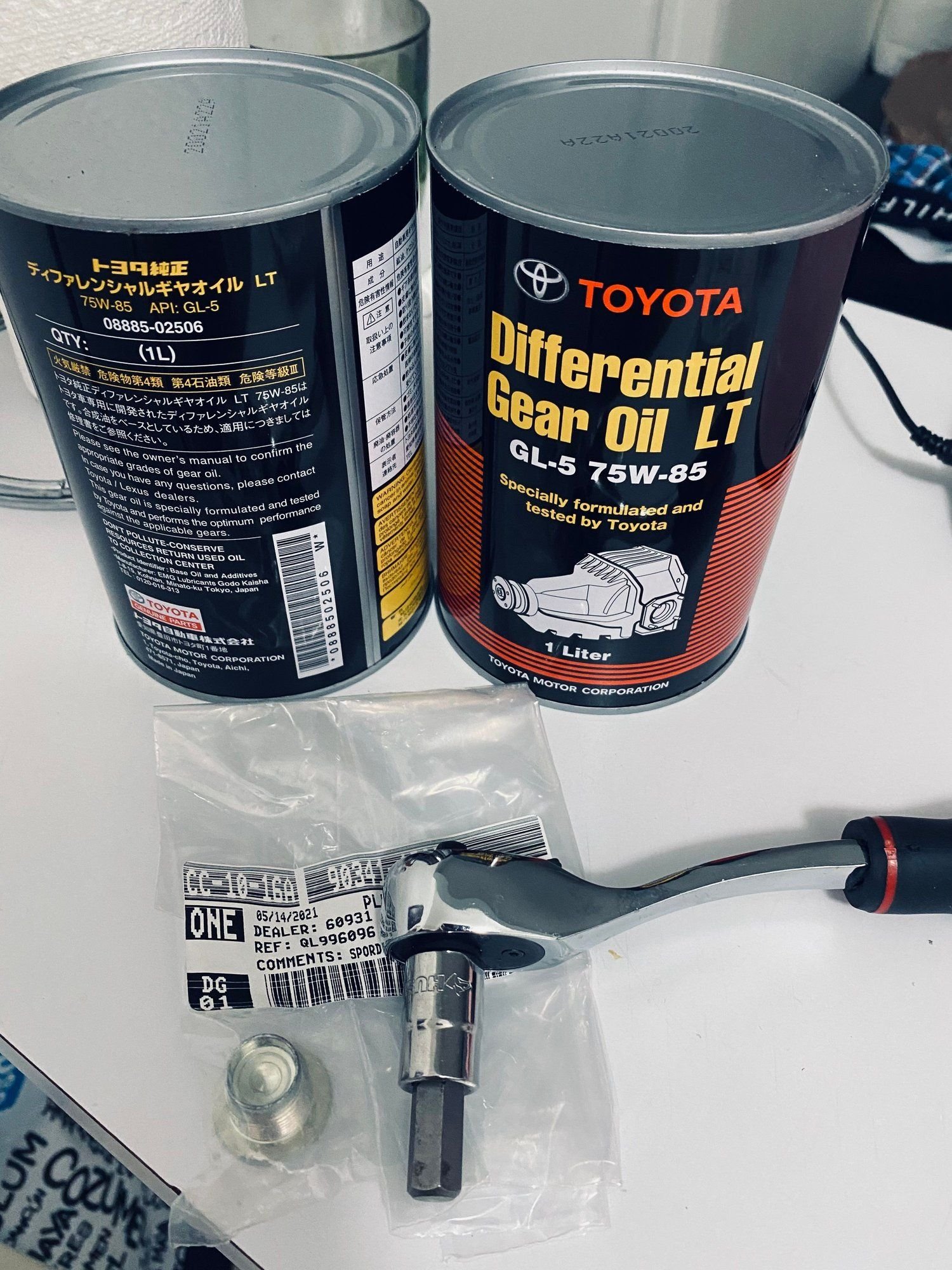

Yeah you just undo the fill plug on the side and then the drain plug on the bottom. You're going to need a 10mm hex bit socket for the plugs and a pipe for extra torque on the ratchet, since it's very rusty. Make sure you undo the fill plug first so you're not screwed.
Rear diff takes 1.42qt of 75W-85 GL5 gear oil. 75W-90 works fine too.

Heres what you need, besides a fluid pump from auto parts store.. skur gave good instructions, I can only add that you could spray the plugs with PB blaster before you start, make it easier.

For a 07 GS350 AWD (double check with your model before buying)
Fill Plug: 90341-18035
Drain Plug: 90341-18032
2x Gaskets: 12157-10010
You can find any part # on parts.lexus.com and put in your VIN. After you find the part, under diagrams it shows the exploded part numbers for everything. I order from discountpartsmonster, mylparts with code CL5, or a local dealership since they usually offer free shipping.
