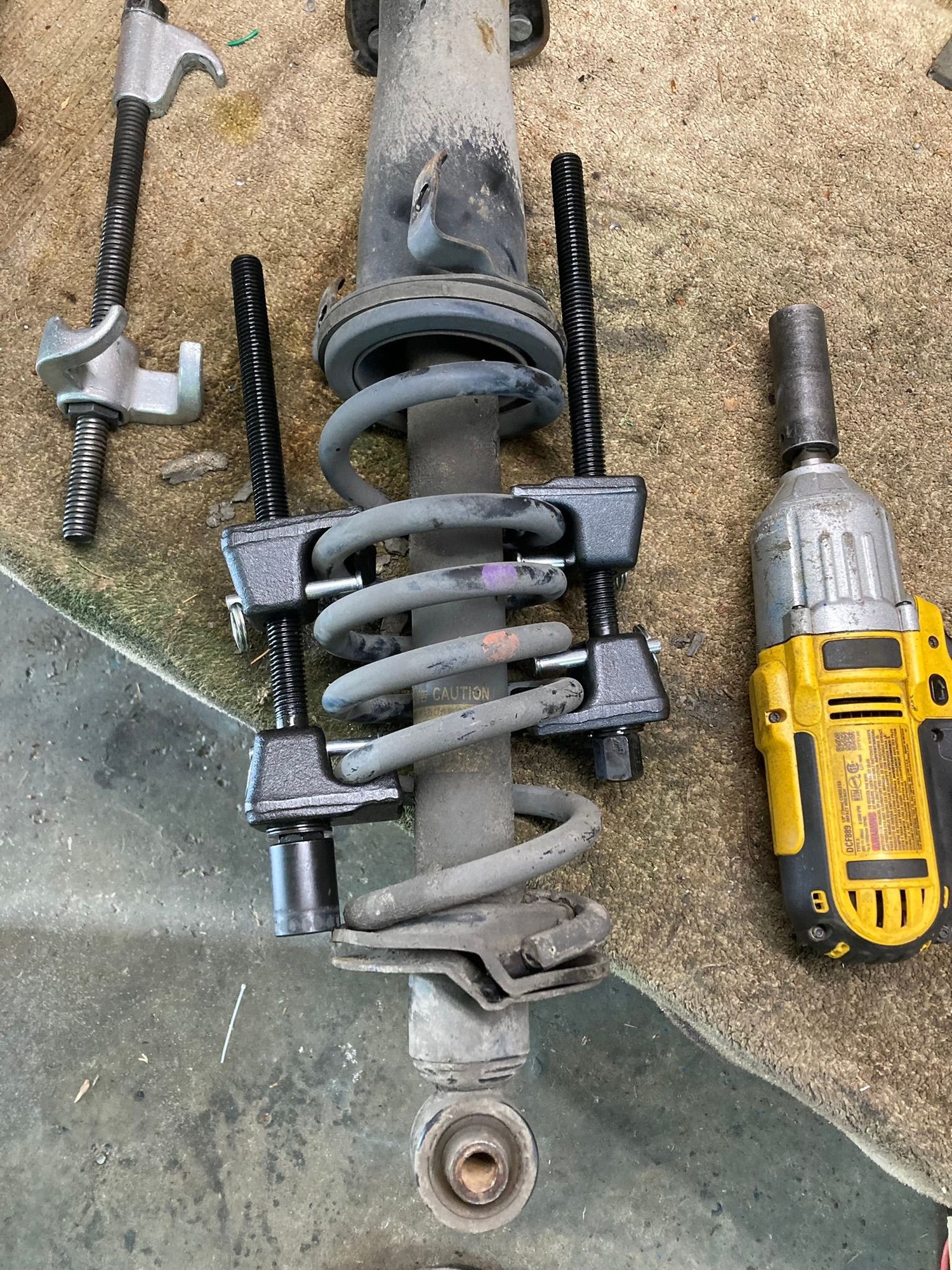

Just to report back, I did the rear suspension this weekend. Nice improvement.
- I couldn’t find decent spring options, so didn’t change them.
- Replaced shocks w/gas-a-just, KYB mounts, end links, and sway bar bushings.
- All other bushings were in good shape.
At 183k, these shocks appear original. Strangely, the right side unit had been out and a new mount installed, but the original shock retained. Left side mount was much more compressed/worn and clearly older.
The car gained 1” or more in rear height. The ride is so much smoother, and the clunk from the worn mount of course gone. A MUCH more annoying job than I anticipated (sway bar bushings baked on, had to cut off links and old bushings, fight the arm and knuckle back together, etc.), but it was so very worth it.
One interesting side note: despite having a set of coil spring compressors (one is on the bench in the pic), I usually pick up a 2nd set from the store loaner tools. I like using three for safety and more even compression. The loaner set from O’Reillys was brand new in the wrapper, and had a feature I had never seen - locking clips to hold them in place. This was a big improvement and made them MUCH easier and safer to use. I did not bother using three.
