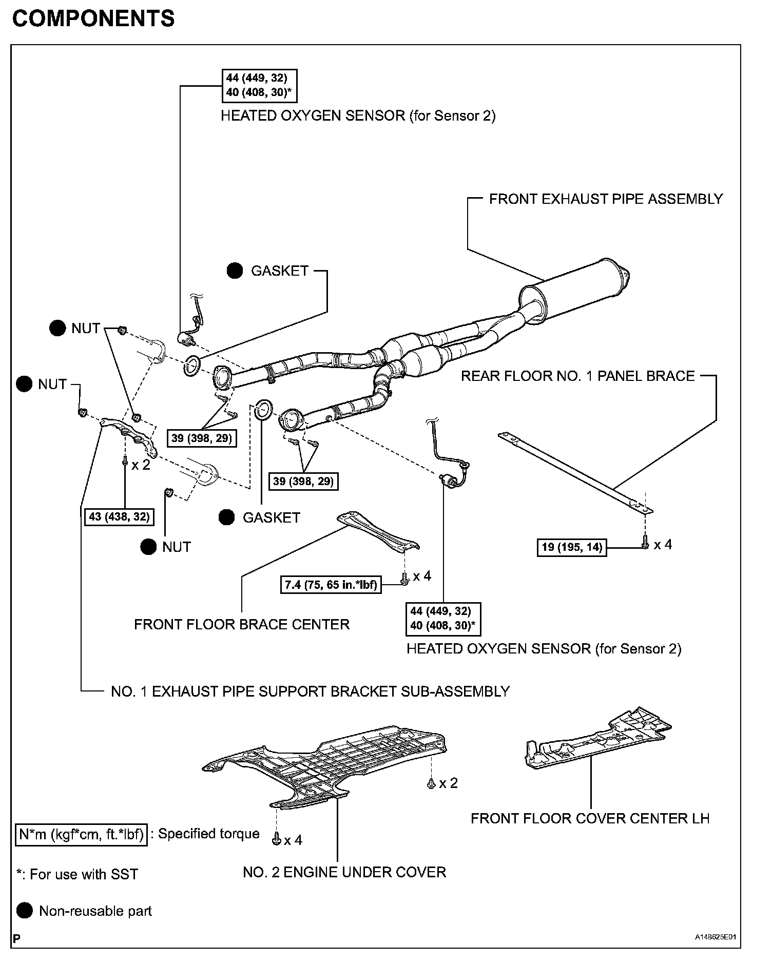

They're not bolt off, the entire muffler and exhaust tips would come off with it. I had my secondary cats deleted
https://charm.li/images/IMP13Q313/asian360/391508037/
