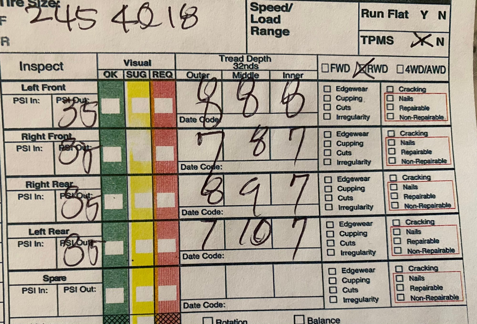

I have a 2008 GS350 RWD, with the optional 18” rim package. I just bought 4 Continental ExtremeContact DWS06 Plus, and had them mounted/balanced at Americastire. A few days later (less than 150miles driven) I notice my car was pulling to the right a bit, so I went to Big O for an alignment. I was given an inspection report which shows the tread on my tires has worn, from the original 10/32”, down to 7/33” in some areas.
Im very concerned and confused about this… is it really possible for these new tires to be wearing this fast? I don’t drive the car recklessly, and I’ve had them for less than 200 miles. (On top of that, my car still pulls to the right after the alignment)

Went back to the same Big O and had them check my tread/alignment again. The employee said the original paper I received is wrong; My tire tread is actually 9/32” - 10/32”. They also re-adjusted the alignment, but upon leaving I noticed my car STILL pulls to the right.
Just for a second opinion, I went to the Americas Tire where I had them installed. The employee said my tires are practically brand new still, and he even showed me the numbers after each reading; They all showed 9/32”-10/32”.
Needless to say, I’m glad to hear that my tires are still good…But I am very much concerned on why the car still pulls to the right..? I don’t want this to have any negative effect on my tire tread down the line, so I’m making an appointment with my mechanic to have him inspect the parts that have been mentioned. Will update again.
