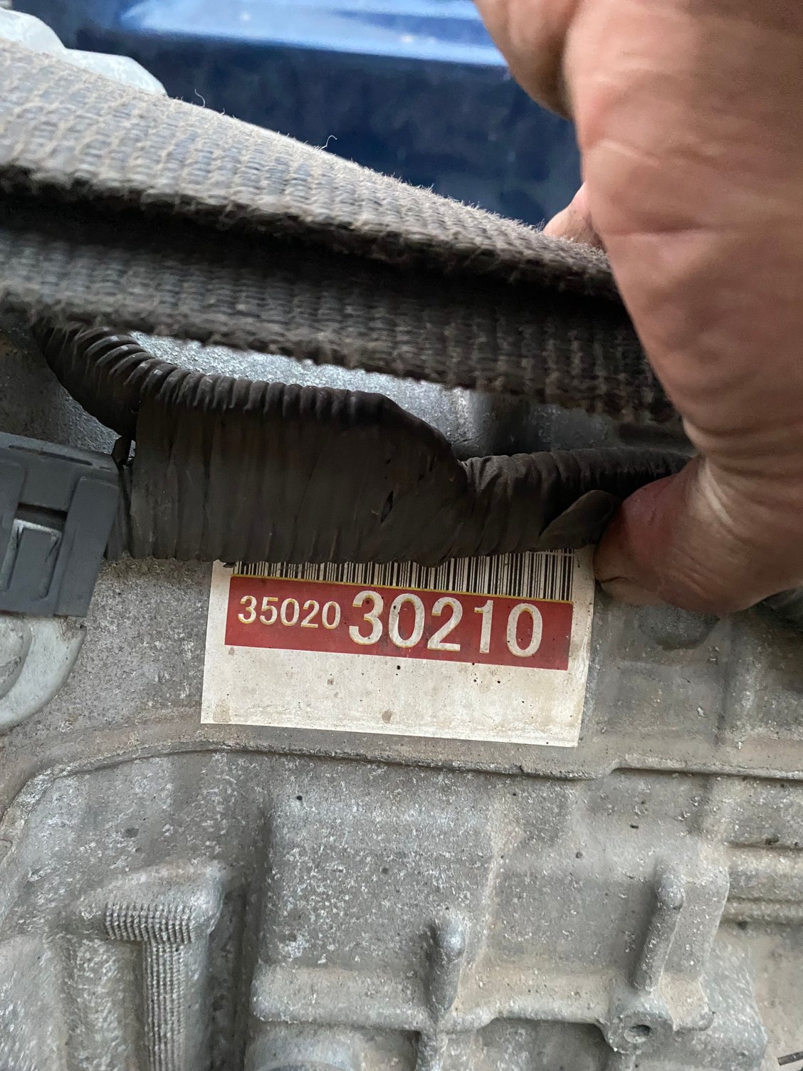

I could be wrong, but my understanding is that the 3UZ was mated to a 6-speed transmission whereas the trucks and SUV’s got the 2UZ with a 5-speed auto. If this is the case, the electronic throttle body is different for the 2 engines and are not easily interchangeable. I also googled the numbers on the side of the transmission that came out of the GS350 and it appears to be the A760H. Also, I did see in Wikipedia about the A760E being used in the newer Montero’s, but 2006 was the end of the Montero in the USA, so finding a one from a Mitsubishi would be overseas and cost A LOT to ship.
Photo of the part number I believe of the transmission from an 07GS350

Just wanted to throw this out there again -- the A760 models (both the A760E and A760H) were never mated to the 3UZ engine in the 3GS. The 3UZ in the GS430 came with an A761E. Supposed to be very similar with some beefed up components, but given the different model number the case could have differences to account for the V8.
I would also note that the AWD "transfer case" in the A760H is considered integral to the transmission -- they share fluid, so if you remove it you might have to figure out fluid routing and fabricate some sort of seal.
The A760E and A760H were only ever mated to the V6 (2GR, and the GS300 AWD with the 3GR got the A760H) engine line in the 3GS series.

I just assumed an A760 is an A760 regardless of what vehicle it was put in, just maybe different bell housings and tail shaft housings, but apparently, I was wrong. Guess this is what happens when you listen to some guy on the internet that very vaguely says what he did.
Yes, the transfer case is integral to the transmission. The entire transfer case has to be disassembled just to remove it from the transmission, and I mean completely, down to splitting the case. Not terribly hard, but a bit frustrating if you don’t know what you’re doing (like me). Anyway, it’s all part of the learning experience, and so far has been fairly inexpensive.
