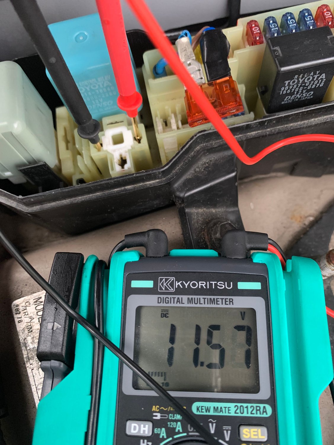

Today when i started the car it got keept cranking itself again, so i restes this
remove starter fuse, it keept cranking
Put the gear in Drive, it keep cranking
remove starter relay, it stopped cranking
so the problem lies somewhere between the park/neutral switch and starter relay.
i also measures volt in the starter relay Connection, and it has constant ~12v in pin 1 and 2. If im thinking right it should only have 12v there when i Turn the key to start?
And when i disconnect the negative from the battery and measure amp between ground cable and negative terminal on battery it draws 0.5A. is that normal?

Terminal 1 of the starter relay should only be 12v when the key is turned.
Amperage draw between the battery terminal and the connector should be 0, unless there is something on, like a cabin light. otherwise, there is a short. you can check where the draw is coming from by removing suspect fuses. If the draw goes away when you pull a fuse, you have your shorted circuit. The previously posted procedure from the manual can narrow down where in that circuit the short is.

I'd try a test light or your meter in amperage mode hooked up to the starter fuse in the left hand kick panel, then like the section of the manual describes, check the conditions that cause the light to come on or the meter to show amperage. Keep in mind that if this circuit draws too much current, it could damage a meter.
I'm not sure why your main fuse would blow, but it seems like there is a short in the section after the park/neutral position switch.
Maybe disconnect IA2, and see if there is 12v on terminal 1 of the starter relay. If there is, the short is after the junction connector.
you could also try to disconnect EA3 and see if there is 12v at the fuse, that would eliminate the ignition switch, fuse and park/neutral position switch as the source. EA3 is located in the ECM box, so be very careful of static discharge if you open that box.
