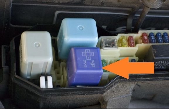

Nope. My bad, someone mentioned the locking clip to release the relay
https://www.clublexus.com/forums/att...ay-removal.jpg

The darn plastic cover came off...ouch.
Sorry about that. Put this plastic cover back on when you remove the relay.
https://www.clublexus.com/forums/gs-...ml#post6207397

Originally Posted by DundukovEM
Got it out and tried it again and the starter is still running. It's the starter?
Old Nov 8, 2023 | 07:34 PM
  #41
DundukovEM's Avatar
DundukovEM
Joined: Apr 2018
Posts: 481
Likes: 118
Yes, this is a bad starter. Please create a new thread about your experience with replacing the starter.
