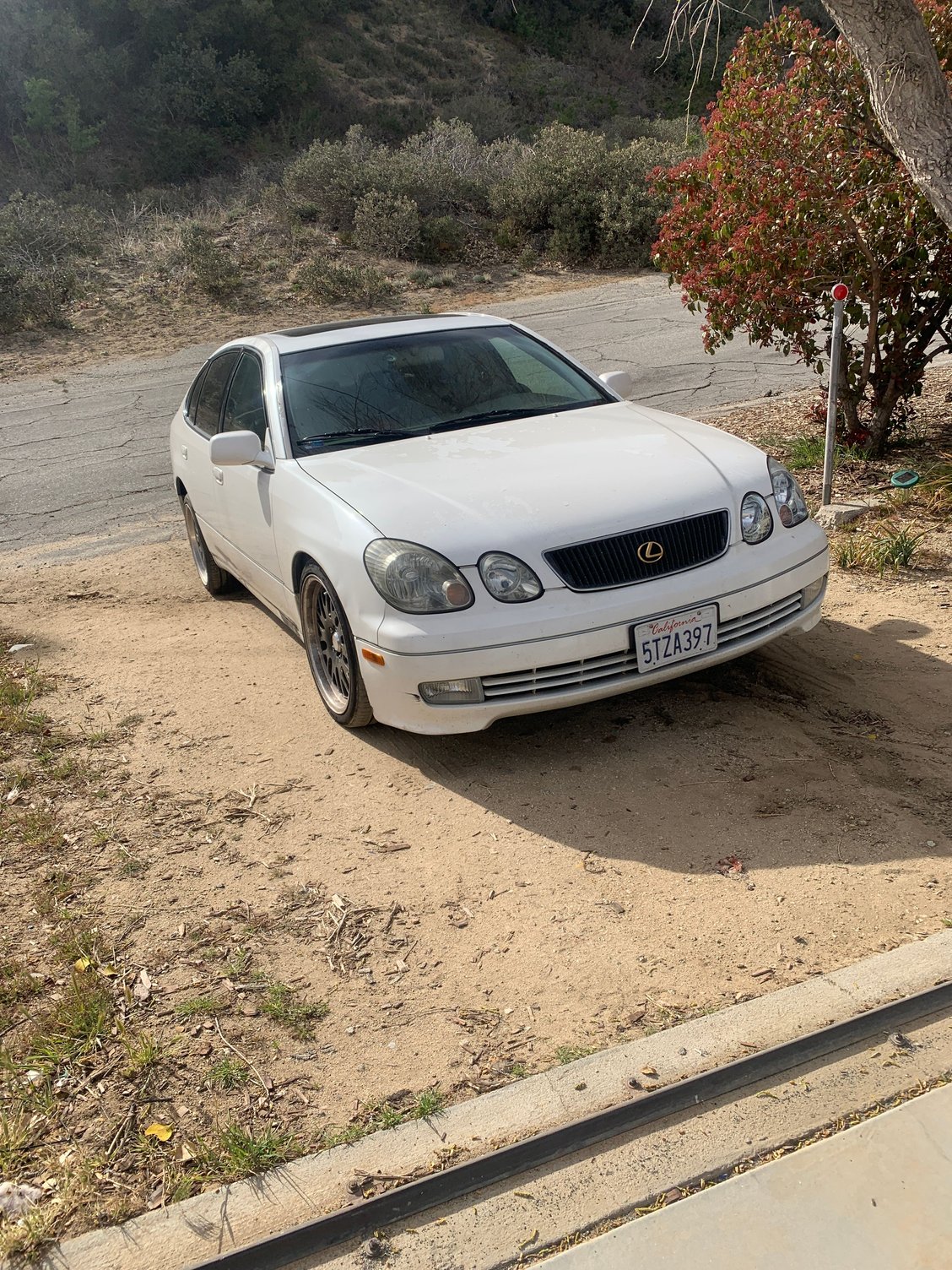

Hello everybody! I bought my 2GS in 2019 with 170k miles, it just hit 200k! it served me very well up until a few months ago, I have put in a new water pump, timing belt, radiator, radiator cap, reservoir bottle/shroud, thermostat and hoses, the car seemed fine for about 6 months and a few weeks ago it began to over heat, I let the car bleed for roughly 40 minutes letting out the air bubbles and refilling but I noticed that there began to be rapid bubbling in the radiator, is this a symptom of a bad head gasket? Any information or advice is much appreciated!
When I bought it
30k miles later
