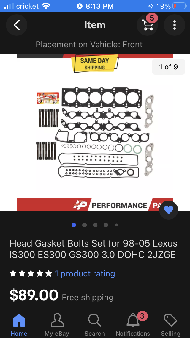

I have a 99 Lexus GS 300 and I need y’all help I have an head gasket problem. I change the radiator, the fan, and the thermostat that are just the basic of the overheating problem so my question is should I buy this parts to fix the head gasket?
