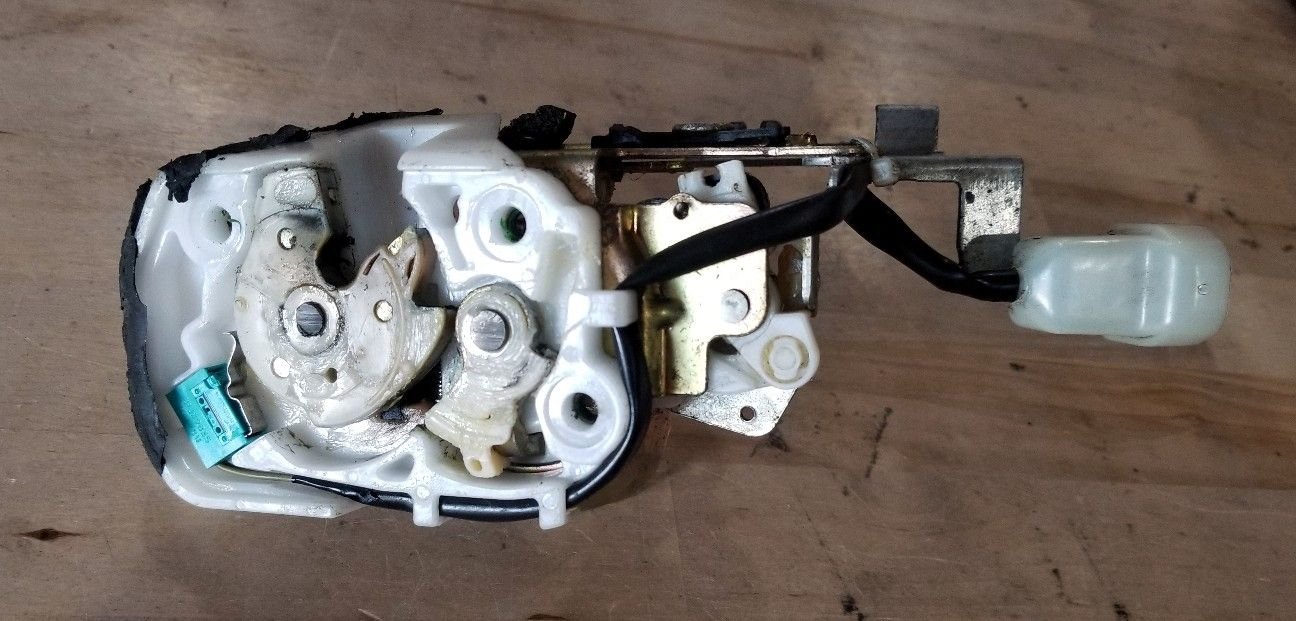

I don't think I ever changed my passenger side actuator, I changed my driver side since it was going out when I bought the car.
This door ajar problem started randomly, it had been sitting in storage for the winter previously. I bought the used door latch assembly, then replaced that actuator, with the old one that was in my passenger side door, since it was working fine, and the replacement one looked really janky.

Pretty sure there are sensors inside of the actuator. Wouldn’t doubt you still have an actuator issue even though they lock and unlock

AFAIK the red circle is the sensor for the door, and the yellow circle is just the lock actuator which I brought over from the old one. Even when I had the "new" actuator in there the door open light was still on. Had no idea the lock actuator had anything to do with the door sensor.

As ph0bolus explained the door ajar sensor is built into the latch and is the small grey 2-pin connector.
This sensor can sometime fail and short closed (indicating an Open door).
Unplug the 2-pin connector. This will make the vehicle think the door is closed all the time. If you continue to get the "Please Close Door" message on your display you will know the problem is not with your latch, it is further up in your electrical system (BCM, ECU, wire harness....).
If the problem does stop then get yourself a new latch.

Sorry I misspoke, unplugging the connector is equivalent to a door open. Grab a small wire jumper or a paper clip and connect the 2 wires. This is a "Closed Door" signal.

So, I was able to get into it again today. I plugged both sockets with a speaker wire, and the door open light was still on.
I then tried to simulate the door closed, by pushing the little door latch in the door panel down, and stuck a screw driver in there to emulate the metal door latch, and still the door light was on.
Finally, I disconnected the power from the sensor to the door ecu
And the light finally turned off, BUT the doors won't lock/unlock when using the door controls,
and the passenger side window won't go down. Not sure what else won't work with that wire disconnected.
