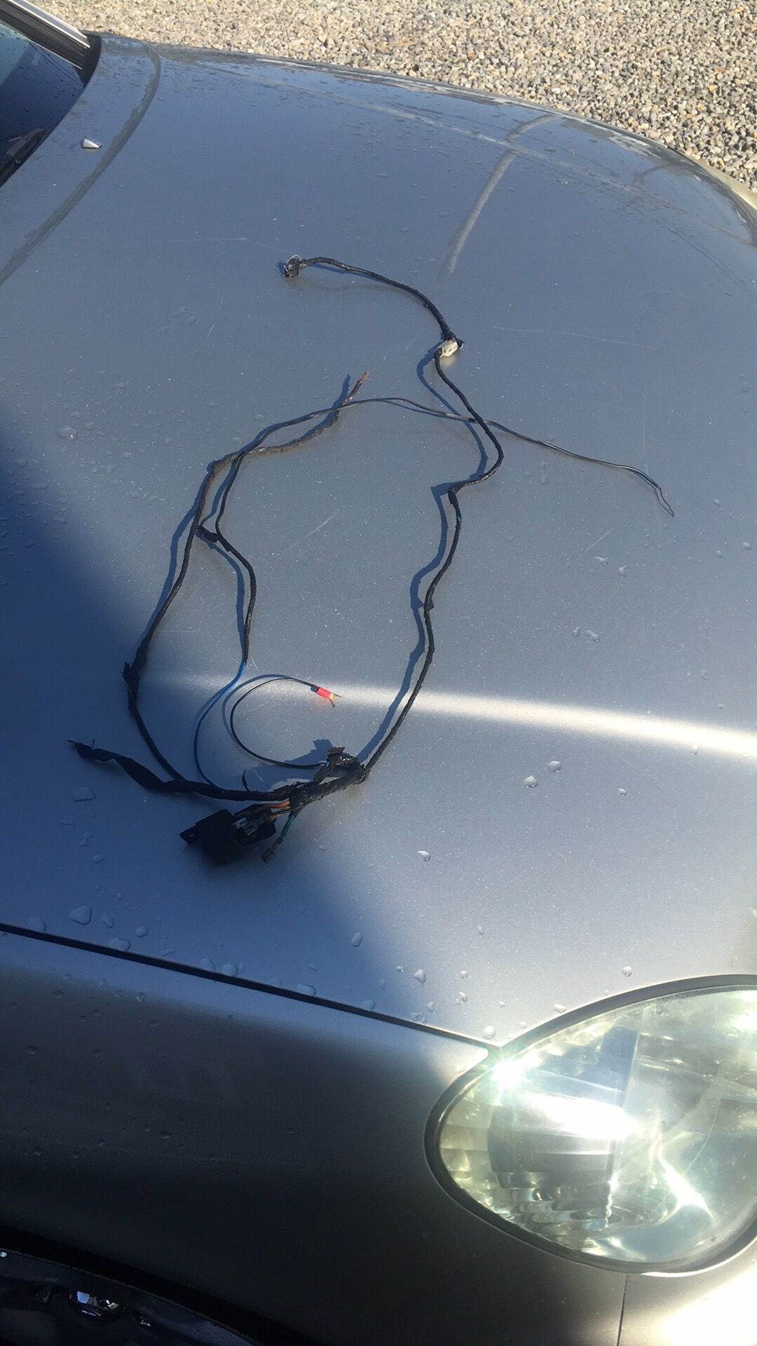

Old Mar 29, 2018 | 04:28 PM
Kain52's Avatar
Kain52
Joined: Feb 2018
Posts: 11
From: New Jersey
Similar to mine road issue half a year ago.
While driving car started shutting down on road bumps. Most of the time for a half a second, so the engine was still running, but sometimes for a couple seconds, so I had to move off the road, put the car on "P" and then start it again. Same lights were on. Back then I just bought it from used dealer.
Next day, I checked the engine and in my case the issue was wires from after-market equipment removed by the previous owner. Maybe alarm, maybe custom horns, which was most likely the thing. So one of the wires was connected to the Positive terminal of the battery and after going in the front somewhere underneath in the front. I just pulled that crap out, there were couple relays rusted wires and it wasn't connected to anything besides my battery. So on the bumps those wires were hitting the body of the car basically shortcutting itself knowing that its plugged to the "+". Got it out - drove 30k miles after - no issues.
So seems like its a shortcut. My guess would be to start with Checking the terminals on the battery. How tight, condition... Good luck
