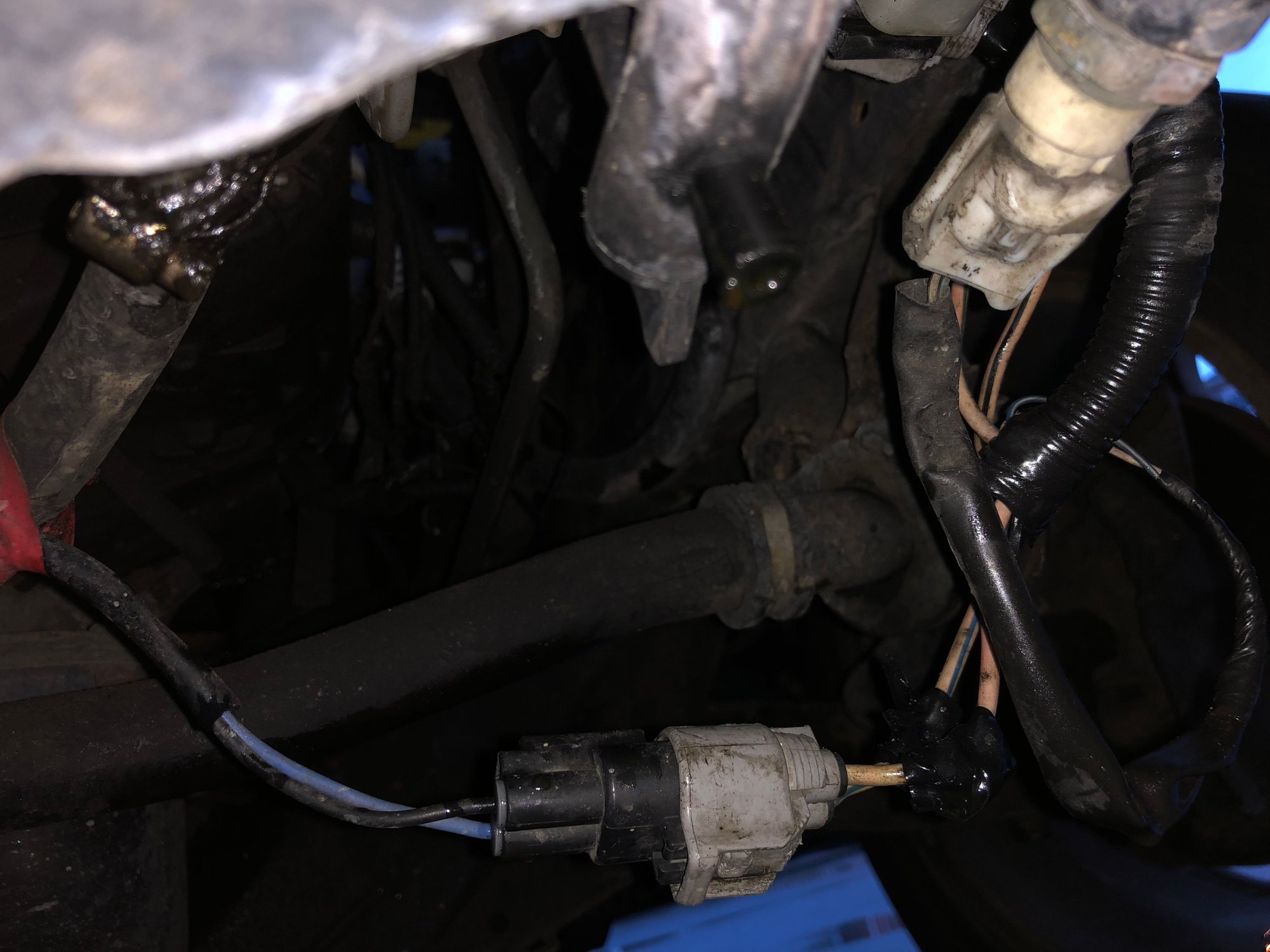

I just picked up my first Lexus ever! Ive owned it for about 2 weeks now 102,000 miles and it has been great but def needs some TLC. Anyway since I got the car I have been having these overheating issues. Reservoir would boil and steam. I wasn’t sure what it was until I seen this harness under the radiator (white/blue and white) completely broken. So I said to myself well that’s gotta be it. I put the wires together electrical taped it and put the negative back on started up the car and the passenger side fan would constantly run as soon as I turn the car on. I then changed the number 2 relay in the engine bay with a new one (it was missing the top part of it I guess previous owner tried to pull it out and it came out) so I just replaced the entire thing. The fan wouldn’t turn on anymore as soon as I started the car. Drove the car a little while and BAM started overheating again with the same issue. Boiling/steaming reservoir. I searched up some stuff and turned the AC on and just the passenger side fan would run in a timely manner I guess that normal. So now I came to the conclusion that when my car starts overheating the fans isnt kicking on (ac fan doesn’t with ac on or off) and the only way to keep it cool I would slap the ac on and the temp would drop back down. Any help on why my radiator fans aren't turning on, only when the AC is on?

yeah im not sure it was a young kid that couldn’t keep up with it so I bought it from him for $500.00. I just checked the wiring and I see here that the power to that left fan is cut on the grey connector part. So that’s what it is I’m not getting power for that fan to turn on then. BUTTT that doesn’t help still the fans only operate when the AC is on. I’m thinking over the weekend then I’ll buy those other two relays and do a coolant flush then. Stupid coolant I see here is green -_-

I replaced the radiator harness and now both fans are working but still only when AC is ON. I tested all relays they are good but they are all getting power. What could this be ???? Also coolant temp sensor is tested good as well
