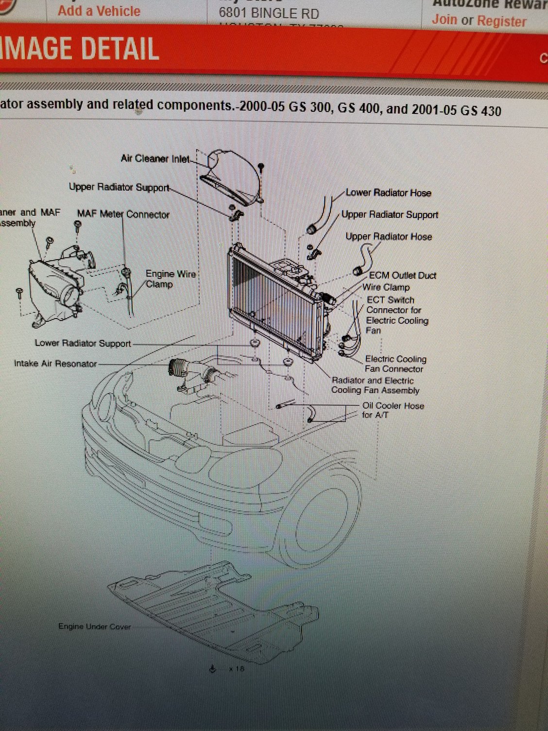

the fan switch isn’t located here on the bottom of the radiator where the drain plug is ? Where is the AC pressure switch located at ?

Try looking up on the fan shroud. It's there if not possible you have a different model radiator? The AC pressure switch should be on the high pressure line? Follow the AC lines.
Here's the diagram. For some reason it's labeled as ECT switch too.
I forgot the GS400 has the sender for the temp gauge on the cluster. Its located near the thermostat by the left valve cover. So the GS3 should still have both. Seeing the diagram again. This one is signal for the ECU.
okay yah that switch I know I actually disconnected and both fans stood on. And I have a 2000 GS300!
Yeah I got it backwards the sender on the water pipe is for the ECU, and it has the fan switch on the radiator.
