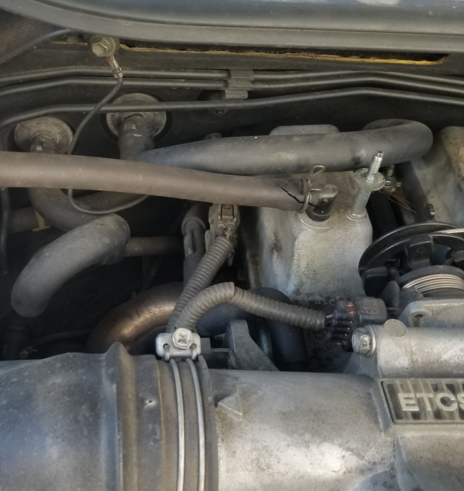

I decided to go from easier/least costly to more costly. I was going to clean the MAFS and when I checked it, it was very clean. Next I wanted to check the throttle body and flap to clean as necessary and they also looked very good. in the process of disconnecting vacuum lines I found one was cracked . I replaced the hose and am going to drive it awhile. Also, I never got any codes, just the 2 "limp mode" occurances.
