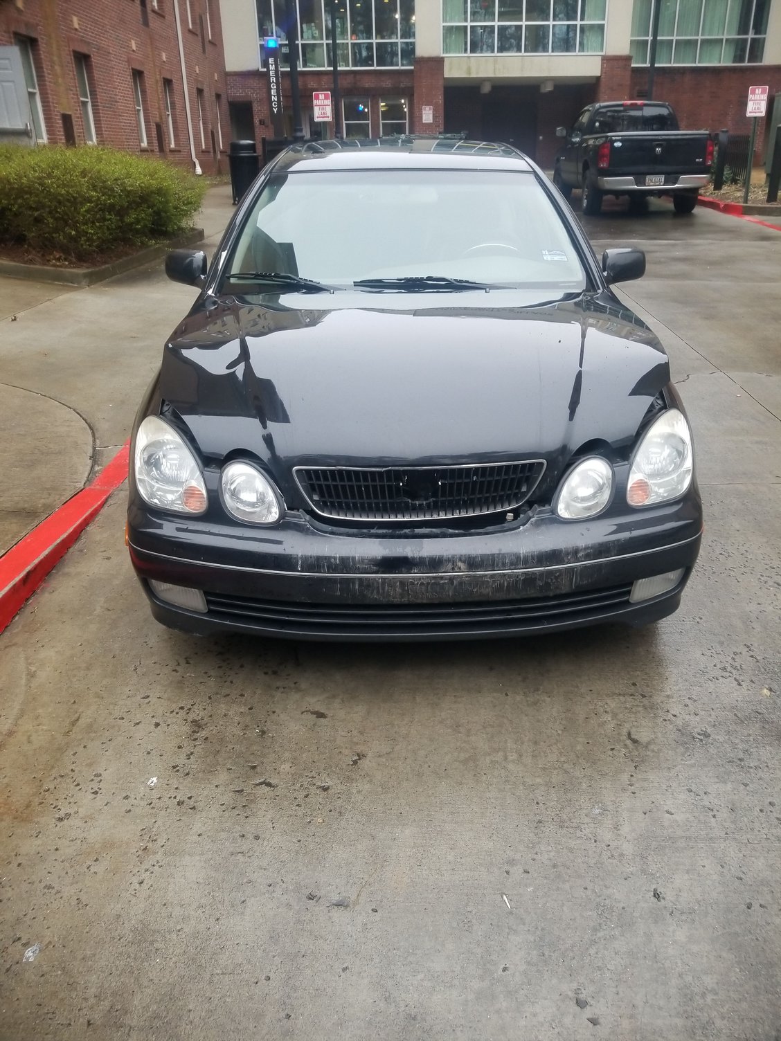

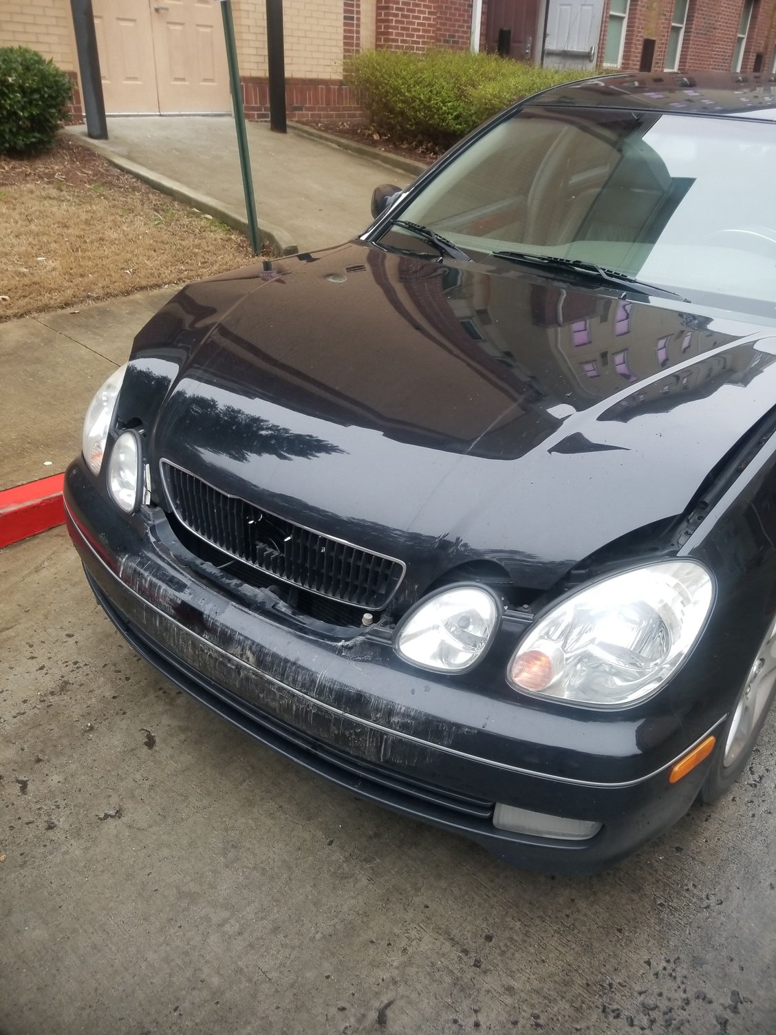

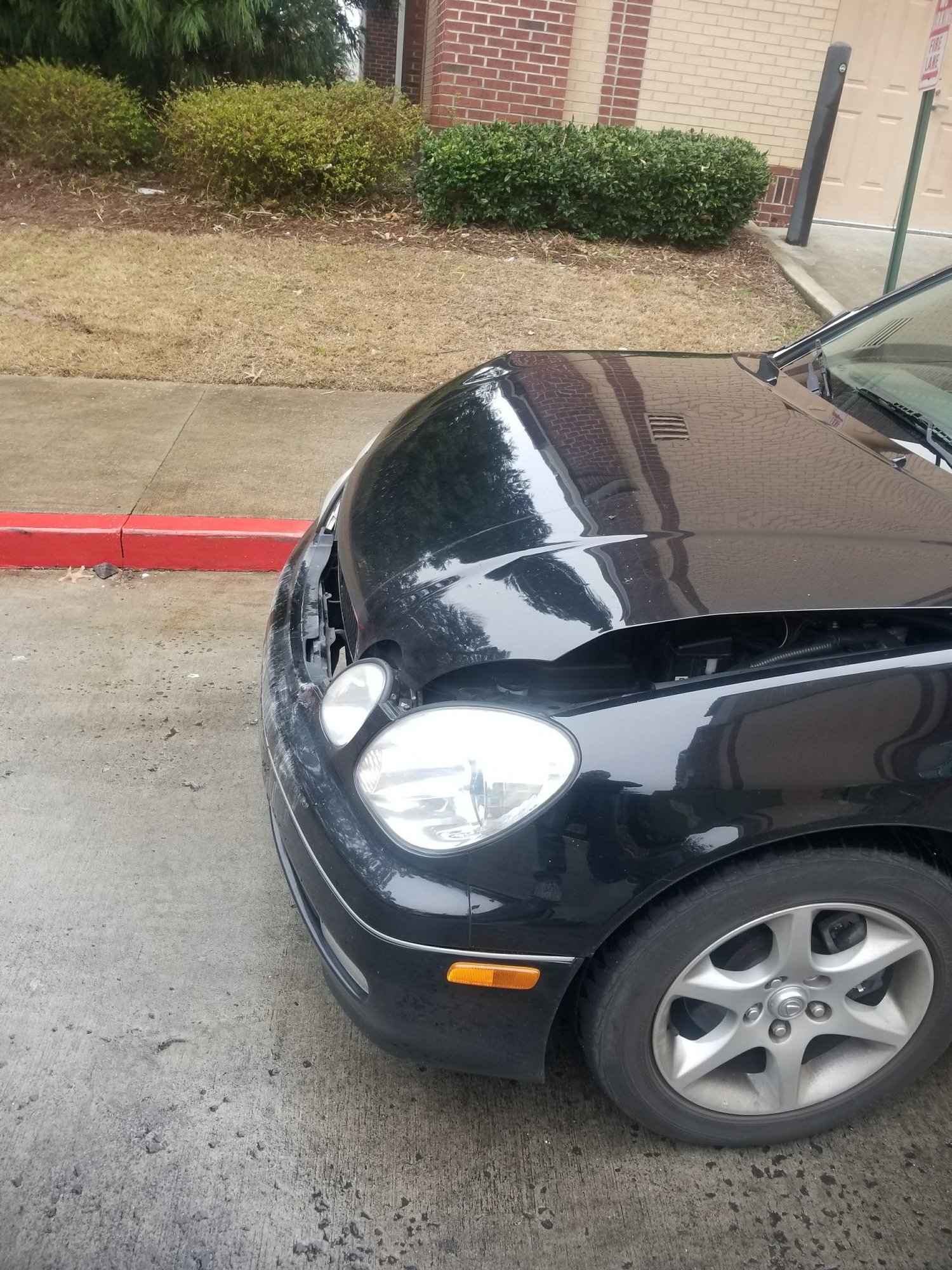

So there will be a little delay on the progress report. A day after putting in the new sensors, my son had a fender bender. He hit a car in front of him at about 20 mph. With the car being 18yrs old and having 201k miles, there was a serious question whether the insurance would fix it or total it. If they were going to total it, I would have dropped the claim and fixed it myself. Luckily the repair shop understood my strong desire to keep the estimate below the "totaled" threshold and they called today and said we are good to go. Mainly hood, T-frame in front, radiator, 1 smaller headlight, and horn need replaced. Surprisingly, the front bumper was mildly scratched and the hood and grill took the brunt of the damage.
