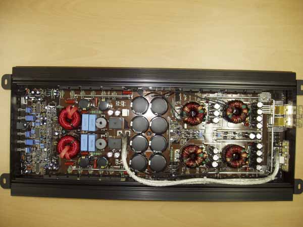

I guarantee the JL will blow it away. Have you see the bank of caps in that thing?
That thing powers itself. I was running 2 of those and another 1000watt JL 4-channel.
I have a friend with a repair shop and he hooked up one of those so called "4000watt" amps and when you watch how it sucks power, its UNBELIEVABLE! He hooked up the JL and the meter barley moved a mm (no joke) The cheaper amps are busy looking for juice to push power that it cant blow it out, good amp stays nicely charged on the inside to provide what it needs.
The science behind why you're dimming is because the amp is discharging the battery faster than the alt is putting out. If you fully charge the battery and play it [with car on], you will get no dim at all and it will slam! Give it a few minutes as the amp slowly discharges the battery, dimming will begin because the battery is completely drained and the amp is now basically running straight from the alternator and taking away from what the car needs. This is why smaller amps can push louder than some bigger ones because they come with a bank of caps to give what they need to run at 100%. Its like stacking boost in a car. You can give the engine 20 lbs of boost, but if it cant take it all, its not gonna use it all. Now give the engine 5lbs of boost and it will be MUCH faster and stronger than that of a 20lbs boost because the engine can handle 5lb much more efficient than the 20lbs.
Now if you give that Sundown EVERYthing it needs, then yea it will blow out lots of amps, but once you pay for all it needs, you could have bought the one good amp
