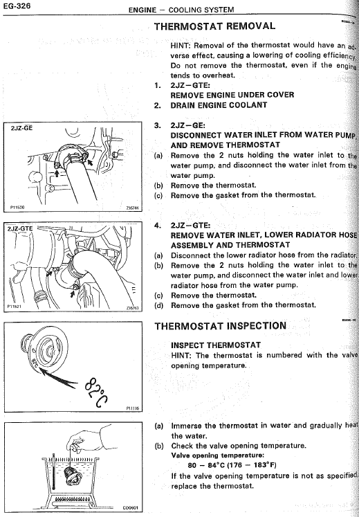

Here you go. This should help visualize it.
EDIT: 2JZ-GE

Originally Posted by GS4_Fiend
To check the thermostat is working, let the car warm up to normal operating temperature and check both the upper and lower radiator hose. They both should be warm to touch. If one is cold and one is hot, thermostat is stuck. From my point of view, you should do a coolant pressure test see if its leaking else where. Check radiator cap to see if it holds pressure. And if it happens to overheat mostly when sitting at a stop light or at idle for a long time, it's time to change the radiator. GL!
Might be easier this way.

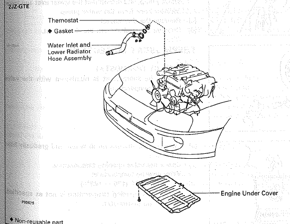

I don’t have the N/A engine any more I have and actually TT engine so the thermostat is located somewhere else. is next's to the turbos.
Old Feb 10, 2009 | 01:35 PM
Debonair's Avatar
Debonair
Joined: May 2007
Posts: 3,405
Likes: 55
From: 408 NOR CAL
2JZ-GTE
