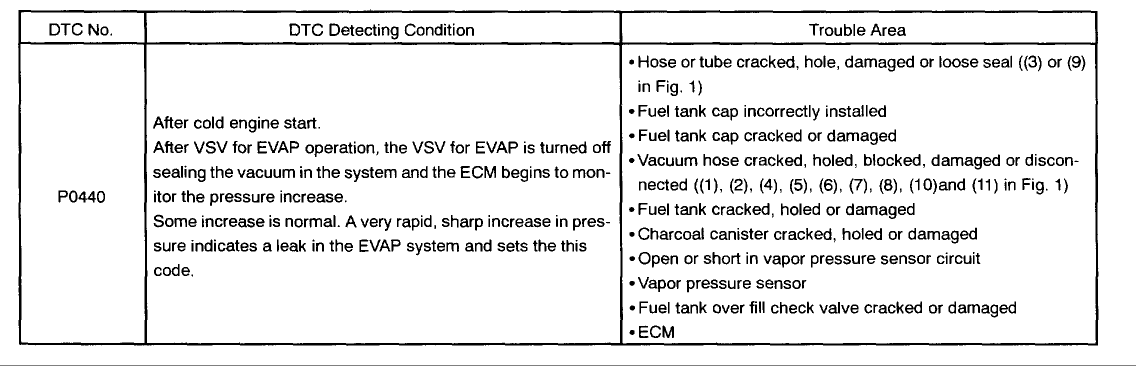

After I cleaned my Throttle body, my car runs great. 3 weeks later the check engine light went on. The codes show 440 and 446= EVAC. What is EVAC?
I ran BG 44K and it didn't solve the problem. But the car runs great.
The guy at the shop told me it'll cost me a fortune to fix, and if I don't, I wont pass the emissions inspection.
I am thinking about selling the car ASAP before my inspection expires.
Anyone know of these codes 440 and 446? Anyone know anything about EVAC?
HELP! THANK YOU!
--GS 430, 2001. 106K.

These will get you started....

Thank You. all these possible troubled areas sound overwhelming. Anyone else.... any comments?
Start with making sure your gas cap is on tight. If it is you might want to replace it. Once you have done this have the codes cleared. These are the two most common and the easiest repairs for these codes.
