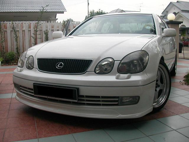

Audio28,
It is not advisable to use double sided tape.
Thanks to the advice from the CL members;
Try using a polyurethane adhesive to bond the lip and the bumper together. Remember to use strong masking tapes to hold them (Bumper Vs Lip) together during the first 6 hours after application and make sure to cover any "gaps". I did not use the molding approach and i am quite satisfied with my accomplishment!
Cheers!
