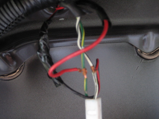

I've looked at BananaGS' website but it's still not helping me. I bought the car used with the spoiler but it's never worked so I figured I'd check into it today. Tell me whats wrong with this picture. Both red/black wires come from the spoiler. No idea where yellow/green and white/black come from. That plug isn't connected to anything. It just hangs there

What's the problem? The lights dont turn on?

haha yeah it might have helped if i said that. the spoiler light doesnt work and I'd like to get it working and disconnect the third brake light. i just dont understand whats wrong with my connection
Connection Pic
Post the link to Banana's write-up.

http://lexusmodz.netfirms.com/GS_DIY/spoiler
In figure 10 he shows two plugs.. I only have the one that holds the yellow/green white/black wires. And what is that red plastic thing around the white/black and yellow/green wires?
The plug I have doesn't come from the spoiler. I have my Red connected to the yellow/green and my red/black connected to the white/black. Just like it says
Do you think maybe the led bar needs to be replaced? The previous owner is no help because... he can't remember if it ever worked or not
I would start by getting a light tester or a voltmeter to test and see which of the wires are hot. Then I would go from there to see if you are connecting the right wires.
The picture is too small to see what the red thing is. Look like some type of connector.

mabe its an aftermarket spoiler? and not OEM so the LED bar wires are red n blk
aslong as u hook those wires to any brake light it will go off if it works
Just wire the spoiler's wire in parallel and you should be good. The lights on the spoilers (if OEM) are LED so they aren't taking a lot of current. No need for relays here.
