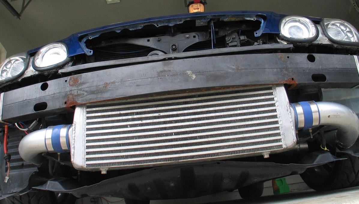

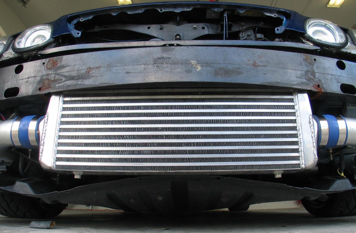

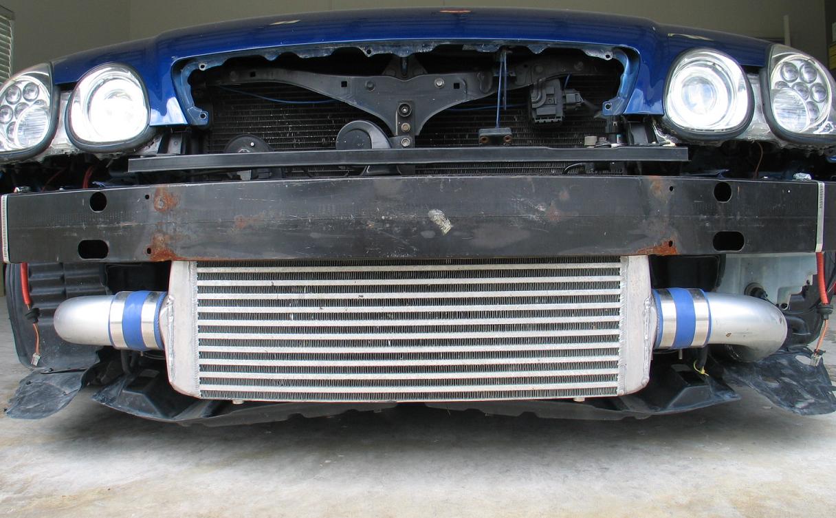

Well I thought my intercooler was polished but only the sides were. The bars inbetween the fins were just metal. So I decided what the heck I'd try to polish them out for a cleaner shiny look. I started by using 600 grit and water to sand down the grit and nasty stuff that sticks on (this is what happens when you don't protect your intercooler with mesh and show it off ). Than I used a 1000 grit as step 2 and follwed with 1500 grit as my 3rd step, I couldn't find 2000 grit at either home depot, advanced auto or pepboys so I just used 1500 grit. I finished by using Mothers power metal with the Powerball mini which I found at Pepboys. All in all in came really nice, not professional or pefect by any means but much nicer than it looked before with a little more shine than before aswell. Took me a couple hours.
Before.
After..(If you look at the last bar up you'll se a close up of what it looked like before, I didn't do this one cuz the opening in my bumper wouldn't show it anyway.)
