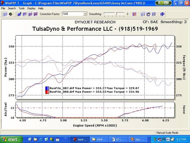

Just as an FYI in case you were unaware, the settings you put in place for partial throttle are not used at WOT, there is a nother set of setting for high throttle.
I have mine set as low throttle settings are used under 30% throttle and high settings are over 85% or something close to that anyway.

And LMS may have something there, assuming that he did everything right with the SAFC I would check the fuel pump fuel filter and pressure regulator before shelling out 700 bucks for injectors

Afc2 is -50/+50%. Fuel filter check is a good idea. aftermarket fuel pressure regulators are cheap as well, I reccomend aeromotive.
Just add the bigger injectors its cheap and easy. Then were it is at 50% would end up say 30% instead leaving you more headroom.

If he pulled %19 fuel from the middle looks like he needs to pull more. Maybe -25 to -40 from 4500rpm to 5700rpm

Guys,
Thank you everyone for your input. I will try and answer as many questions as I can.
Hollywood - I live in Tulsa, Oklahoma - which as you may or may not know - is not heavily populated with tuners. This is the only dyno in 200 miles. This guy tuned 1000hp Supra's so I would not call him a "ghetto tuner."
I am not fully versed on this subject so I will tell you what my dyno guy told me. He said the reason why the middle rpm's are showing how they are has something to do with the timing changes and not knowing how it is changing timing. He said you should be changing timing by 1 degrees for every pound of boost - but I am running stock timing and he is unable to change that - something to that affect.
The SAFC only allows you to go to 20% - the SAFC2 is 50%.
He put the settings the way they are to be safe until I can get more fuel in there. I rarely drive the car these days so I am not putting any miles on it the way it is tuned.
Could someone please tell me about the FPR - where to get it, install etc???

If the low 10's area is the ecu retarding timing then you are knocking. Are you running 94 octane? Is your cooling system up to par?
Jonny, no offense but your AFR should not look like that, no matter whether your tuner has tuned 1000hp supra or not. My guess is that he can't change timing because of the vvti feature that's in our cars that will self-correct whatever modification that's piggybacked to it. I've already talked a bit about this in the past, and that's the main reason why NO piggyback unit will ever work to optimum in our cars. Not SAFC, not e-manage, not unichip. Only standalone (and all of its PITA problems) will be able to fully replace the function of your stock ECU and make it right.
Don't ever drive your car hard with a setting like that. I can guarantee it will be very detrimental for your engine.

Now back on track.. if he is running you +50% thru the high end, he is most likely maxing out the injectors and they are going static..full open and just dumping. In fact it looks almost that way the whole way thru the graph. do you have a bigger fuel pump?
SAFCs work by modifying the MAF signal to make the ecu give the injectors more fuel (fool it into thinking there is more air volume). Keep in mind that at the same time the ecu will be retarding timing based on that figure. I think the timing is fine, but the fuel mapping stinks.
keep us posted.
the middle range richness was mapped at -19% fuel. The upper end starting around 5800 rpm was mapped for additional fuel up to 50% and there was no change in AF so yes the injectors are maxed out and we are thinking the stock fpr is not handling the walbro 255. The next step is to diagnose what is causing the excess fuel and correct it. The spark plugs I believe are the two step colder plugs and i'm not sure what he had them gapped at...my guess is that the ecu is wandering on the timing because of the excessive fuel.

Originally Posted by Epik
i just had a thought looking at the graph again and how jumpy it was... did you install new spark plugs? what is the gap on them?
Epik - you should get into our conversations we have about this on AIM - sockfocks, morris and I have been talking. PM me your AIM name.
Hopefully Joe (sockfocks) and I can get the FPR installed and running to hopefully circumvent this excess fuel problem.

Originally Posted by Dx3
They are brans new NGK plugs that are 1 step colder I believe. The box said not to gap them so I didn't.

Jonny, I followed the link you posted over in your thread about fuel pressure regulators, I don't know that it is going to help. The problem it looks like you are having is VOLUME related, not PRESSURE related.
My own take on the dyno echos what many others have said - you have too much fuel in the middle and not enough (not by far, but just a little lean) at the top... but a little too inconsistent for my taste. As others have stated, you want that AFR line as steady as possible. That is exactly what the SAFC2 unit is for, to map to a straight line. That's the angle I would persue first.
Luckily FPR are generally pretty inexpensive so you can give it a shot without a big investment. If you still want to go down this path before you spend the money I'd ask your tuner to first put a pressure guage onto your fuel line and keep an eye on it during the dyno run.
