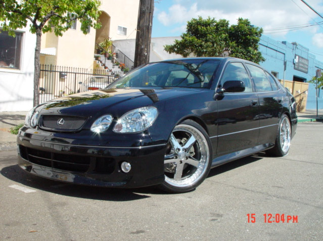

pics of the car w/ the rims on with stock supsension

Also the car actually looks pretty decent already w/o the drop. only 3 finger gap front and back. I assume that the L-tune setup will drop it exactly to the tires.
Oh no, from the pic, you NEED that drop.
The L-Tuned will not drop it that low (to the tires) but it will look pretty good. It depends somewhat on the offset, but the 255 will be a potential rubbing problem. You will need to roll the fenders and push in the fender well liners. I think there is a thread somewhere about this. if you are already rubbing now, you will continue to get some rubbing even with the fender mods. Remember, with the 245/35 tires, the outside diameter is already an inch bigger than OEM. With 255s, you are bigger still. The fact that it is wider, it will rub once the wheel goes left and right. One of the drawbacks of 20s most of us have to deal with.
I know there have been some reports of members not rubbing but it may be some combination of offet, drop, tire size, and tire type (tires from different manufacturers have different shapes). Since everyone's setup is just different enough, it is hard to say what the magic combo is. There is also the very small minority that does not even realize that they are rubbing if it is minimal enough. I do know of real life cases of this. No one on here though.

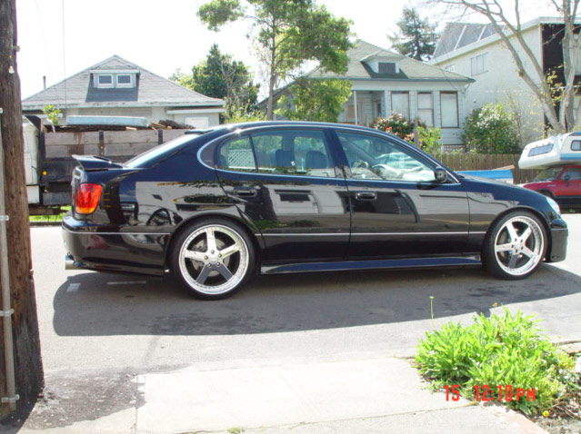

To get an idea of the drop, here is gsintensive's car. He is running L-Tuned with 20s:

thanks neo for the pics, they are nice
and yes, drop for sure, otherwise it's just nothing but weirdness and out of ratio look
