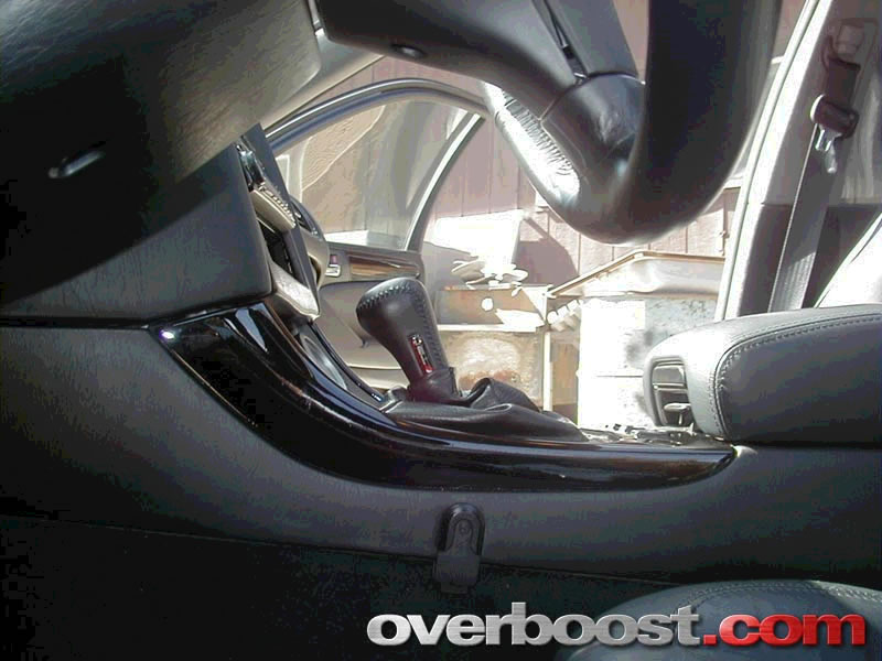

Surfing overboost.com this morning and came upon a black gs400 with this: TRD shift *** and a shift boot:
Anyone ever try this? I think it looks much better than our current bezel. I might try it as a project.....

I believe that's Martin Kraft's right? I think a couple have people have done it with an NSX shift boot and bezel.

Yeah Dave, now that I look back at Overboost, I see it is Martin Craft's GS. Where can I find a shift boot to match my stock shift ***? I kinda want to do this
