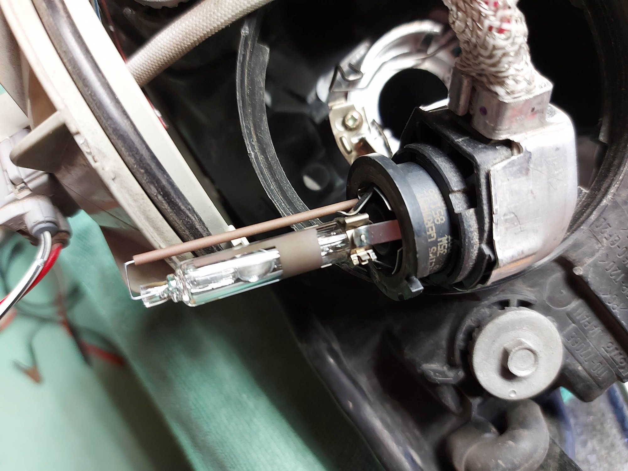

You have the optional HID style head lights not halogen. Yes getting the bulb in and clamped down is not easy see below for details on how the clamping mechanism works. As for cloudy headlights you have three options 1) restore yours 2) find good used or 3) aftermarket new (I don't recommend this).
Different car but you get the idea, socket is the same.

I'll reply to this just because these bulbs are not easy. I'm on my 3rd set now. Drivers side is much harder due to less room there. Basically, after you get the plastic cover (which twists) and metal cover off, the power connector can be twisted off (twist lock style). Then you release the two metal wire prongs and the bulb just pulls out, actually almost falls out. Reverse the procedure to install - those prongs are what hold the bulb in place so you can then twist the power connector on. In my frustration the 1st time I did this, I actually bent one of the wires on the drivers side so even more fun for me. The metal cap on the drivers side doesn't stay on for me anymore, so last time I just left it off. I get 6-7 years out of each set of bulbs that I buy on amazon for a fraction of the cost of OEM. As you know when they work, they are very nice - auto leveling.
