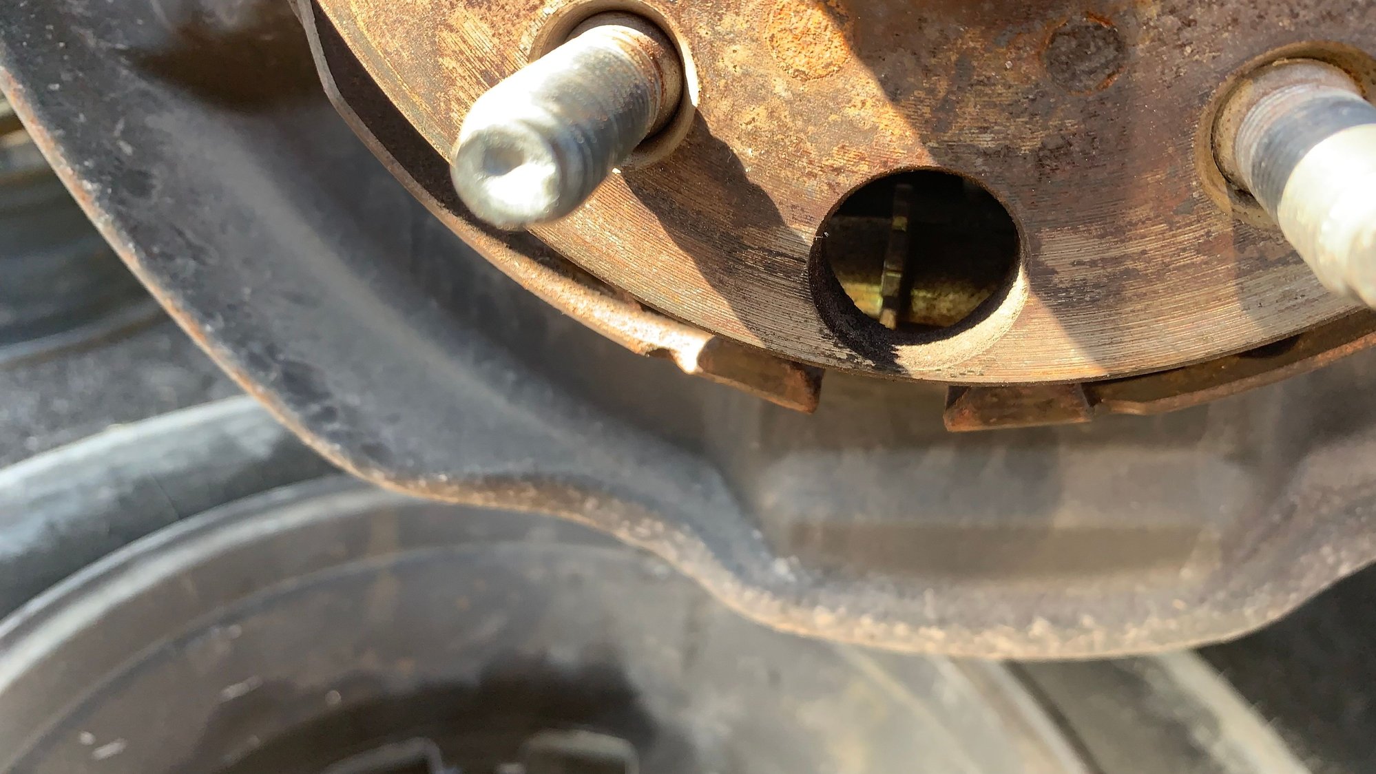

So I recently just got a 2002 gs300, I was doing the brakes when I realized on one of the rear brakes the parking brake is holding the rotor on. I know to adjust it with a flathead from the hole in the rotor and etc however, the last person decided to not line up the hole where the gear is, any ideas on how to loosen the parking brake to remove the rotor?

Hmm, what's going on with that lower circle? It should be an open hole so you can hit the adjuster and normally there should be a rubber plug in it to keep water out.

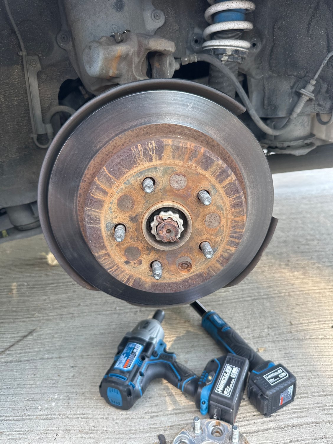

Sorry, I was thinking about standard drum brakes, it’s the rubber plug in between the wheel studs. In your picture you can see it, it’s got a slot to use a flat head screw driver to remove the plug and then spin the rotor until the hole is in around the 6 o’clock position, spin the rotor til u see the adjuster.

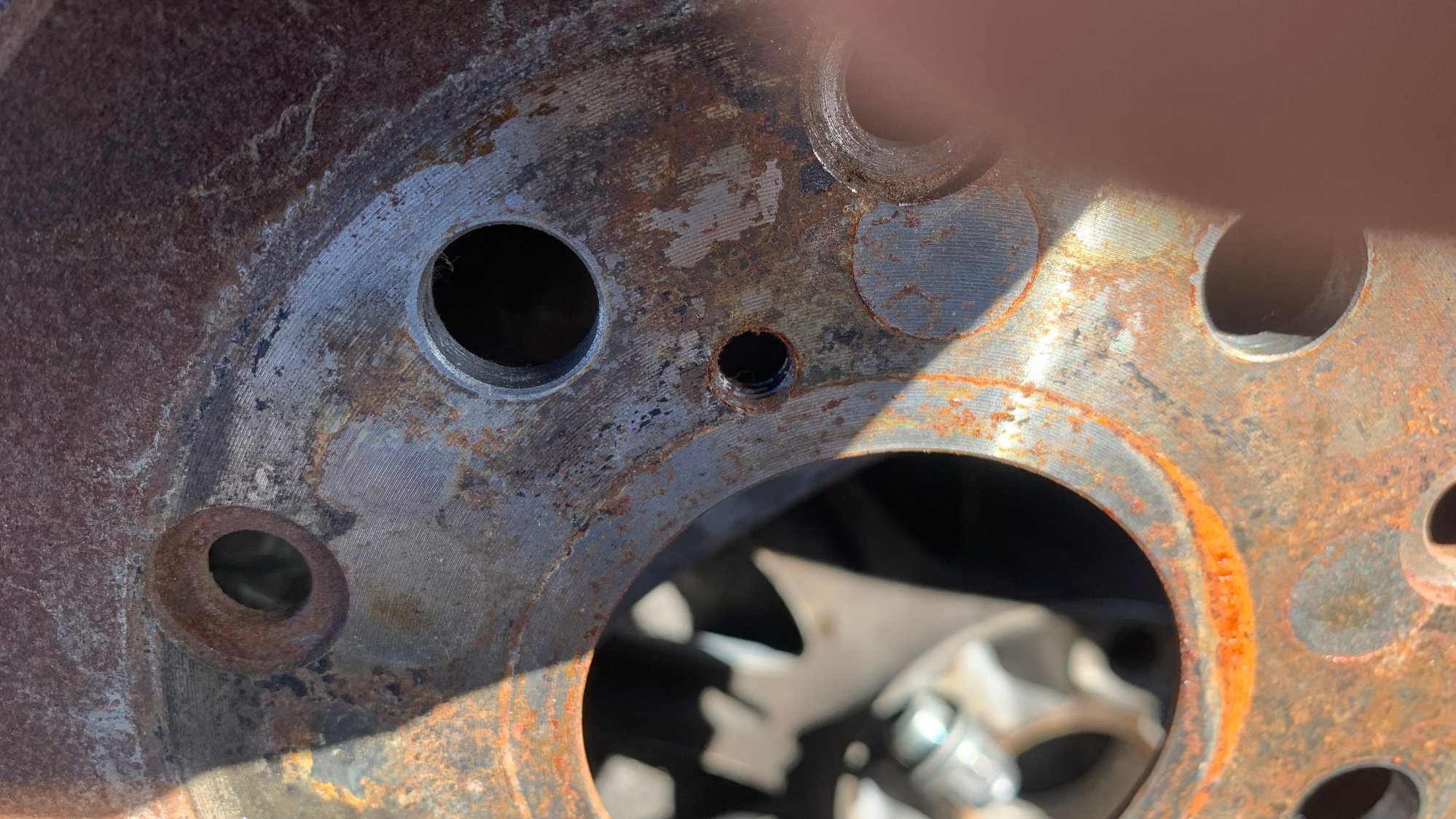

I pulled mine just to make sure I wasn’t going crazy, you can also use a couple bolts to force the rotor off. I think they are M7 and just screw them into the threaded holes on inside the wheel studs.

I think you guys are missing his point. The access hole on the rotor must be lined up with the access hole on the hub when installed. But the last person to do the job didn't know this and put it on so there is no access to the adjuster wheel. So unless there is a window in the back, he may have to force it off and replace the shoes/hardware, then install the rotor in the proper orientation for future maintenance.

Toyota/Lexus engineers wouldn’t make that kind of mistake, there is an access port between every wheel stud, and with the trans in neutral and the parking brake off, you can spin the axle until it’s in the proper position. However, if that is really the case, then a couple of M7 bolts installed in the little holes inside the wheel studs. And they will gently separate the rotor from the hub. The rotor will be able just slide off the brake shoes.

As you can see in his picture, it is an aftermarket rotor that has no holes for bolts, and only one access window that was not installed over the access window on the hub. He's screwed, big hammer time.
