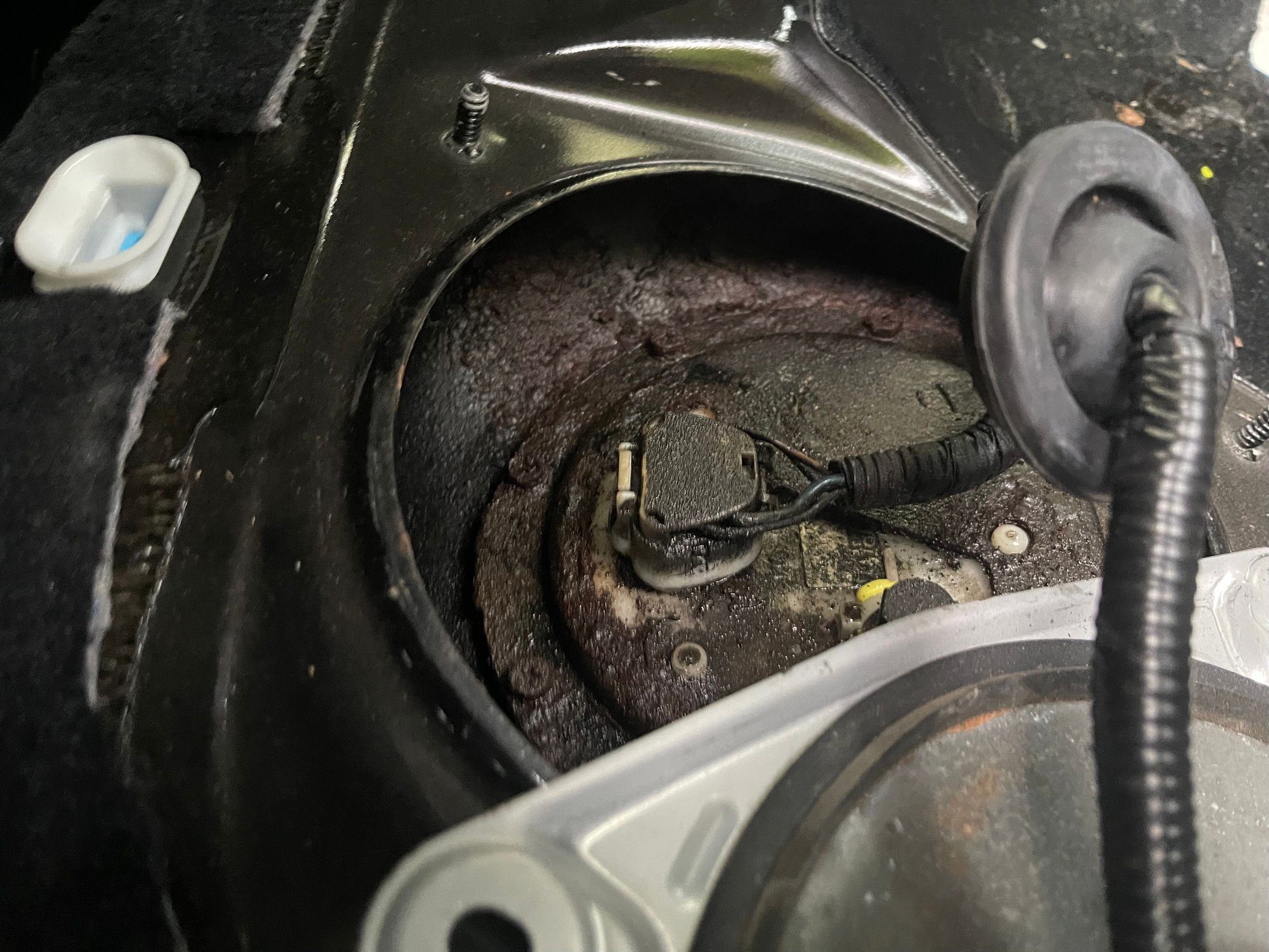

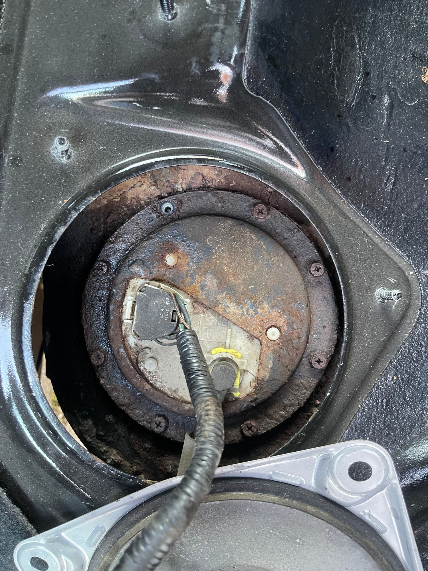

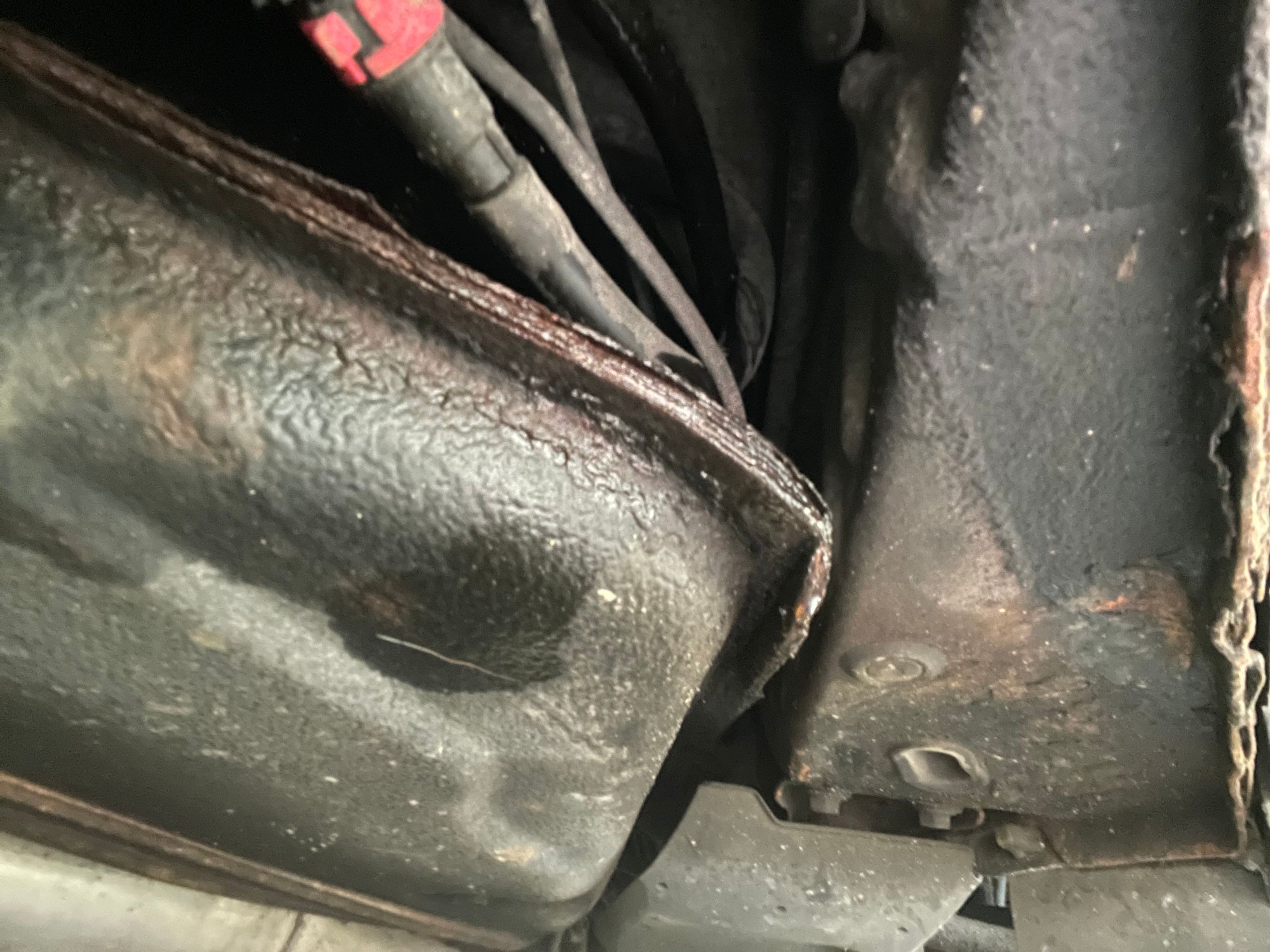

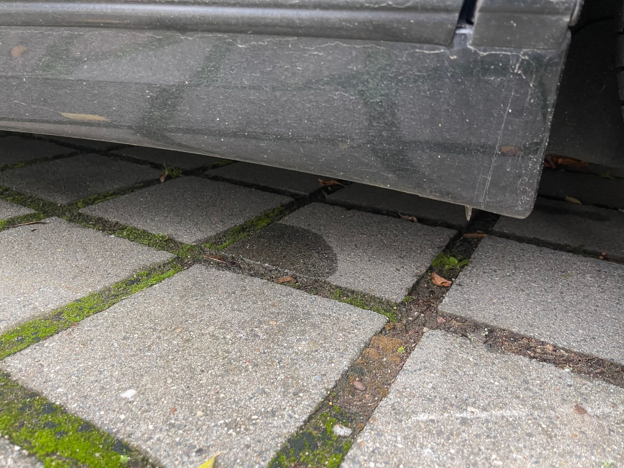

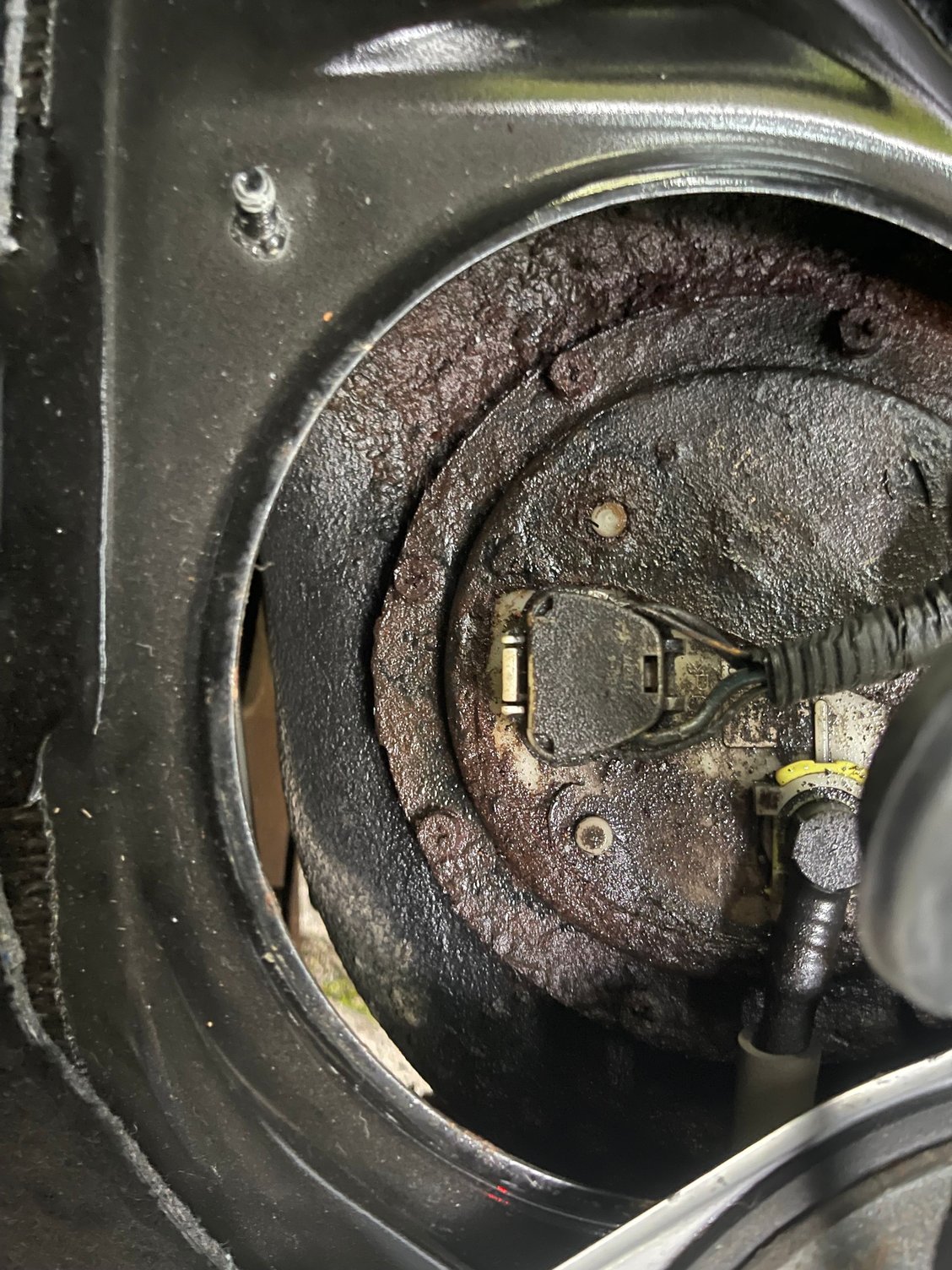

It is still puzzling to me, I took the back seat out, to see if fuel pump gasket is the reason, because it is located right there and… fuel is all over the place
It would make sense to me, if the wet spot would go from the gasket downwards, but gas is everywhere, so it looks like it’s coming from above
But that also does not make sense since there is nothing to leak above
The vent valve and other stuff located closer to the opposite side, and gas would flow to the right hand side, and not left

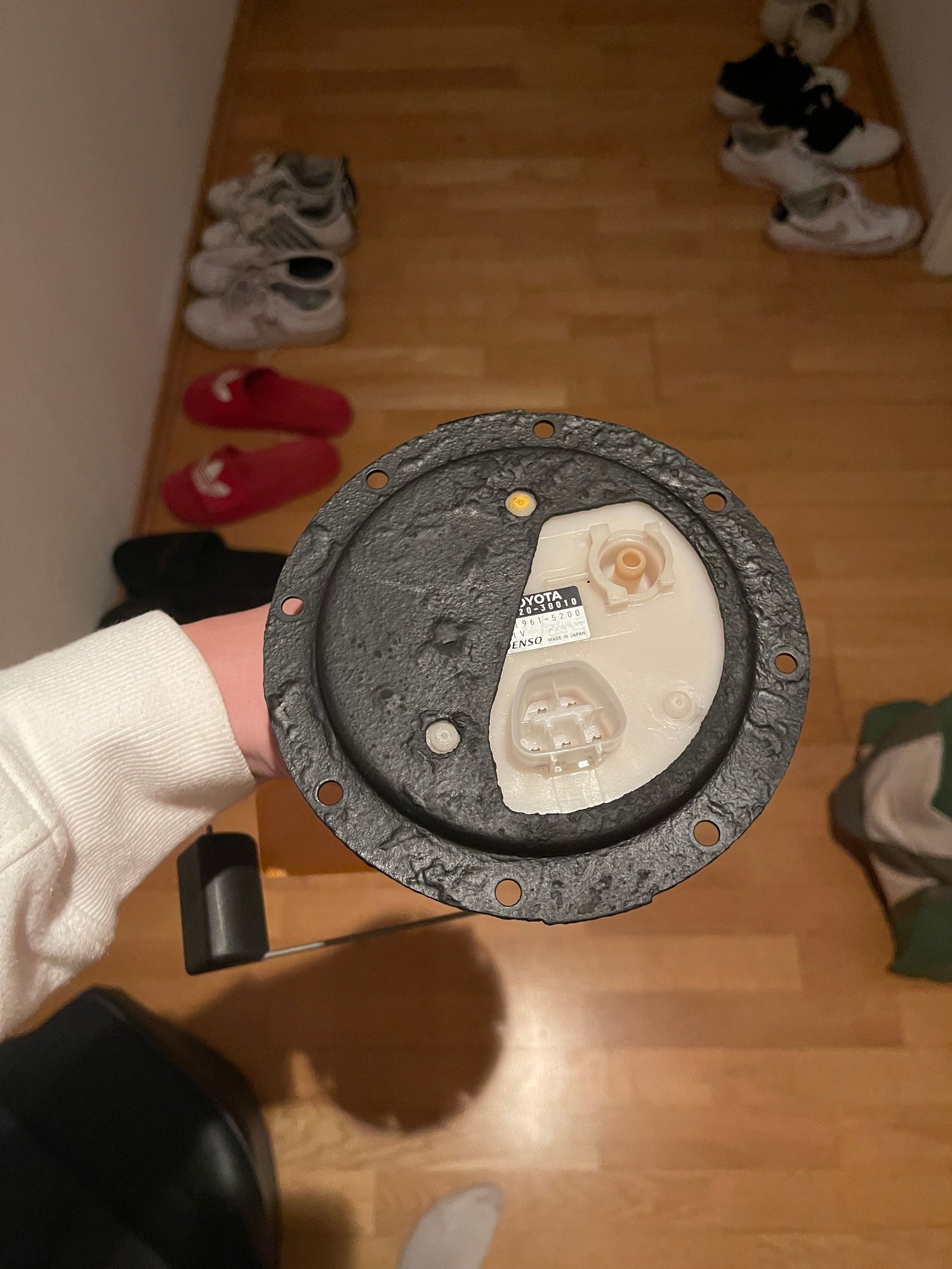

I am back with an update

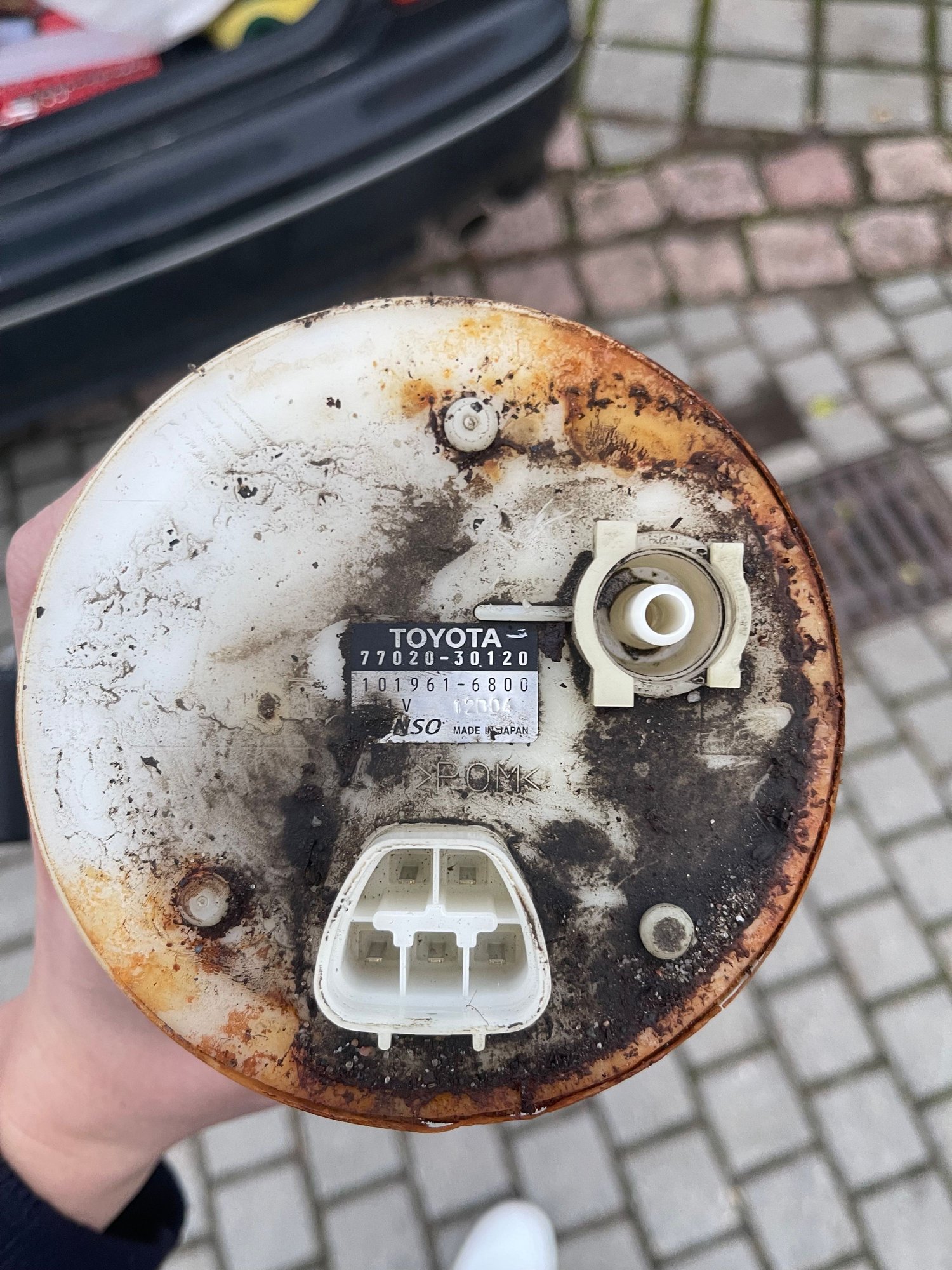

Today I have finally found time to take a look on my fuel delivery unit, to check if this is the case. To my huge surprise- unscrew of that mess was problem-free
And bingo:
I have got the same exact problem, as this gentleman over here:
https://www.clublexus.com/forums/gs-...assuembly.html
The upper part of the unit (one, that makes sealed contact with the rubber o-ring) has decomposed itself. It also has cracks, so fuel gets through it and leaks underneath the tank.
I now have a problem with ordering a replacement, of course I would like to get a new upper part (plate sub-assy, or whatever it called), but one that I have is not available (77020-30120). Only some used complete assemblies.

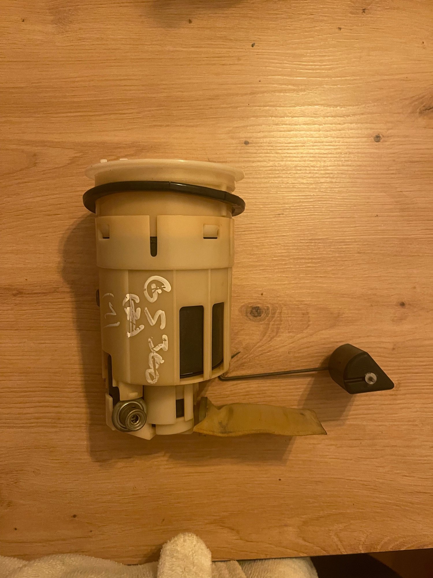

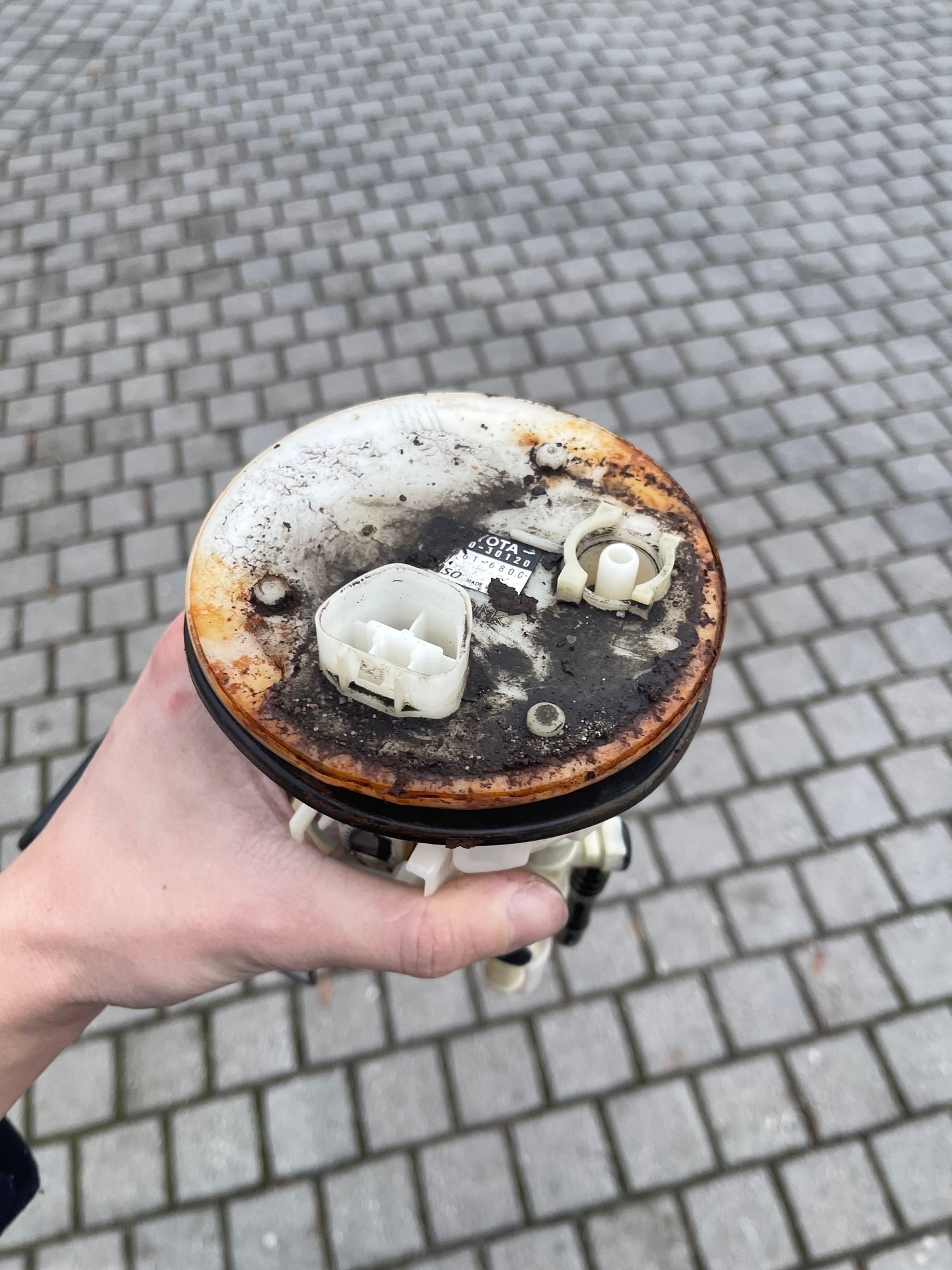

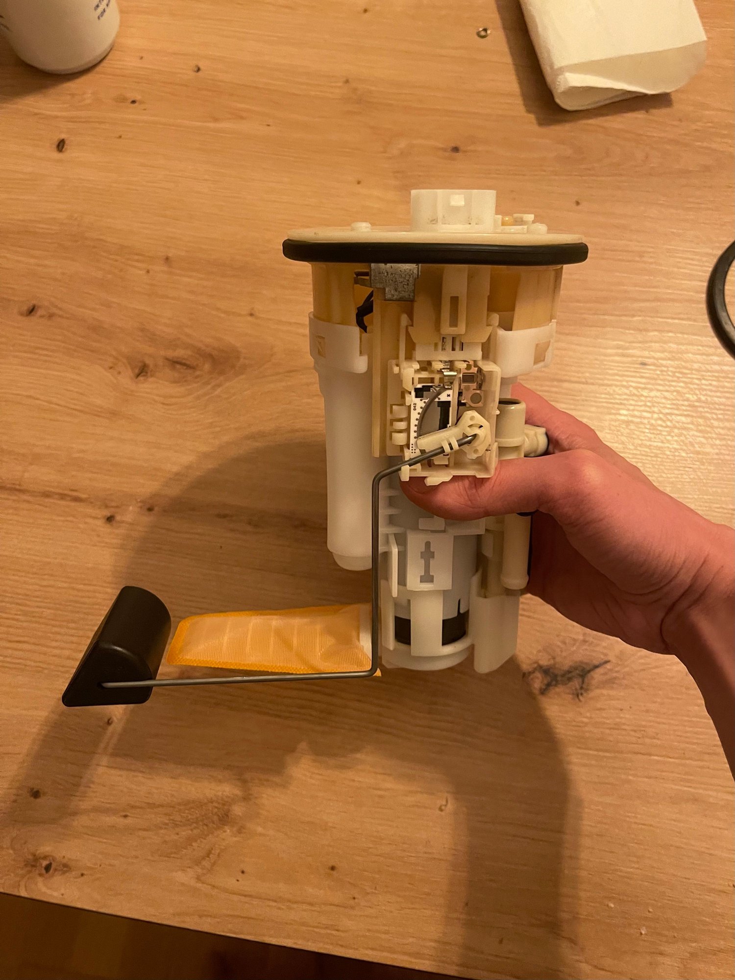

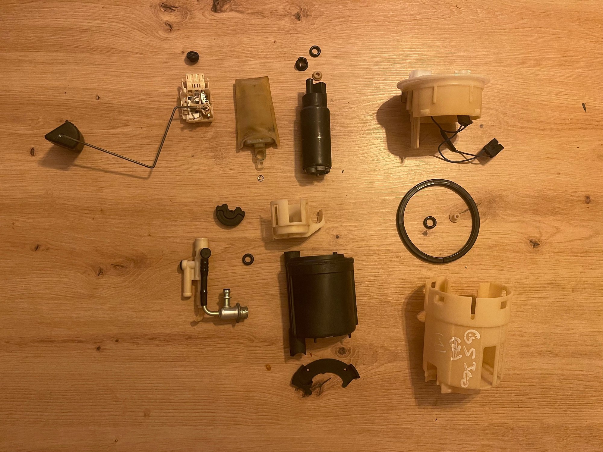

So I had to get myself a used fuel delivery module out of GS300
It’s “hat”, though, is in muuuch better shape, so I am hoping it still has plenty of life left.

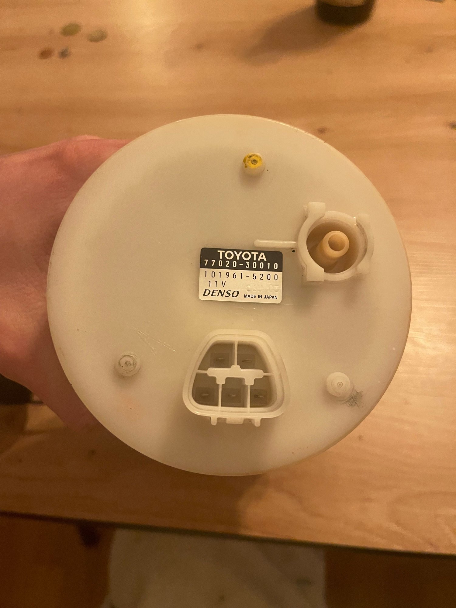

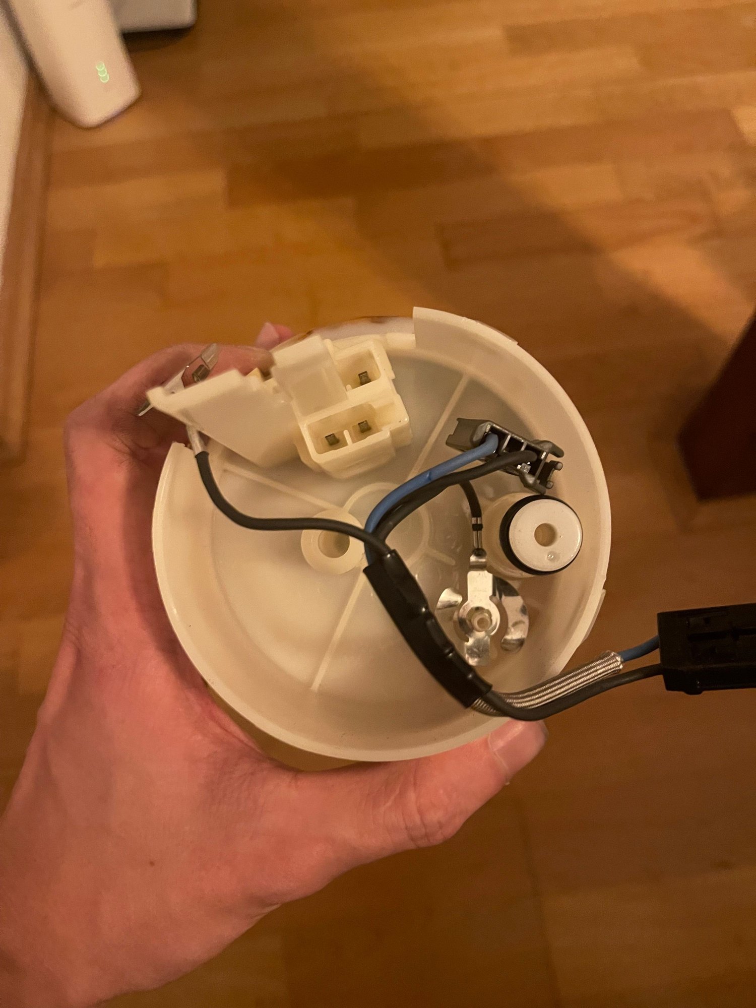

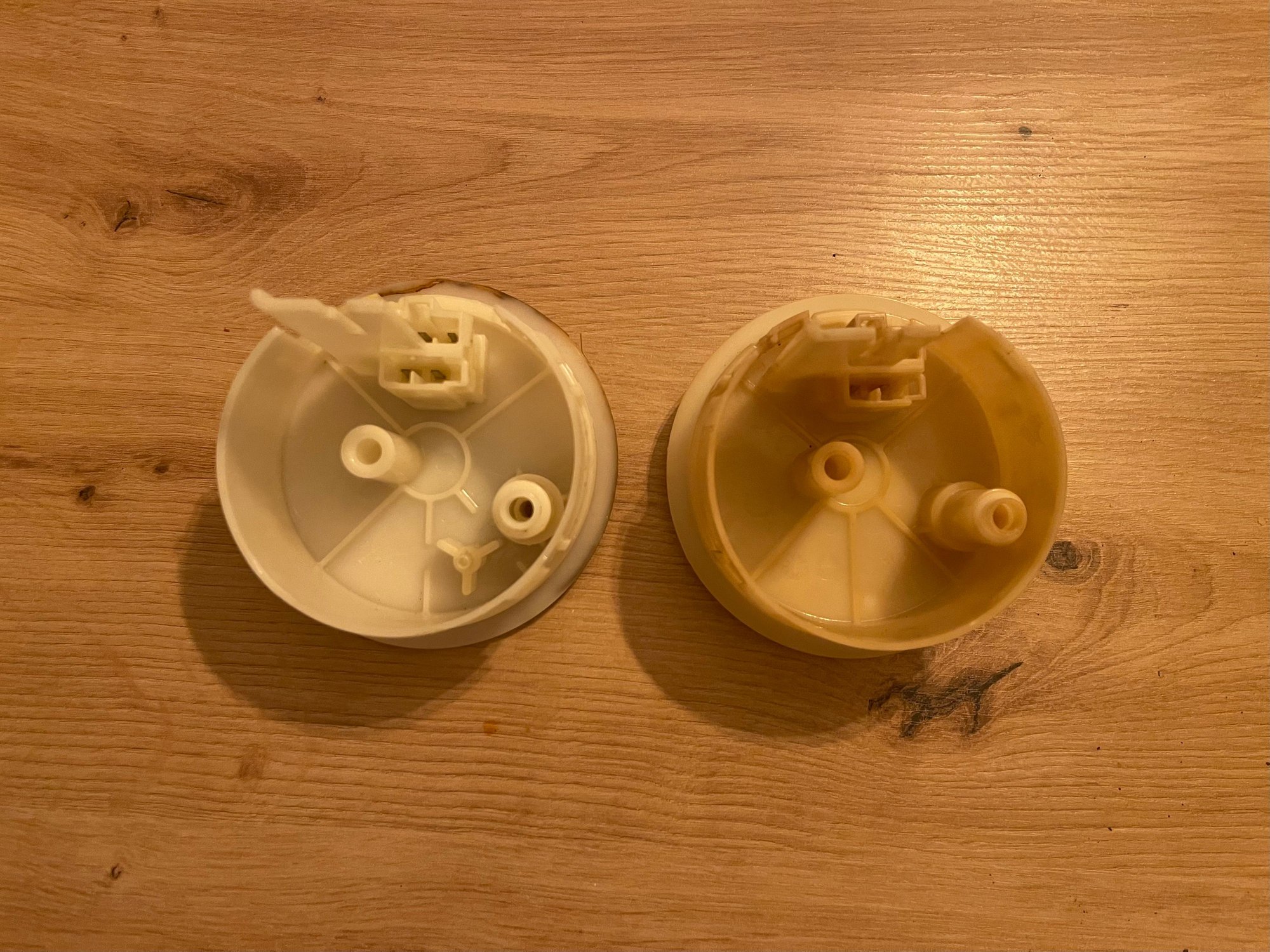

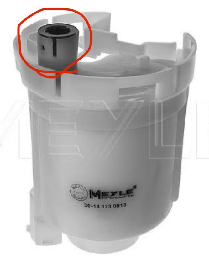

There is, actually a difference between old 77020-30120, and new (to my car ) 77020-30010.
It seems not to matter much, though. 30120 has a plastic pin for a grounding tab (that does not touch any metal, like why…?). And wiring piece, also, has that additional tab.
All that little assembly does mate with blocked port of the fuel filter (30010 comes with different filter type). There are some more minor differences between modules, I can tell more if anyone's interested.

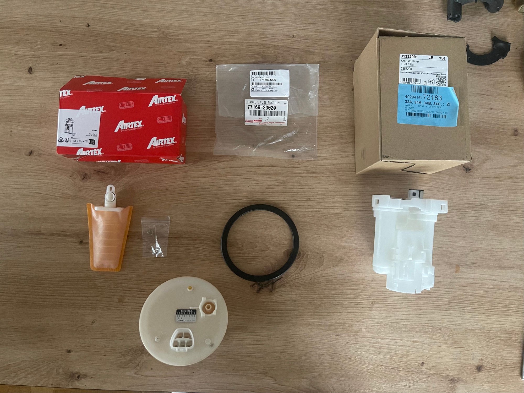

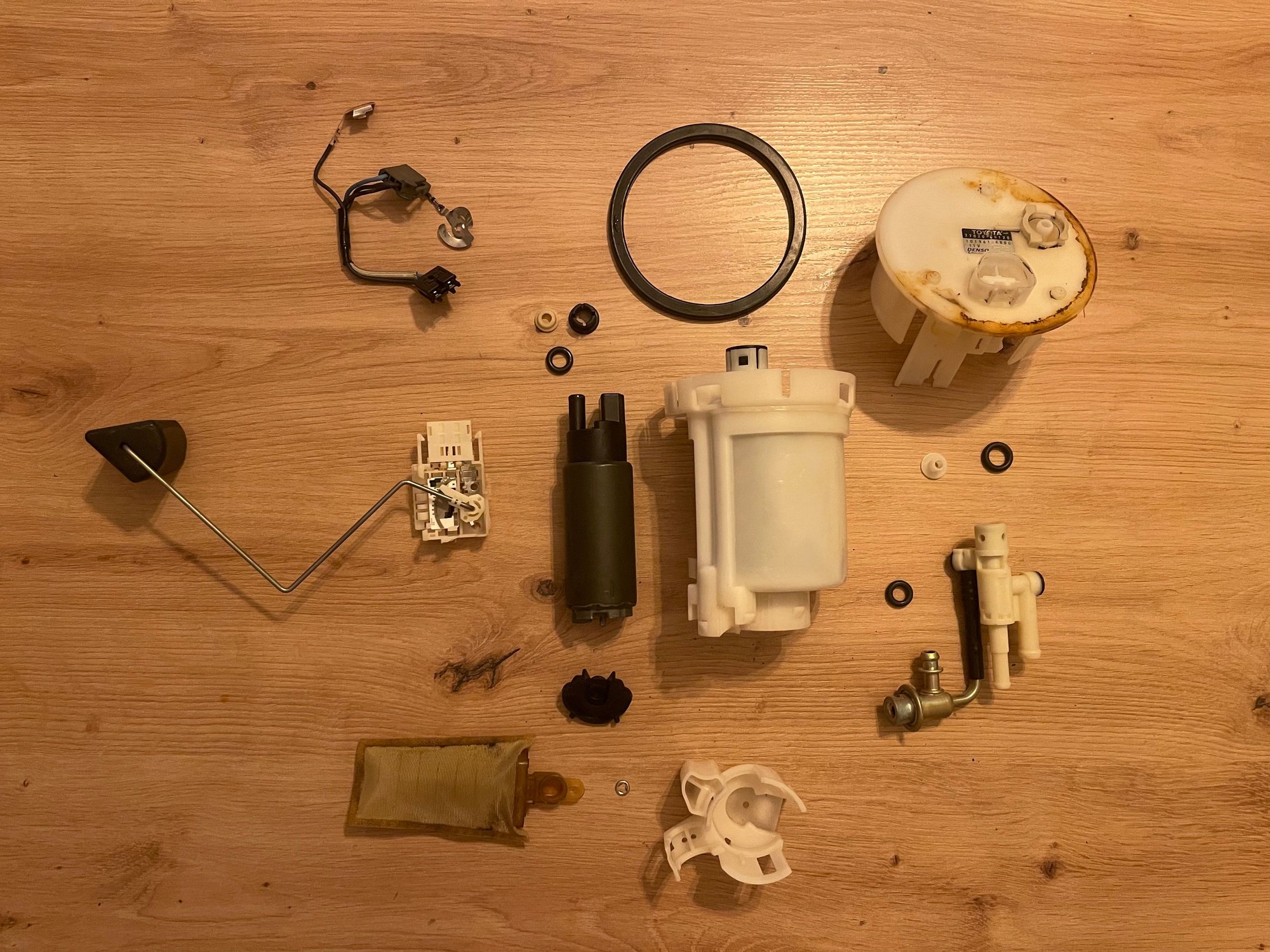

It’s hard to get original parts in reasonable time, here in Germany, so I went with some adequate (hopefully) alternatives. So here is the complete set I have used to rebuild my unit. I also took a “no-extra-grounding-tab” wiring to fit with new hat.
Installed everything back, and happy to report, that leaks and smell are gone, there’s no puddles, and car is happy

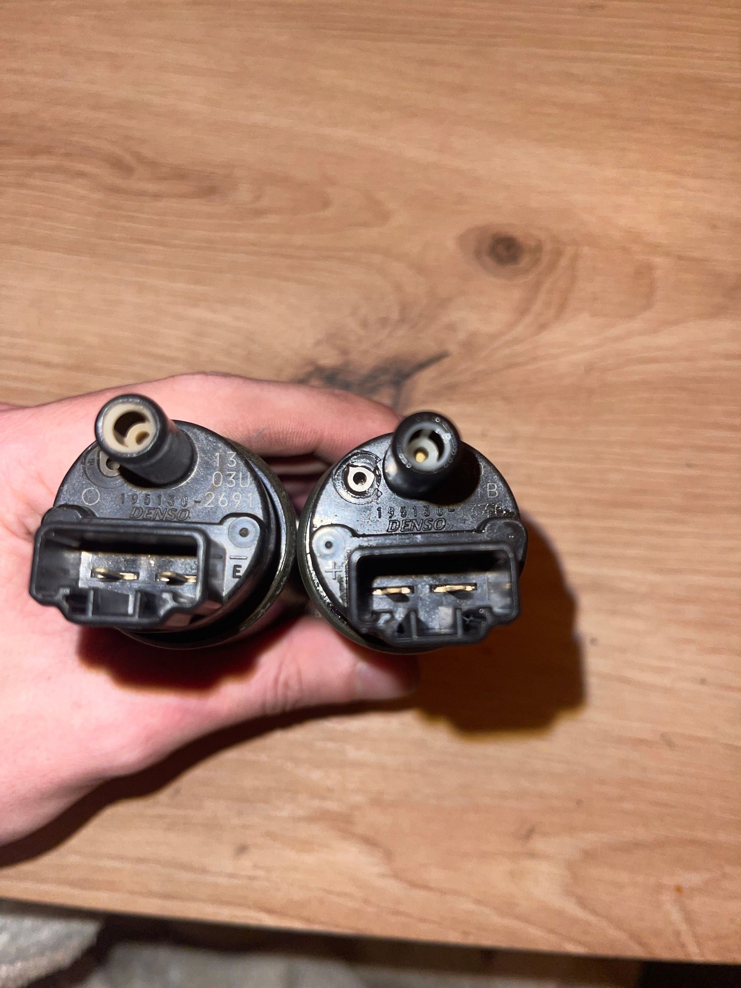

As a bonus- I got a little pile of emergency spares (pumps are same, for those who curious )
