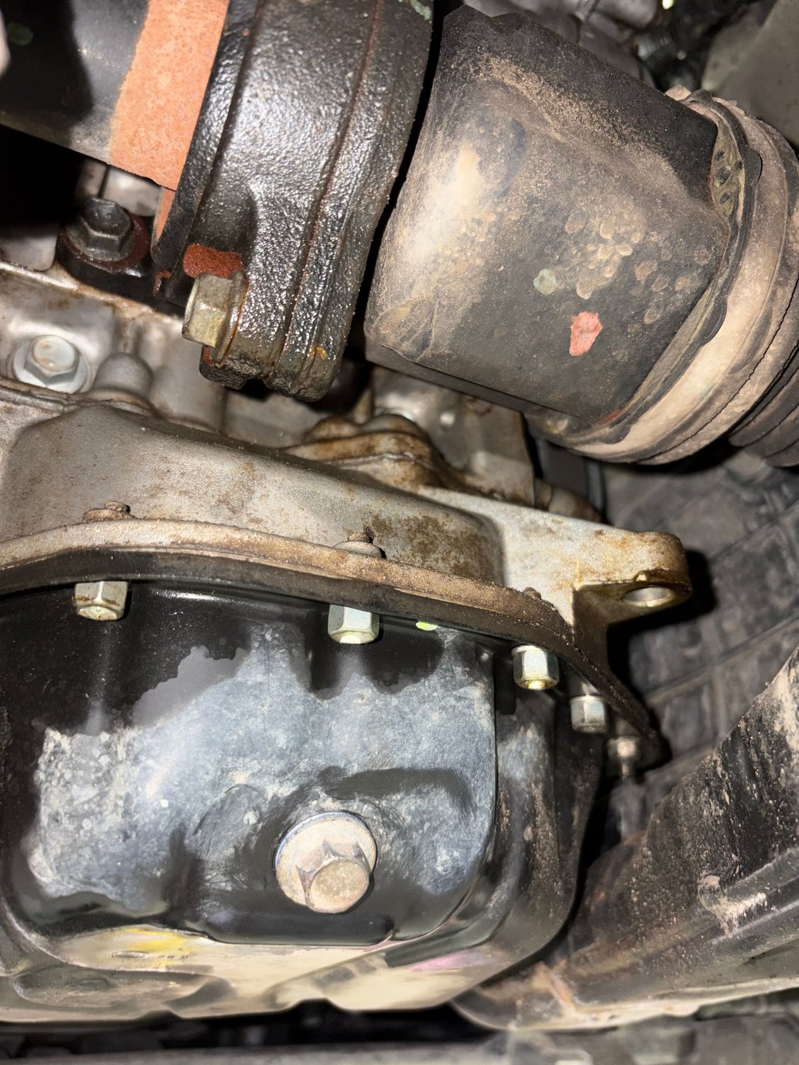

With the odometer reading about 109,000 km I happened to notice an oil smear on my garage floor. Thinking it may have come from a different vehicle, I looked in from the top of the engine and could spot oil staining in the general area of the oil filter. Thinking it was probable that the person who last changed the oil mis-torqued the filter I decided to get to my local Toyota dealership for an oil change (the nearest Lexus shop is 200 km away and it was due for a change anyway), I set up an appointment for the oil change. As it was in the busy season over Christmas I couldn't get in until just after New Years. The shop changed the oil, took a photo and told me I had the blessed “Timing Chain Cover Gasket Leak” (dun, dun, dun, duuuu). I called the nearest Lexus shop and explained the situation to them (by now the mileage was 110,200 km). They said as they did not sell the car then they had nothing to offer me except condolences as Lexus of Japan (!) were very rigid about the 110,000 km limit but that I might be able to get a “Good Will Warrantee” from Lexus of Canada. I sent the photo of the leak taken by Toyota and explained the situation to Lexus of Canada and they said that they could not work with photos taken by a Toyota dealership (like, Toyota knows nothing about this problem with the 2GR series?) and I'd have to get a Lexus diagnostic inspection. (I guess they must be speshul). (sp)
By the time I got an appointment with the Lexus dealership, the odo was now at 110,680 km. They took their photos, confirmed the Toyota finding of an actual leak (not a “seep”, “weep”, or “stain”). With that in hand I resent the info to Lexus of Canada who responded with “good luck, chuck”, it's over the 110,000 magic number. I pointed out that it had obviously been leaking prior to 110,000 as witnessed by the garage floor stain...no joy; they had to have it properly diagnosed BEFORE the magic 110,000 rolled up on the odo.
So, I will be “out of pocket” about $5,000 Cdn/$3,500 US; (the leak is making a mess of the bottom of the engine where it gets flung by the half shaft. Now, I'm not looking for sympathy...I figure I purchased the car at well over $5,000 below current prices for equal options/model year/mileage so I'm not really all that badly off. I'll be getting the job done before the end of the month. I got quotes from Toyota (same price), and from an independent shop who claim to have done this job before (but I know they won't have the computer programing info in case something needs to be reset after the completion) so it will be Lexus who gets the cheque.

The mess after the initial diagnosis by Toyota and with only 280 additional km driven. Note that most of the leakage occurs when the engine is running and the oil is under pressure.

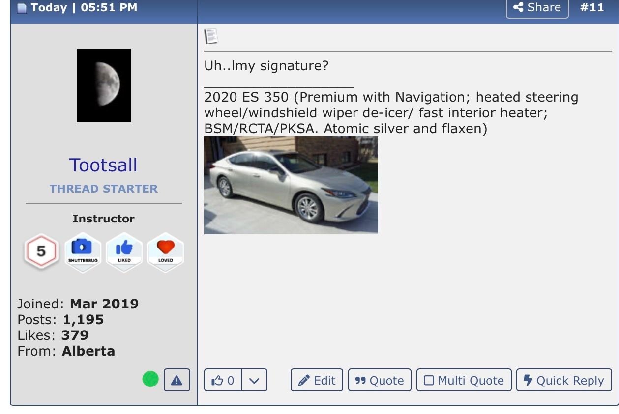

Uh..lmy signature?

ok be easy on me here, I'm obviously missing it. Where is the model year? I see MY signature and that you JOINED in 2019.....

That signature was NOT in the posts I've previously seen as you can see from the screenshot I copied directly above.
Regardless, it agrees with Consumer Reports showing high rate of Major Engine failure for the 2020 Model Year

Well dang! I thought if it is there (and it is), everyone could see it. 2020. Sorry about that…I can see everyone else’s. Is there a setting I don’t know about?
