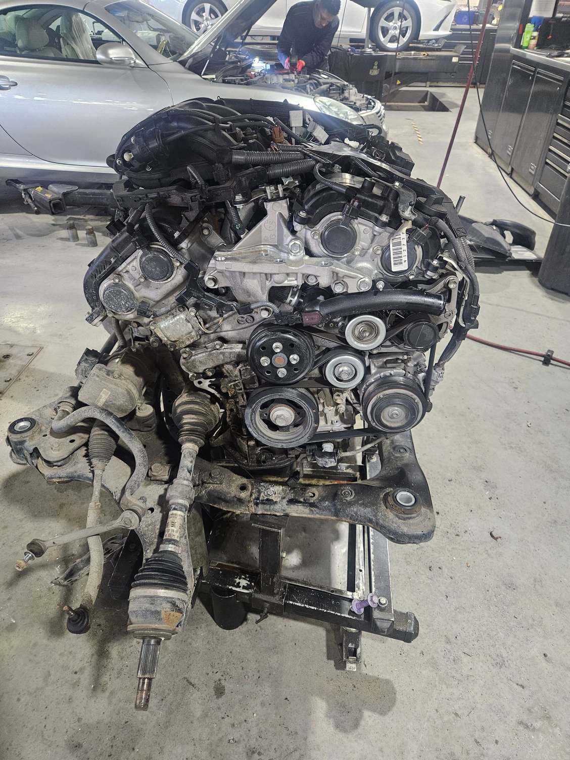

There are YT videos showing the repair process prior to the -FKS engine so, although they may have found a solution subsequent to the 2020, its an issue with the basic design of the 2GR and I see it (the problem) even mentioned with regards to other makes and even 4-cylinder motors with overhead cams. Do a search within YT for <timing chain cover leaks> to see what I mean. I had no idea this was apparently quite as common as it appears.

Engine is out, work proceeds. Water pump displaying start of a leak; will replace at the cost of parts alone (after all, it's out anyway, might as well.....). Wonder if the mechanic knows that if he steam cleaned it before starting, everything would go so much easier.....guess not.

So the engine has to be pulled to do the timing cover?

Yup. Watch the CCN video
Yeah, because there's no space between the engine and the frame. This is the perfect opportunity to replace everything (belt, WP, gaskets, seals...).

Job completed. They left the dashcam connected the whole time so I was able to see the work being done plus the test drive. Timing cover gasket replacement, water pump and serpentine belt replaced, brake fluid flush and replace, 4-wheel alignment, $5350Cdn.total for everything (well, except sales tax which is not under Lexus control). Labour, $3,500. Parts $1,800 includes water pump @ $318, belt @ $83, and a whole bunch of gaskets and sealants, coolant, oil & filter, plus 4-wheel alignment and "shop supplies". All $ Cdn, multiply by 0.7 for approx US$. They even cleaned the engine! 200 km drive home yesterday with no issues noted, no leaks, no vibrations, no shifting issues. No reprogramming of anything needed (must have left battery connected except for starter & alternator...also hence full cam recordings). I'll be looking at transmission fluid change in another 10-20,000 km. Should be good for "lifetime". Nice shop, well laid out. Almost as nice as the reception/sales area.
Now, the car in the bay next to mine was getting a new engine(!!). Hope it was a warrantee job..
Decorative cover removed for clarity.
