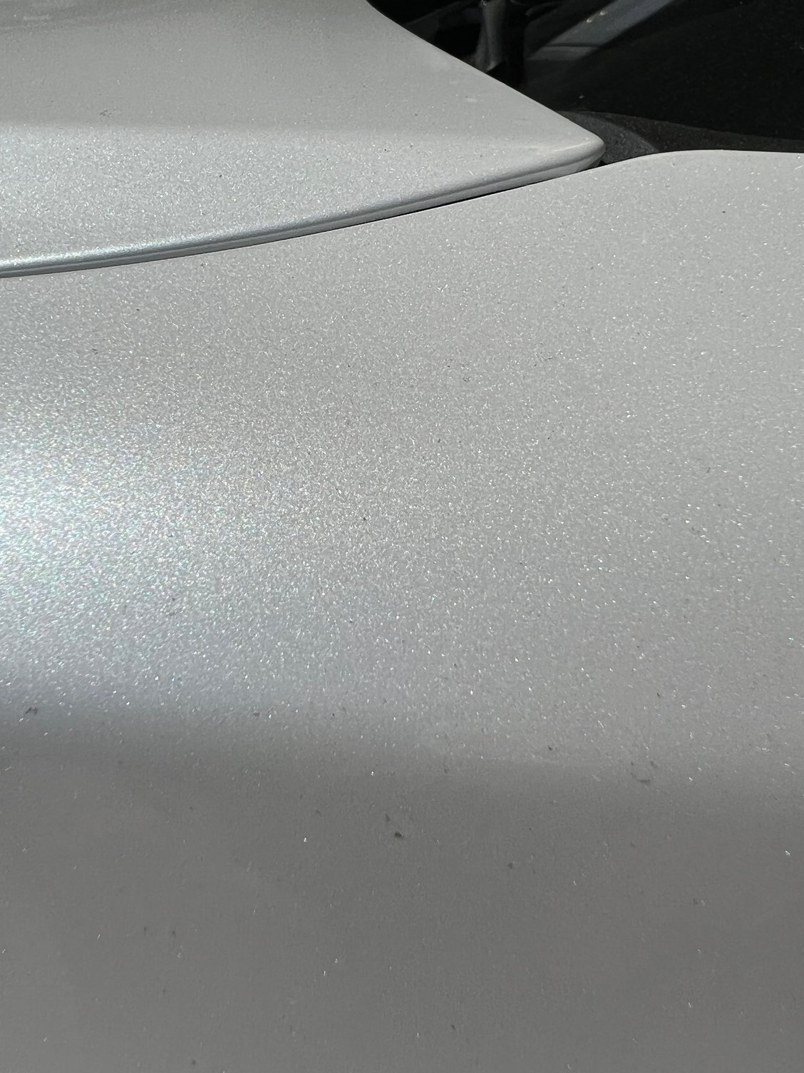

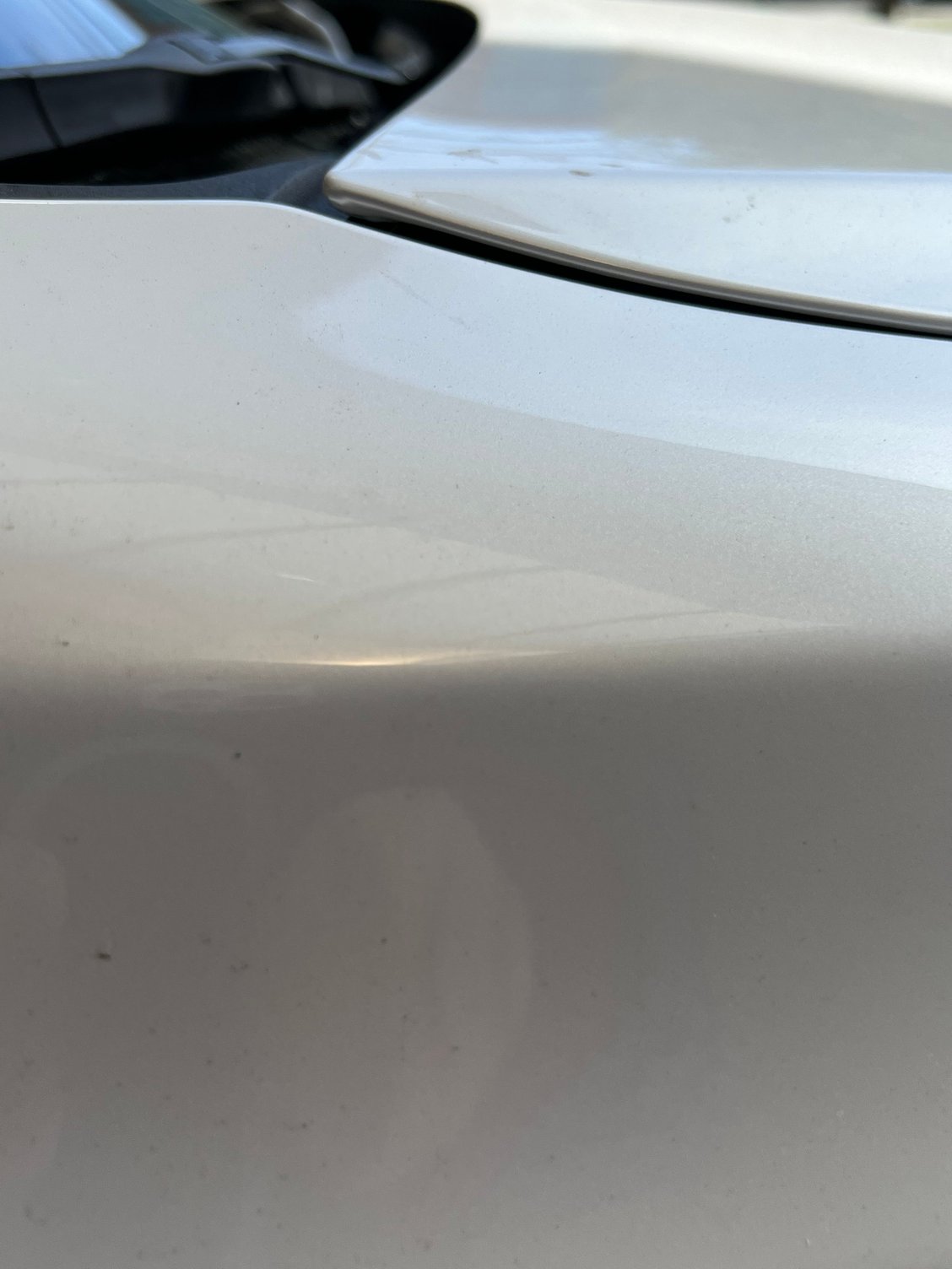

I went to 2 different local Lexus dealerships to look at the ES vehicles the other day. I noticed that both dealerships had an ES that had a misaligned hood. Lexus ES vehicles now also have misaligned hoods too.
The misalignment was present on the right corner of the hood near the windshield with a gap in the hood. The hood was up higher on one corner than the other corner. Can the hood be adjusted to straight to fix this particular misalignment? I took pictures to show you.
Car number 1. This is the left side. The left side is not misaligned.
Car number 1. This is the left side that’s sticking up and misaligned.
Car number 2. This is the left side. The left side is not misaligned.
Car number 2. This is the right side that’s sticking up and misaligned.

Originally Posted by glamglam
I agree with you that the dealer should have caught the misalignment of the hood and that he should've fixed it if it could be fixed. I wanted to ask you about the hood fix. How would the dealership realign and fix the misaligned hood? Are there any adjustment springs on the hinges underneath the hood to make the corners of the hood that is near the windshield be more flusher and even on both corners with both front fenders? How is this particular hood misalignment fixed?
Also, I don't think that the line workers on the assembly line are doing any of the welds. I could be wrong about this, but I believe that the welds are all done by the robots. Maybe the engineers didn't program the robots correctly causing them to miss or omit the welds or maybe the robots are not programmed correctly to fully weld the panels causing them to not stick together and to come lose. I don't understand how Lexus can miss something like this during manufacturing. They are supposed to inspect everything as the build progresses from the beginning to the end. I'm baffled how Lexus can miss something important like this. This is scary thing with what's happening with the vehicle not being welded properly during manufacturing. I hope that the ES vehicles do not have this same problem. I know that one member in here had the welding problem, but I do not know whether it's just a fluke or if many more ES vehicles are going thru the production line with halfass welded panels on them.
I don’t know exactly how Lexus does it per se, but normally hoods and doors can be aligned and adjusted by loosening certain bolts; the bolt holes are oval and allow some movement that should get the hood (or door) seated properly. To the best of my knowledge this should be doable on any vehicle.
The only bad thing that I see here if the hood bolts are tampered with is that the wrench or socket will strip off the paint on the bolts and rust will start to develop on the bolts and make its way up under the hood if the vehicle is driven during the winter in places like up here where they use lots of salt and brine on the roads. I know this because I had a body shop do work on the hood of my Charger and they loosened the bolts underneath the hood and the paint came off the bolts in certain areas when they used the wrench/socket and rust started to develop right away on the hood bolts and on the area around the hood bolts.
The hood on the ES that I saw at the dealership should've been aligned correctly at the factory during production when it was put on the car, not after the car is delivered to the dealership.
You’re right but that’s how the factory adjusts them too and how a dealer is supposed to. A good mechanic will be careful and not strip paint off the bolts…and if they do a bit of touch up paint will take care of it.
