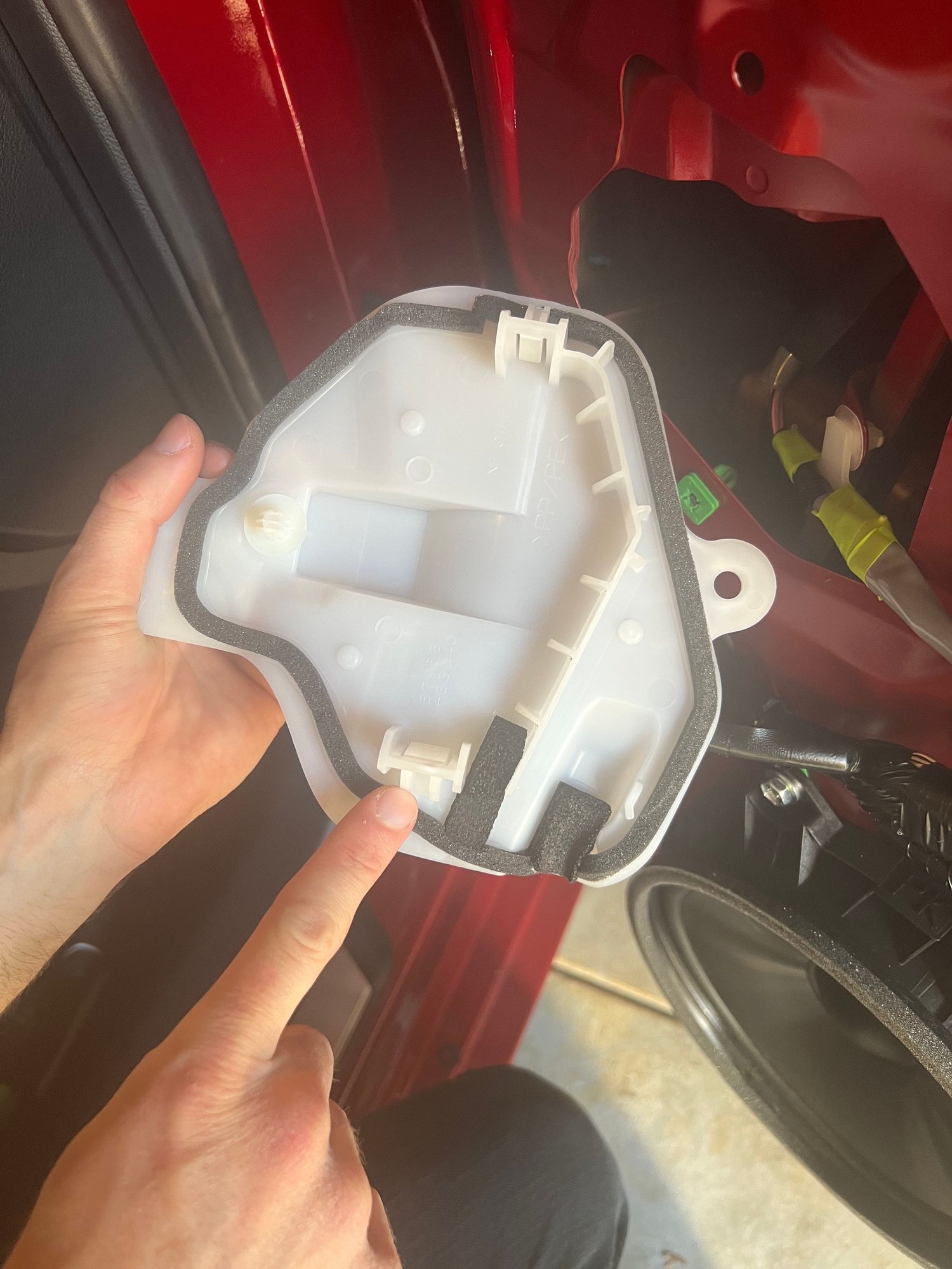

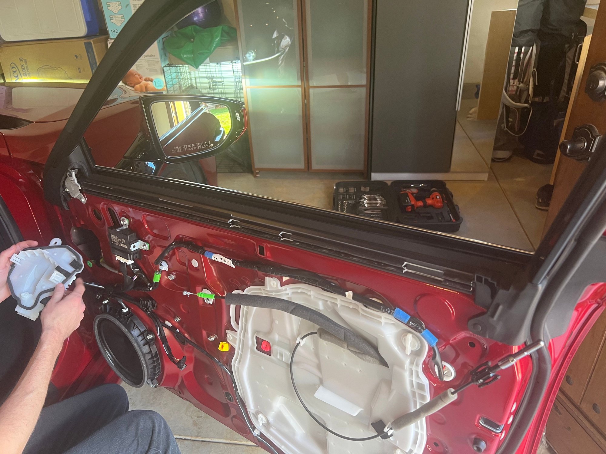

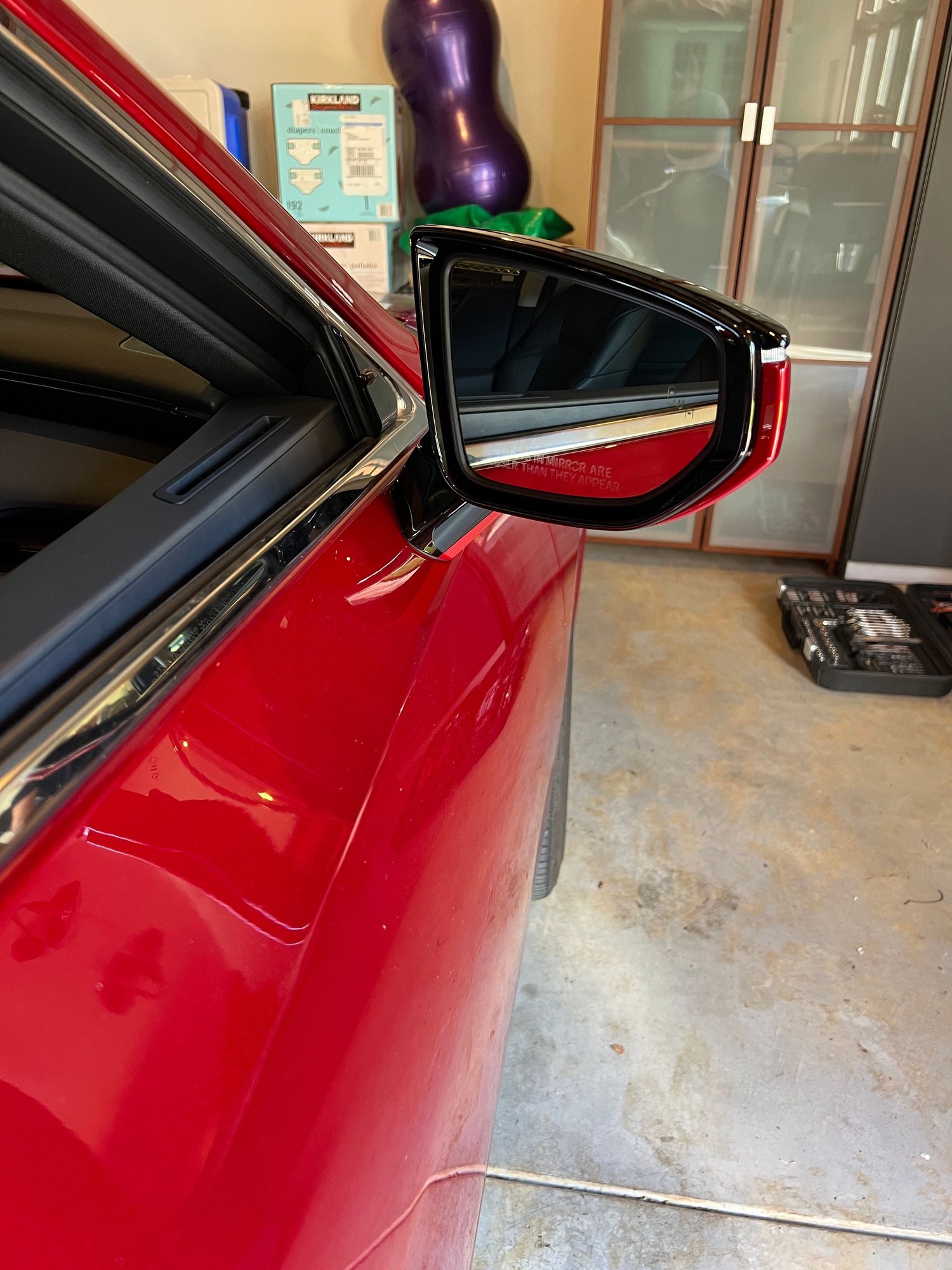

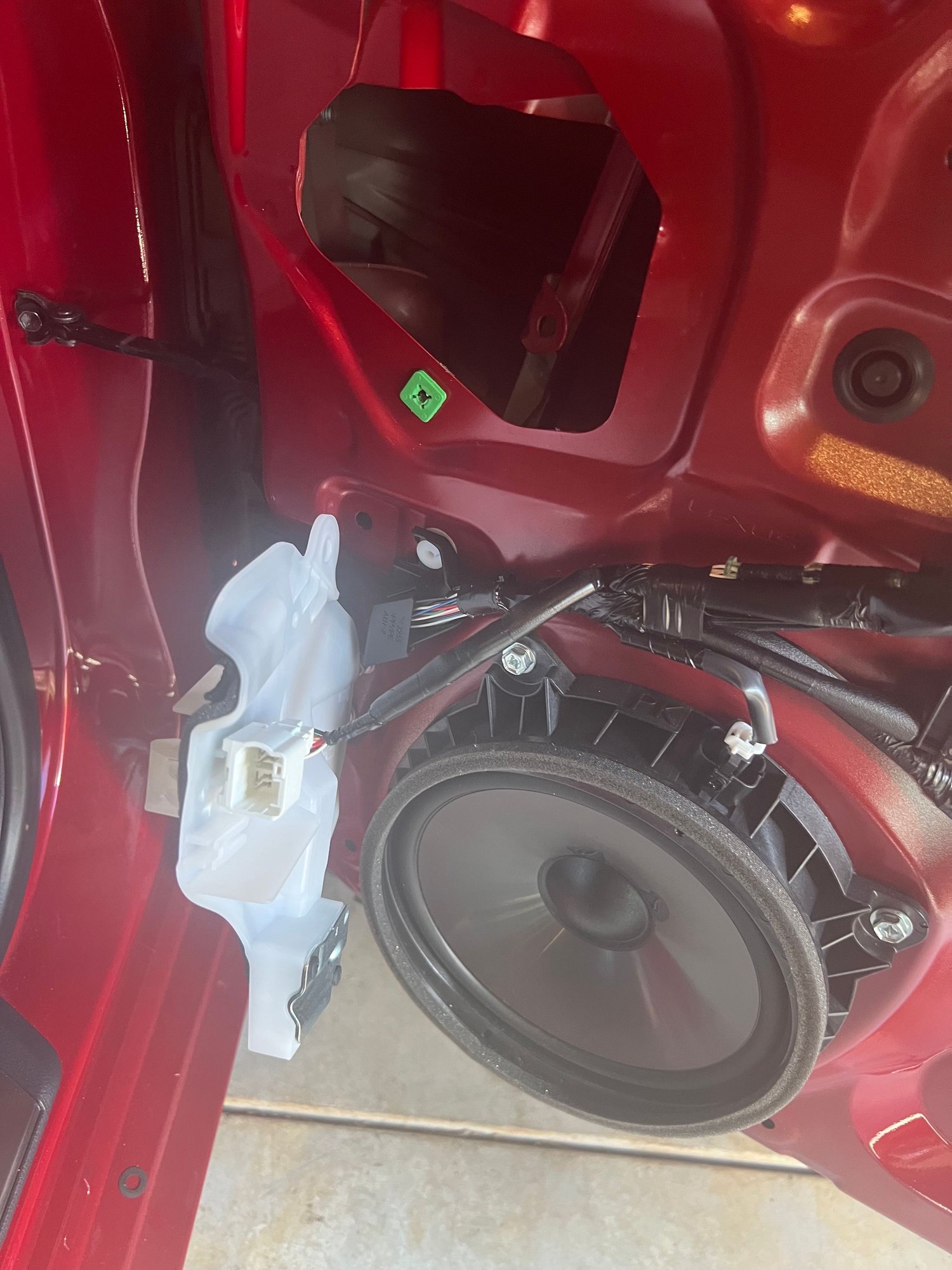

Update - mirror fully repaired! Big thanks to @E46CT for the instructions on door panel removal! And to everyone on this thread for pitching in - we wouldn't have had the confidence to do this on our own without you.
  • We've never repaired our Lexus before and the entire job took exactly an hour and was very easy.
  • We ordered the part (8791006C30D0) from the Lexus dealer for $575 using the Costco discount. Each person we talked to at the parts department had a different interpretation on how to use the Costco discount, and ultimately when picking up the part my husband had a bit of a struggle getting them to apply it but it did work out. You'll need to print off an authorization form from Costco before you pick up the part - you can register for the discount at this website: https://www.costcoauto.com. Ordered part at 4pm Wednesday and was ready for pickup by 9:30 am next day!
  • When unscrewing one of the 3 bolts, the first bolt fell inside the door. A flashlight and an extendable magnet got it out no problem. But be careful of where the bolt drops when unscrewing to avoid this problem.
  • The only other thing not listed in the door panel removal instructions was the removal of this white part (pictured). There are pinch tabs on either side by the arrows. It was easy enough to figure out on our own, but took pictures in case they are helpful to anyone.
Good as new and completed all while baby was napping! Thanks y'all! Really appreciate your advice!
