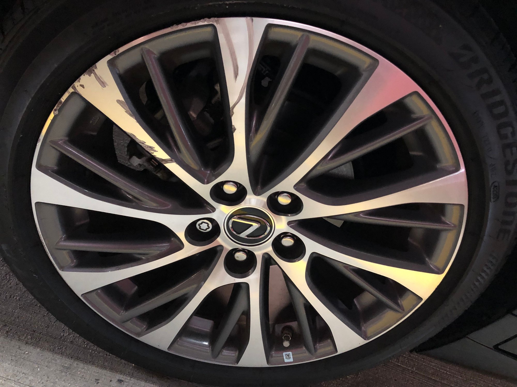

3. I have curb side damage on my rear wheel (rim) as if you can in another attached picture. Again what’s the cost effective way to remove them.

Wheel repair is generally $125 to $175 per wheel. Looks like you bashed the bejesus out of it.

I have yet to see an owner repaired door ding with paint damage match that of a refinished, painted door by a professional body shop. Touch - up paint just doesn't cut it. IMO, usually it looks worse... OTOH, the wheel can be made to look like new by a skilled repair person. Been there, done that...
