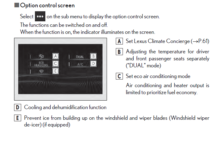

You have to turn it on manually each time you want to use it, and it's somewhat inconvenient. Go to the climate section on your infotainment screen, then the more/options selection. It's the icon that you won't recognize. I'll snap a picture to add here.

Thanks for the reply. The manual on page 269 and the options in climate section on the screen are the same and it doesn't refer to the fast response interior heater. Could you please post the icon you are referring to.

Unless I'm mistaken, it's the icon I have highlighted here. And if I'm wrong, then I have no idea what that does! Lol

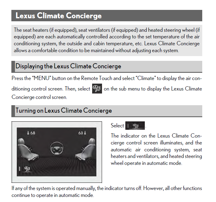

That symbol clears ice on the wiper blades and lower windshield. I think the Concierge feature might be more in line with what you're looking for. When the car is started, whether remotely or not, the seats and the steering wheel accelerate the heating, or cooling function, even if the engine has just started.

Good to know. I actually thought that button in the climate section toggled both the wiper heaters and the fast response heater together, not just the wiper heaters. Not sure if that was my own assumption of if the salesman I worked with told me that one...not like that means he was right either. I do use the climate concierge pretty much all the time anyway, and understand how that works. People have gotten a kick out of the nice cool seats when they get in in the middle of summer when I've started the car ahead of time to cool down.
