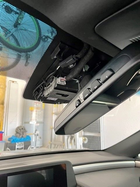

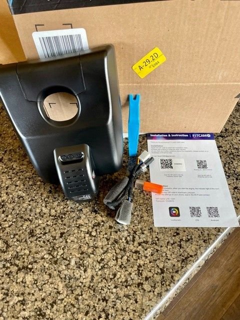

Received the Dashcam in the mail today and got it installed.
Pretty straightforward, the hardest part was removing the small fill-in cover plate on the new cam assembly, had a tab that wasn't cooperating, struggled with it for a while of concern it might break off.
Package Box
Contents
Showing the Dashcam unit

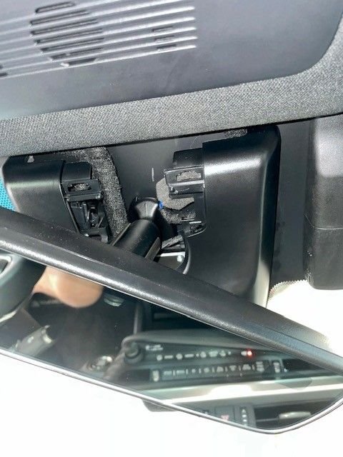

Removed cover at windshield. Best to swivel the mirror 90 degrees in a vertical position to better access the cover plate and wiring.
Passenger side view accessing the wire terminal connection.
Making the harness connection at the windshield. I found it beneficial to make the wiring connection at the windshield first vs at the cover plate with the dashcam. Makes placing the wire harness and then snapping in place the cover a whole lot easier, then having to tuck the wiring afterwards.
Wiring harness tucked into in placed. I kept the wiring toward the right side in the voided areas.
View of the unit above the mirror before snapping the cover plate in place.
Driver view of install unit.
Final cover in place, showing what little obstructed view there is...... initial install completed!
Next is to get the unit connected and activated. I'll return with my assessment. So far liking the OEM look!
