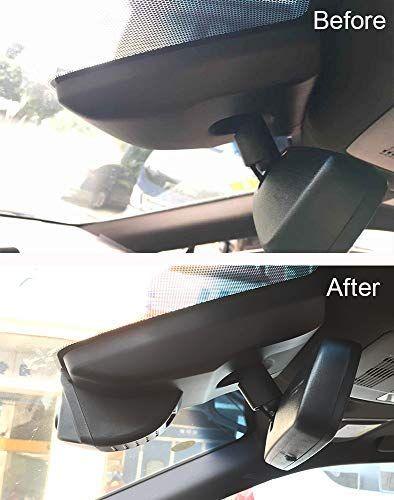

I installed the Fitcam just now. It is a very easy installation. The photo below shows the Fitcam module and the OEM module. First you slide off the OEM module. Then you connect the included "Y" cable. It reconnects the mirror sensor and feeds 12v to the camera. Then you slide on the camera module. It all simply plugs in and the wires are contained in the Fitcam module. There is a very minor texture between the Fitcam module and the the OEM module. Once installed, you cannot see any difference. I rate the Fitcam as looking like it is OEM. It does not look added on. This makes me a happy camper.
If you get this dash cam, pay attention to how the OEM module comes off. The Fitcam goes on the same way. You need to transfer the orange clips from the OEM to the Fitcam. Then take the blue lens protector off the Fitcam. Sounds obvious, but I initially missed it. You need no tools except the plastic removal tool included in the kit.
In about a week I will post how well the camera works and how clear the video is. I will include photos to show.
