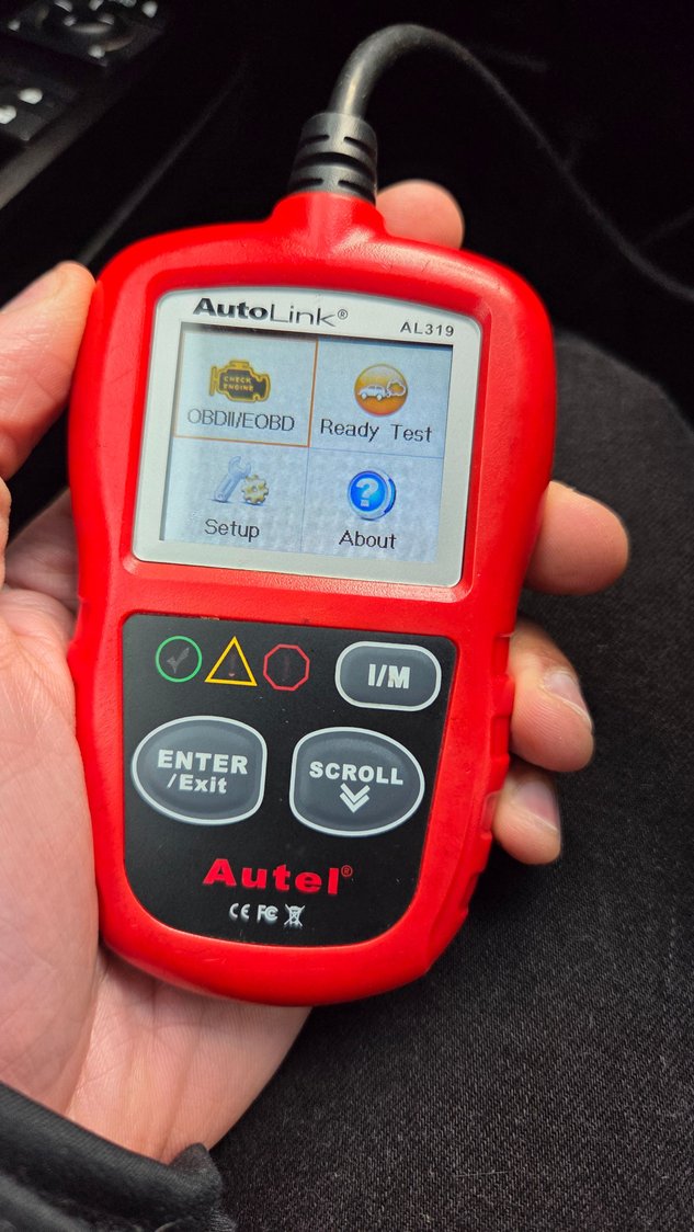

No luck with the AutoLink OBD scanner, seems to be good only for engine and transmission codes. During its startup, it briefly showed 2 misc codes that couldn't be read, which I imagine would have been the rain sensor and/or wiper system. I plugged the sensor back in for now, although I might reach out to Carista to see what exactly their "automatic wipers" setting entails.

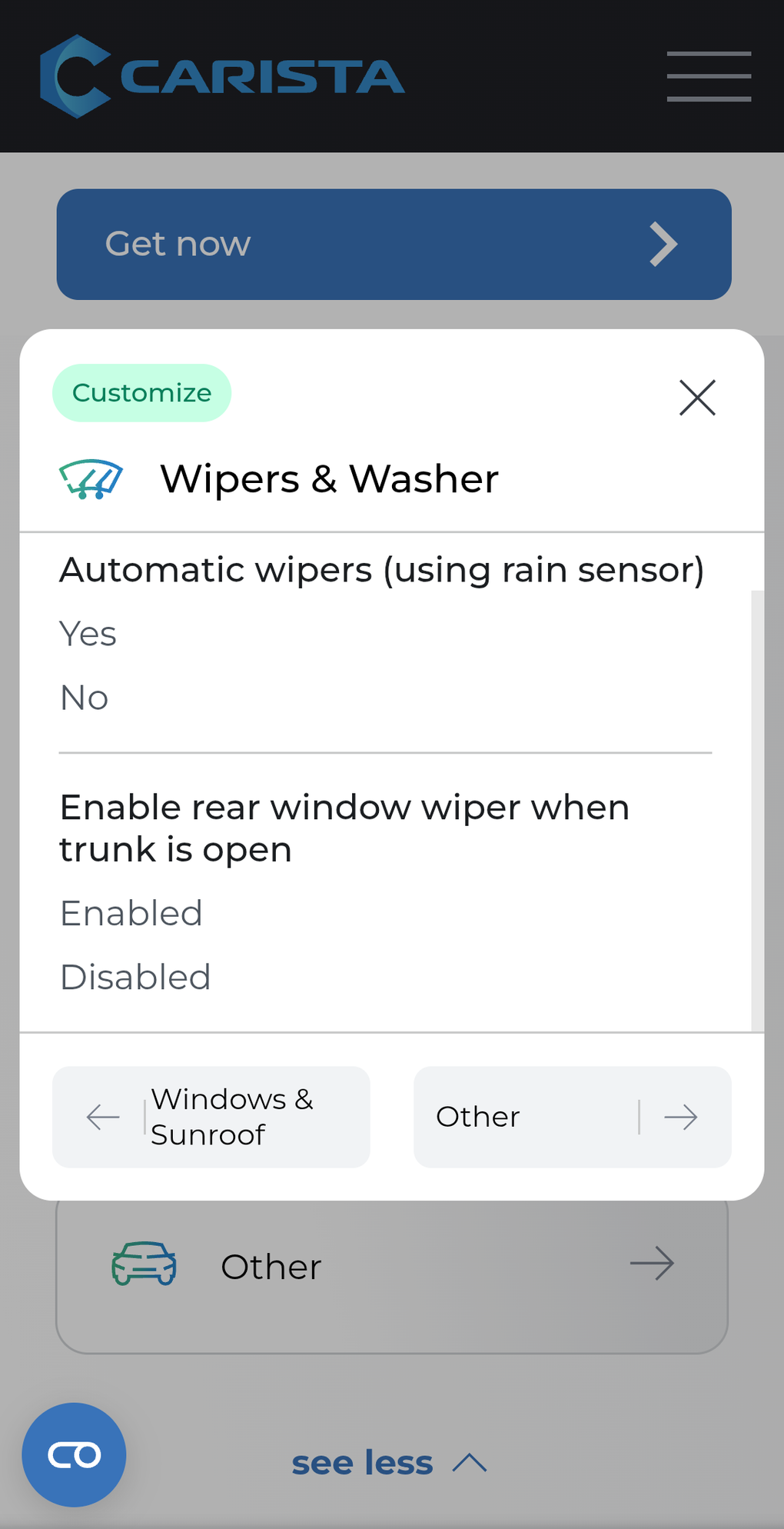

https://carista.com/en/supported-cars/lexus/es/7th-gen

I wouldn't put much faith in the accuracy of the information on that webpage.
Look at what the listed "Wipers & Washer" available customization settings are:
​Enable rear window wiper when trunk is open
Enabled
Disabled
I'm not aware of any 7th generation ES that has a rear window wiper, so there's not going to be a setting for a rear window wiper, even though that webpage states Carista can customize that setting for a 7th generation ES.
Clearly they have screwed the page up and included info from an RX or some other model SUV. If you read down the next list they have even listed "Rear Hatch" !?
