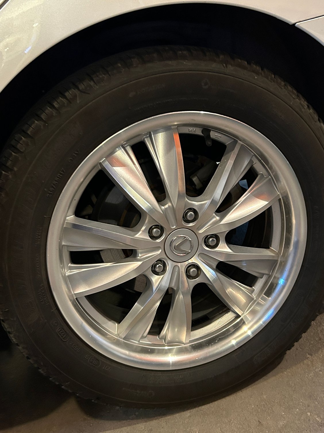

I know there has been a lot of discussion on TPMS (TPWS?) in the past. My "new to me" 2020 ES 350 is having a difficult time getting my winter tires to register and to initialize. The problem seems to be with that silly "erase on reverse" feature...I am not in a position to park the vehicle for any length of time (days?) where I can avoid reversing so the "do it yourself" method shown in the instruction manual is just not working for me. Here is the question: if I go to a tire dealer (don't suggest a Lexus dealer, the nearest one is 120 miles away), to get the vehicle "programmed" with the correct TPMS id numbers (I have those for the winter wheels), is it still going to be necessary to do the "drive until it takes without ever reversing"? Or will it just "force" the ID's in and initialize as well? Anyone know from personal experience?
I am used to the older generation '14 where I had the tpms id numbers from the OEM wheels and had the tire dealer jam the same id numbers into programmable TPMS tire sensors on the aftermarket rims/tires. When I traded that car in on the newer one I kept my winter tires on the OEM Lexus rims (heavily curbed by a previous owner), as well as my set of aftermarket rims with summer tires and the cloned sensors so as to avoid the need to re-initialize at each seasonal switch. It did work great...just swap the tires around and drive off...everything registering properly and without any hassle.
(Yes, I got a set of Lexus center caps and stuck them on the aftermarket RTX "twist" rims)

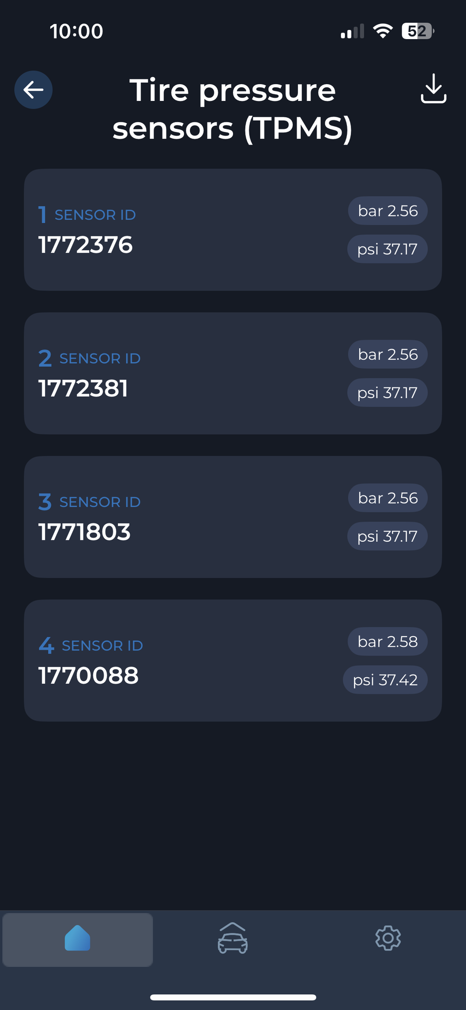

I saved this from the OEM sensors on the '14 before I had the second set cloned to match. The issue is that the '20 is looking for a different set of ID #s so I have to program the vehicle, not the sensors, and that is where I am having the problem.
The TPMS tools I mentioned above can do that. Obtain the sensor IDs along with the wheel position associated with that sensor ID and then upload that through the OBD-II port to the vehicle's TPMS's data store.
Some sort of TPMS tool is what a lot of people working with automobile wheels use whenever a vehicle's TPMS needs updating with new sensor IDs or sensor locations. That eliminates potential trouble with the vehicle's sensor learn function and avoids burning employee time driving vehicles to ensure the update vehicle's TPMS part of the job is satisfactorily completed.

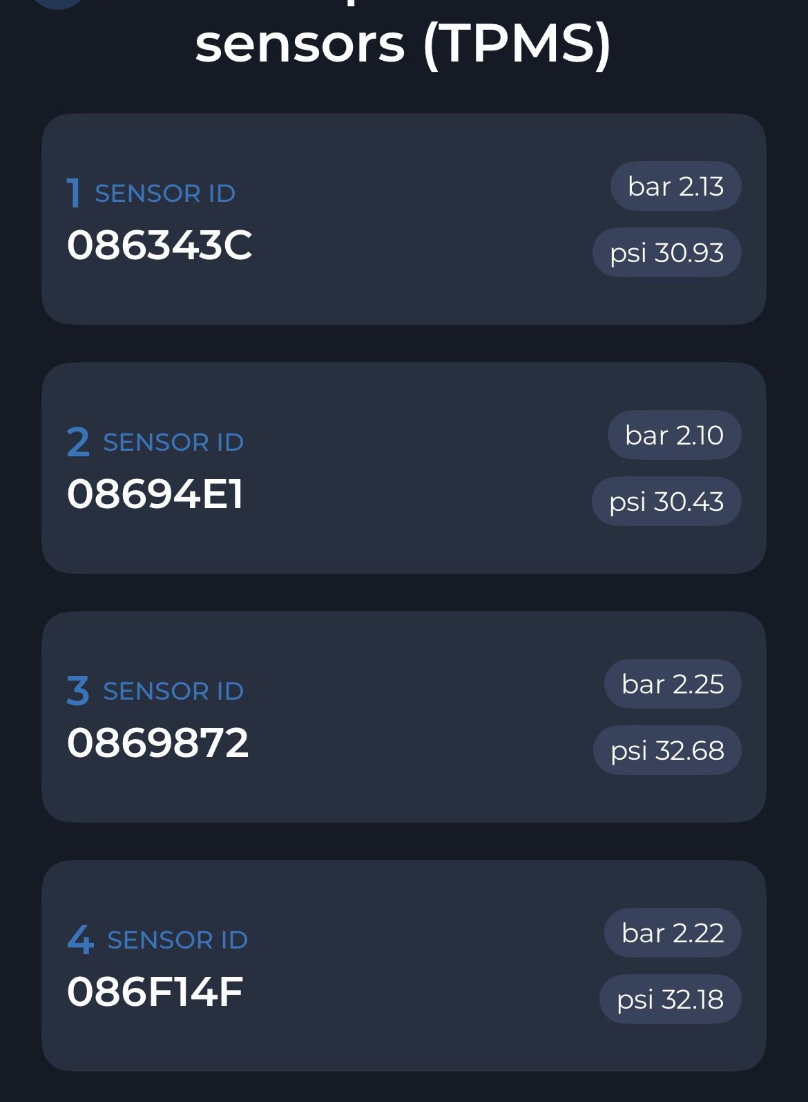

Well, if you read the back story I posted, I've had either the winter tires or the summer tires in the same garage where the car is parked (the '14) and within no more than 10' of the rear receiver with zero issues for the past 5 years. I have heard that others have had the problem you mention but I have never experienced that myself...in fact I never even had to hit the reset button on the '14 when I made a seasonal switchover. As I posted above, the problem I had with the '20 is that it does not make friends with the sensors from the '14 due to a difference in software/hardware. No point in me buying the Autel because my tire dealer is the guy who would change the rubber and rebalance so he does the sensors at the same time: the Carista app simply confirms the sensor ids and pressures being transmitted via the OBD port. The Carista can reprogram the id numbers on programmable tps sensors; what it cannot do is program a vehicle sensor computer and display system (which the Autel...and that is what I had for my second set of tires...)can do. Now I just have to have the dealer check to see if the Autel sensors on my summer rims (I'm getting new rubber on those anyway) will be capable of working or if I'll have to buy the newer version of sensor to suit the '20.
This is the readout I got just this morning with Carista:
