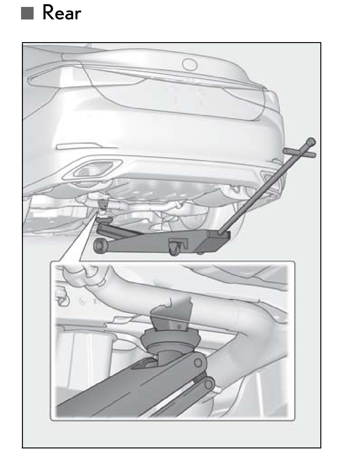

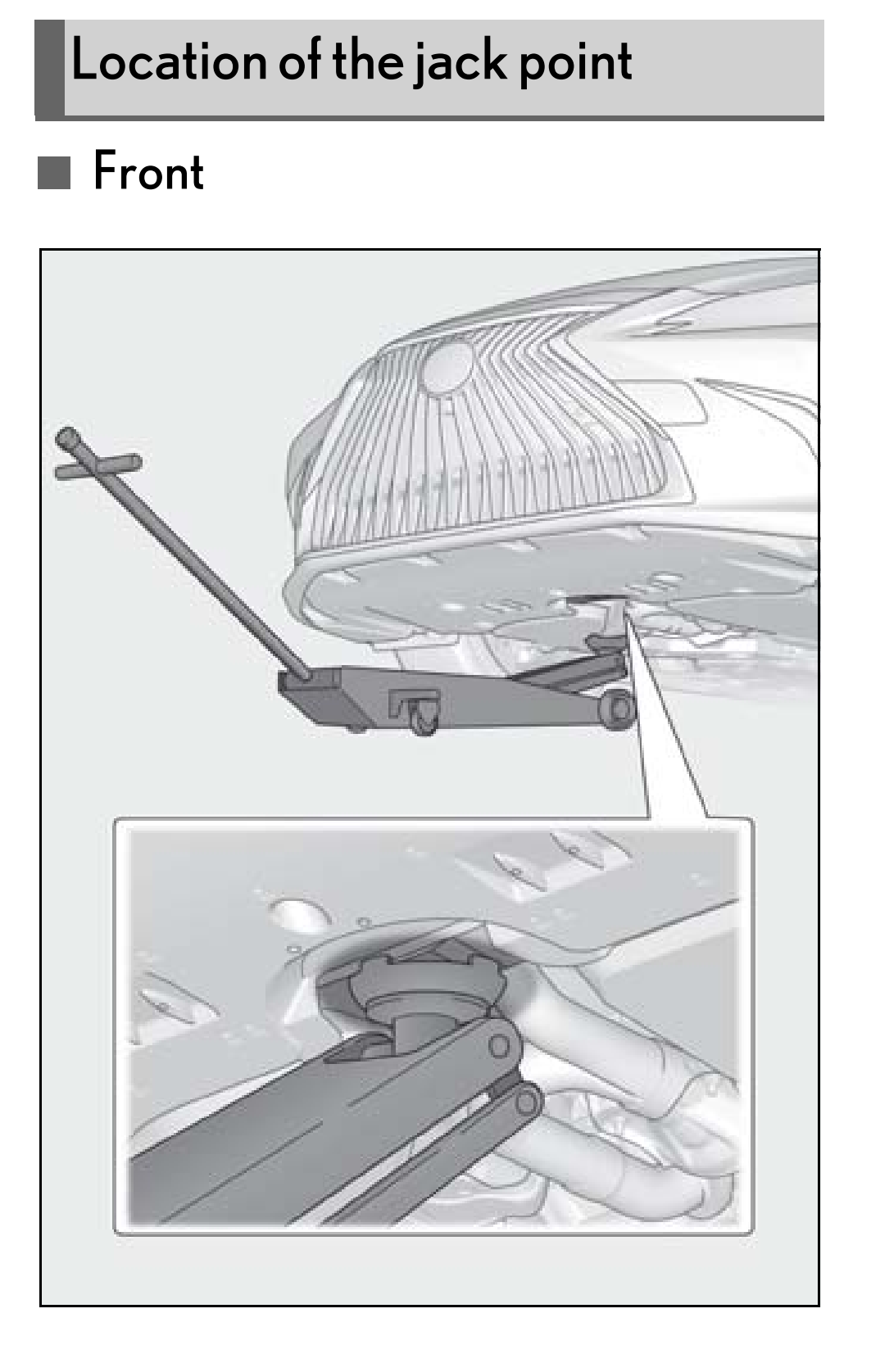

From Lexus Manual for my 2019 ES350, page 308: https://assets.sia.toyota.com/public...f/OM06130U.pdf
The front floor jack lift point is very easy to locate, you can't miss it.

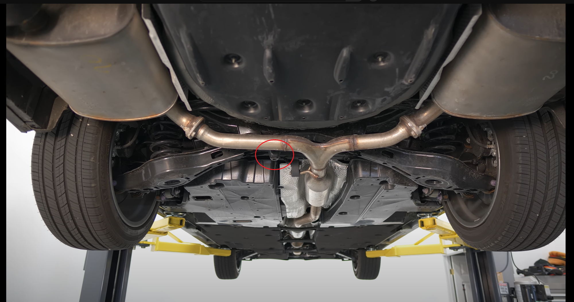

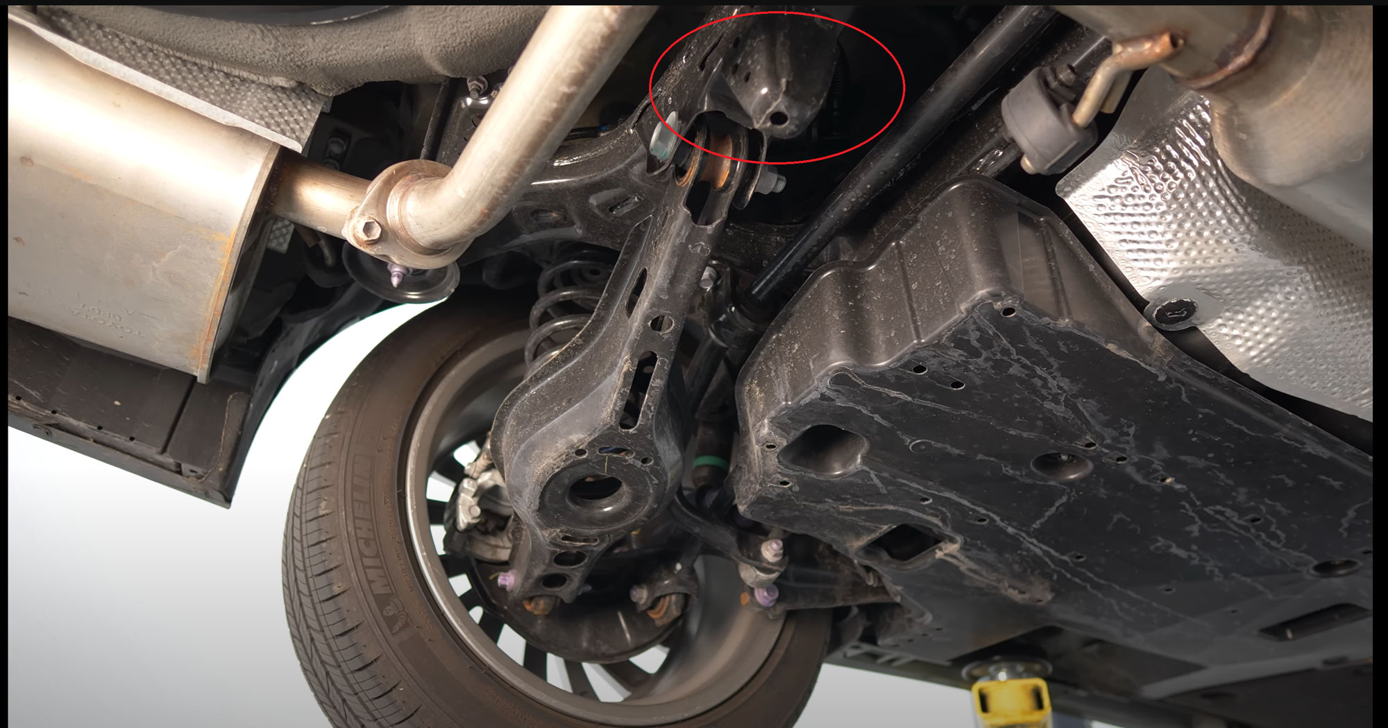

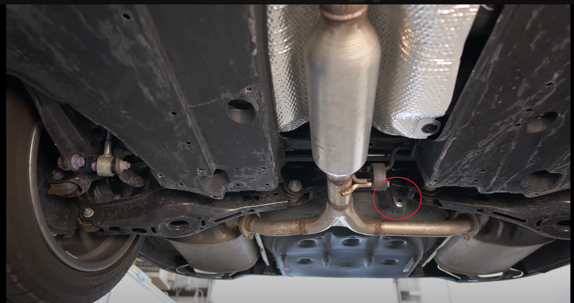

The rear floor jack left point is below. It looks off center to me though. (thanks to this video: youtube.com/watch?v=eVcsTlXoIZA)
Please always use Jack Stands, do not just use floor jack only.
Do not lift your car if you don't know what are you doing. If you are only 99.99% sure, not 100%, of what you are doing, please do not lift your car and bring it to Lexus or a professional.
Don't kill yourself or damage your Lexus.
- View from the back to front
- Right under it:
- View from the front to back:

Thank you so much for this! This is exactly what I was looking for. It's amazing to me how far back that jack point is. Thank you for the warning by the way. That is very important. Again, I really appreciate your help with this!
