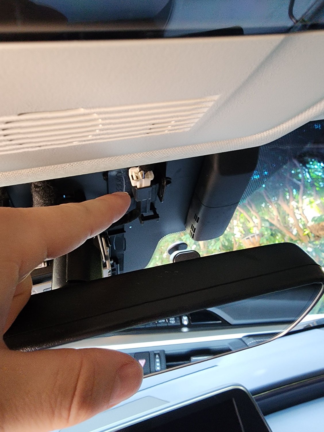

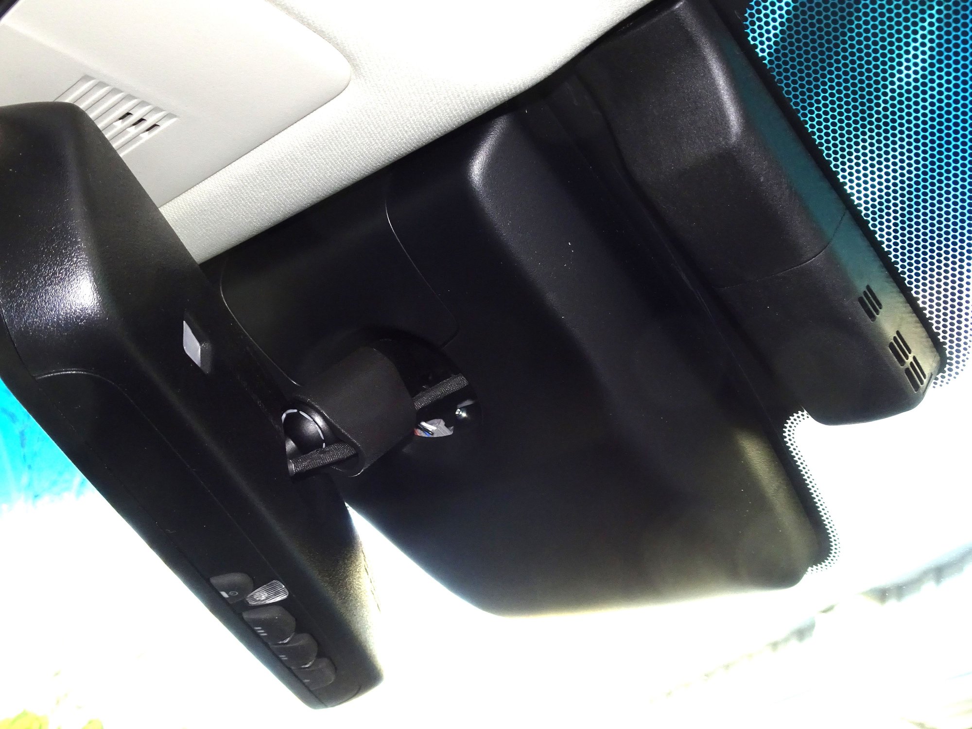

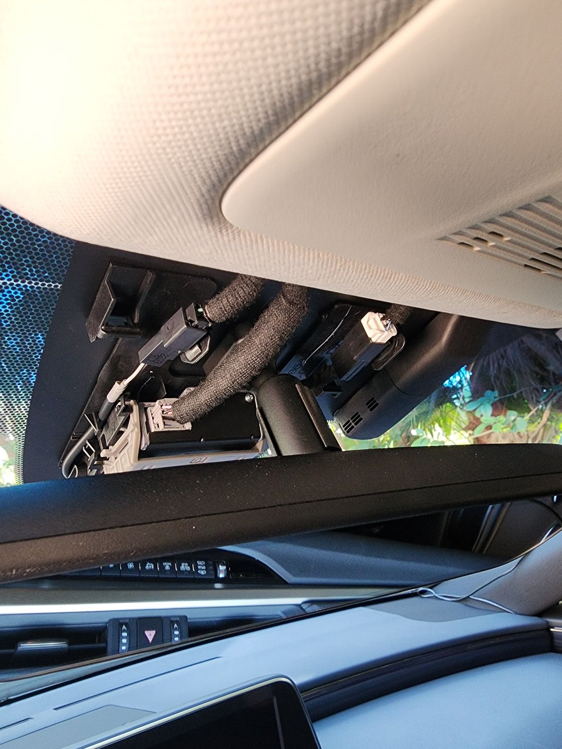

I figured I'd contribute to this thread for future reference. I installed this plug and play rear view adapter on my pop's ES300h. It was pretty much the same as my IS500. See below:
Start
Start
Flip down rear view mirror
From the top, push down (along the windshield) the two housing bits until they pop loose
Remove loose housing bits
Backside of housings so you can see how it clips in
Plug in question, remove carefully
Plug adapter into removed plug
Plug other side of adapter into OEM slot
Plug appropriate USB cord into USB portion of the adapter
Carefully tuck adapter and wires into place. This can be a bit of a PITA
Pop on smaller cover
Carefully slide up big housing, keep an eye on wiring while doing so. Make sure USB cord isnt tucked away
Carefully slide up big housing, keep an eye on wiring while doing so. Make sure USB cord isn't tucked away
