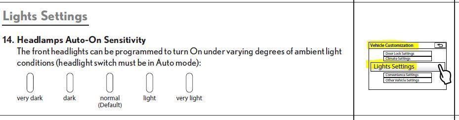

From the Lexus Personalized Settings PDF (2022 - ES 350 / 250)

Mine doesn't have that option(dark/very dark) being the first 2022 model. I have light sensitivity set to -2 at the moment.
I can only select numbers.
Not sure what those numbers mean.

This is from the Owner's manual. Doesn't really explain those numbers well.
I guess these bellow are equivalent to the new model infotainment system then right?
-2 = very light
-1 = light
0 = normal
+1 = dark
+2 = very dark

-2 - very dark
-1 - dark
0 - normal
1 - light
2 - very light
