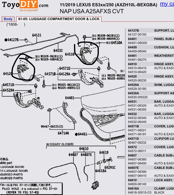

I am positive these two hinges were dry:
Try to lube them with WD40.

Had it in my '19. You'll want to get way up in/underneath there and lube the areas wear the torsion bars mount. They are part number 64531 and 32 in the diagram above.

I read your post again and it's trunk door... or should be "trunk." So yes i was actually one of the first, if not the first, to find the fix for this. i posted about it before. it's the little twist beams up in the trunk. shower it in lube on the left and right side where they touch eachother. but not the smelly kind

Yeah, most obvious place to look was where torsion rods ride in metal bracket. I used a light spray lube which did nothing. I will keep looking.

I put a lot of grease on tue torsion rods but that did not help.
