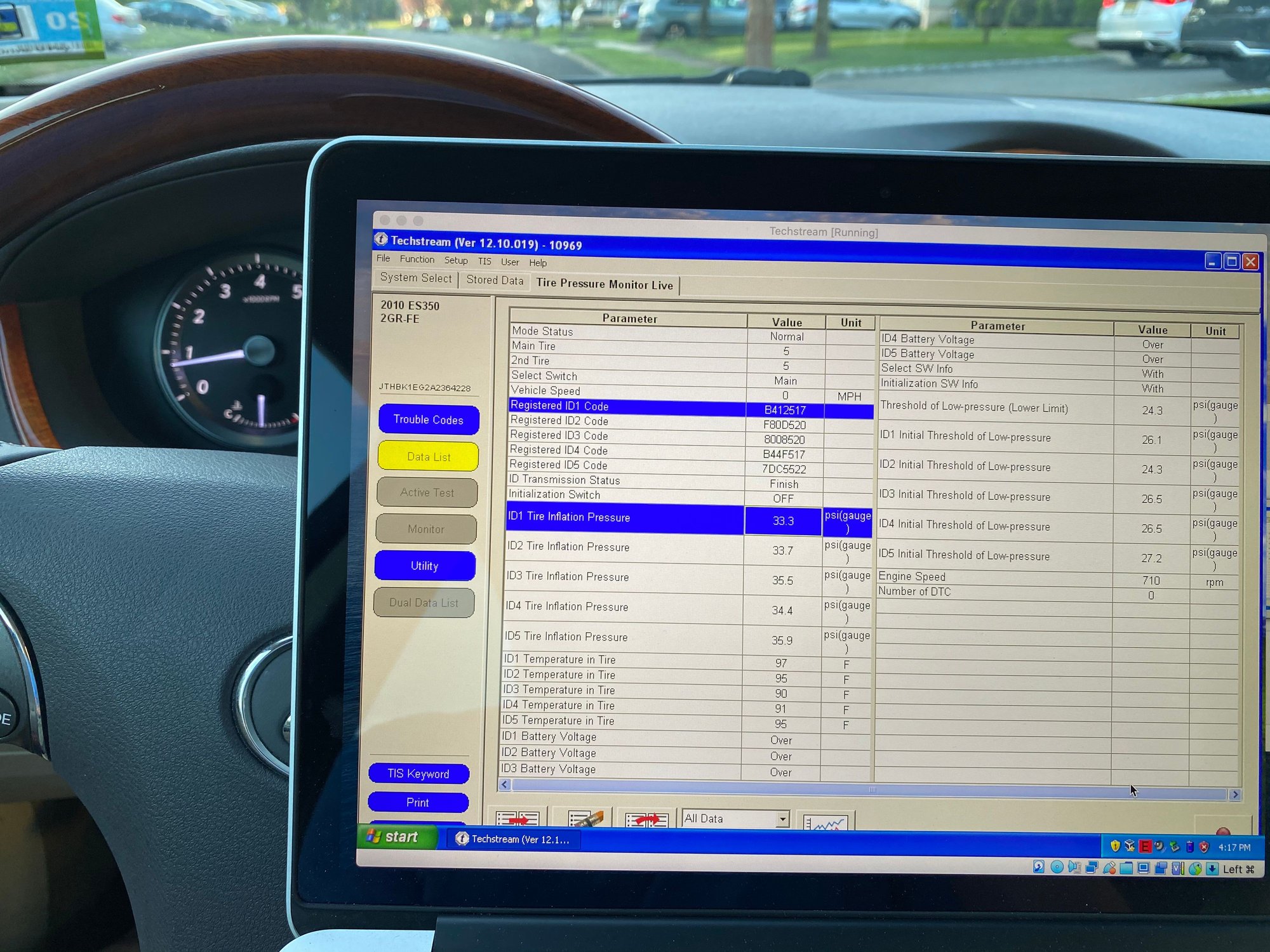

Craig is spot on, after playing around with the Toyota Techstream (dealer software), I found the TPMS trigger is set to 20% below the current tire pressure value at the time of reset. I recommend purchasing a tire gauge such as this one to recheck your pressures when the tires are cold and set them to 32psi.
