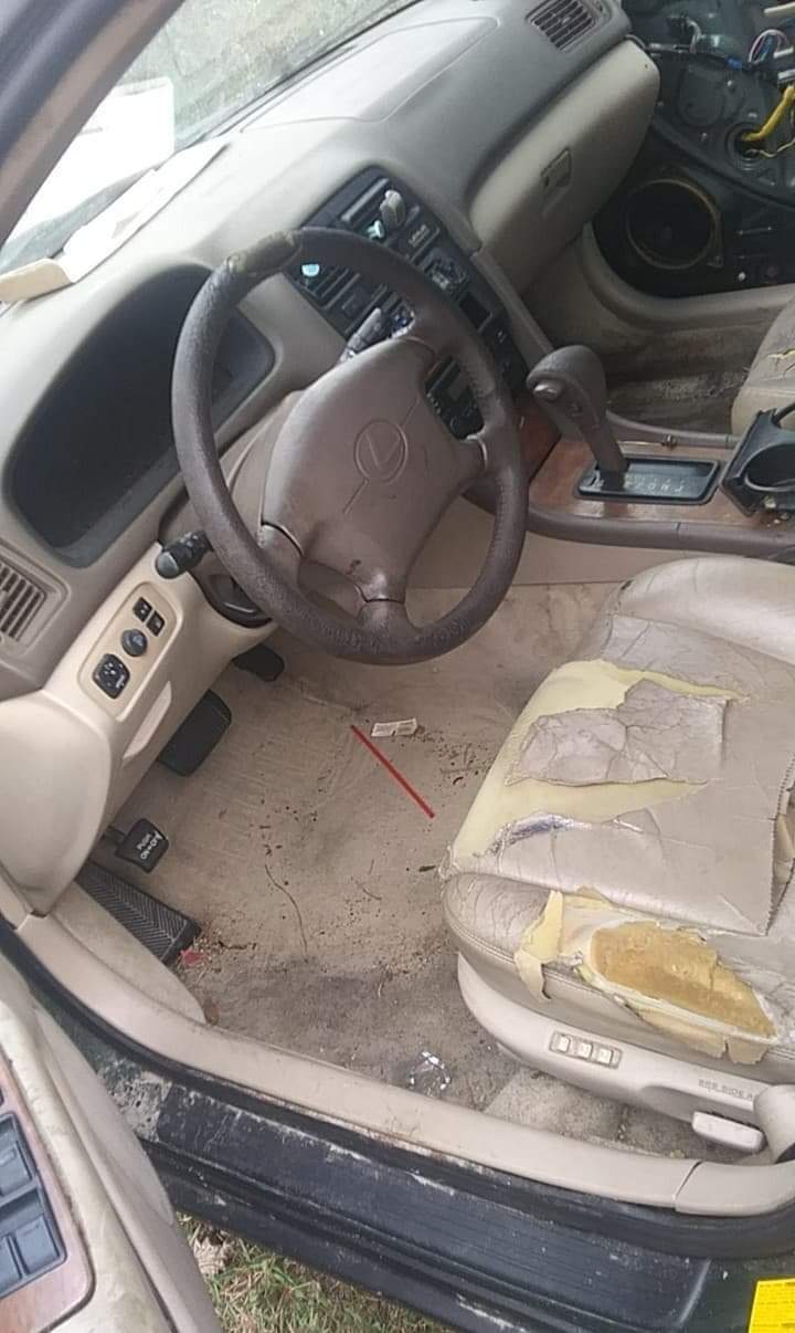

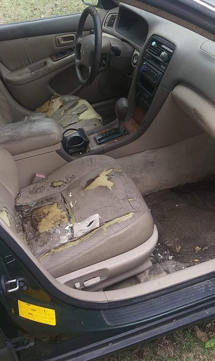

Since these were taken I have bleached and vacuumed out the carpet, scrubbed all the vinyl and door panels and they look better, about ready for painting. The carpet after scrubbing with diluted bleach and carpet cleaner still has some moldy area visible and stains that wont come up but look alot better. These pictures were also taken after the first round of cleaning where i removed well over 100 packs of blue L&M's, trash and other things.
