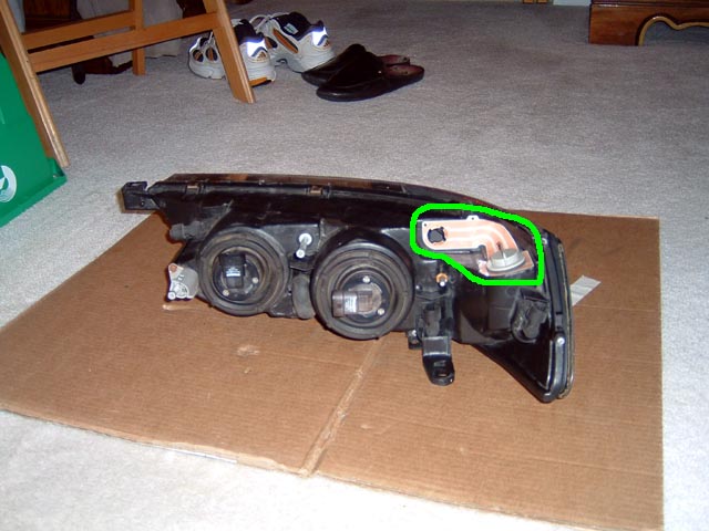

Whichever bulb is affected (front or back) should be taken care of. Let's see, for your '99 ES, the part # for the front turn signal is 1157A, and the rear turn signal is 7440. The front one is very easy to replace. Just pop the hood, locate the grayish plastic circular cover behind the headlight, grab and turn in one direction, and pull out the 1157A bulb. (The pictures below are for the '96 ES, but the bulb type is the same as the '99).
