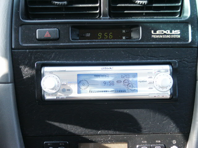

ABS plastic won't look good. a shop did an installation on my car with abs plastic covered with vinyl and it looked like crap! they also rewired all the cables to the speaker b/c the factory ones wont work. you can use the pre-existing mounts, all u have to do is provide support below your stereo unit. the shop put 2 pieces of mdf under the deck to support it. i went to another shop to have the face plate done with mdf and vinyl and they were gonna charge me $200 for it. so i made one myself using 1/2in thick mdf and it supports the deck very well unlike ABS where the deck gets loose very easily.
here's what i did on my car. the vinyl can be bought at any fabric store. the plastic frame came from the shop so i used it.
