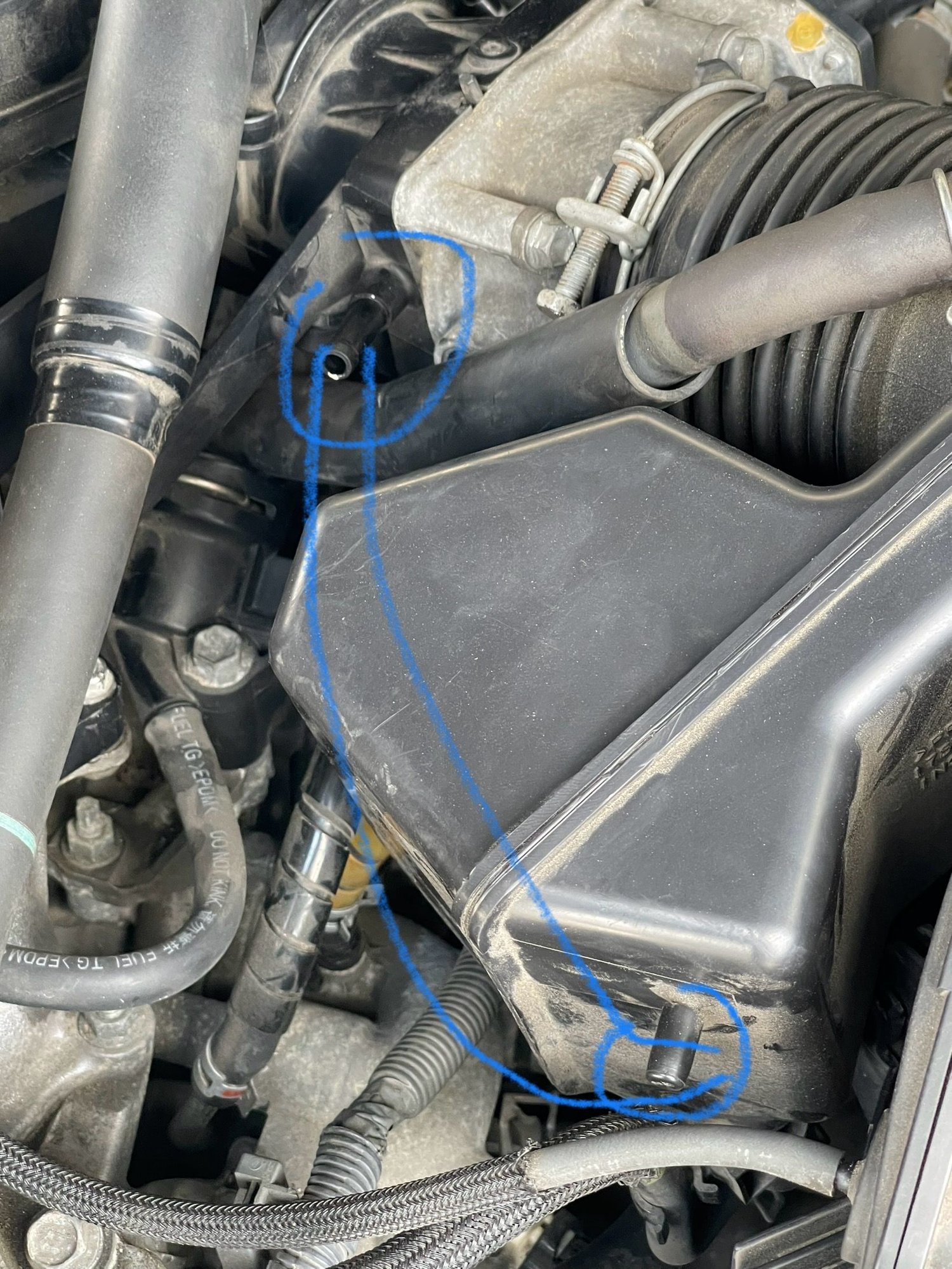

So I had the error code p0441 and I think this tube was missing after I got done changing out my rear spark plugs and ignition coils I wanted to know where I could find another tube for this I know that’s has to be one of reasons for this code to pop up. This is a 2008 Lexus es350

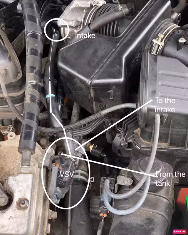

You are missing a hose that connects the intake with the VSV valve.
This one should be clogged/not used.
do you know what the exact part is called? I tried searching everywhere online for the answer

https://www.amayama.com/en/catalogs/...cuum-piping-31
https://www.amayama.com/en/part/toyota/2382631080
Confirm the schematics above are correct to your vehicle.
Also, there is a vacuum piping diagram sticker located under the hood of your car
example of es300
