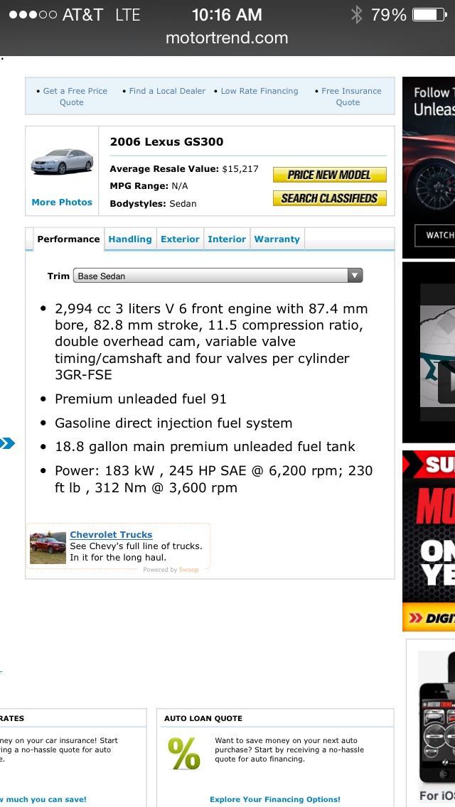

You are correct genius, the injectors are electrically controlled to spray fuel directly into the each cylinder. Weather it's electric or mechanical it's still direct injection. And I am aware that gen2 and gen3 are two different generations, but thanks for checking. I'm not sure if I had a typo but I was stating that it will happen to every 2006 gs300 gen 3's, Not the gen two. And the only solution for a permanent fix would be replace the engine with an entirely differently designed engine. Replacing rings, pistons, valves and such doesn't change where the fuel comes into the cylinder.
So why the hell are you posting it in the completely wrong forum for a completely different car with a completely different engine? Your issue will not happen to the 2jz because it DOES NOT HAVE DIRECT INJECTION, so you posting some random issue that has nothing to do with the OP's issue makes zero sense. You say I don't know how an engine works when we are talking about oranges and you bring a ****ing apple to the conversation.
And it's clear to everyone here that you don't know how to research. You bought the car thinking it was an issue that effected a small percentage of the production run prior to X amount of miles, well guess what IT DOES ONLY EFFECT A SMALL AMOUNT OF THE RUN before they rack up a ton of miles. And it looks of people are getting it fixed (or at least the ones who didn't wait 9 years like you did). So you just proved to us all that you didn't know how direct injection works, and that eventually it will effect all of those engines because you went ahead and bought the car anyway. No one has created the infinite mile engine yet, why do you expect them to re-engineer an engine for your 9 year old car?
