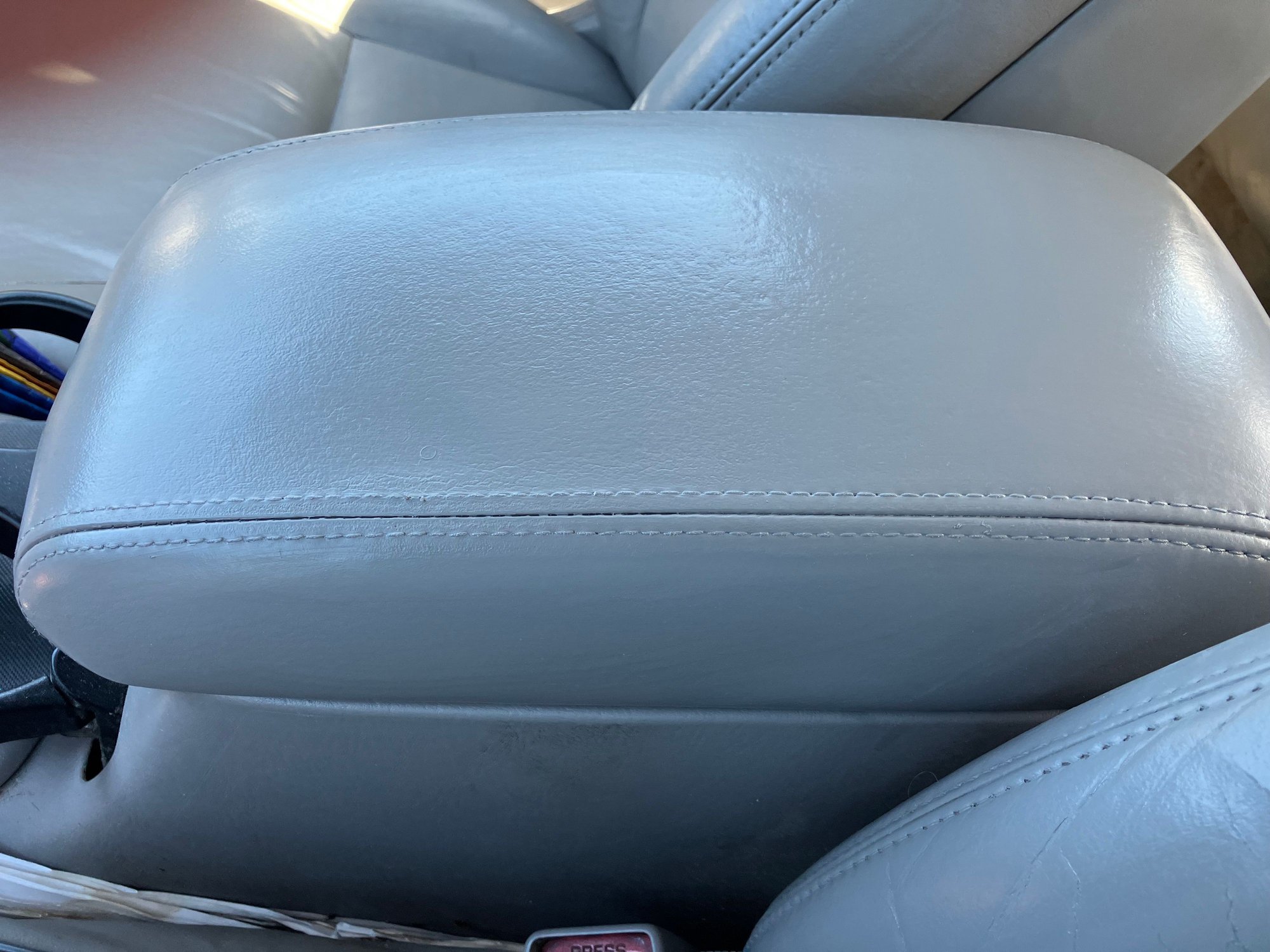

Recently re-dyed my armrest using Seat Doctors
https://www.seatdoctors.com/lexus-leather-dye/lexus-es-leather-dye
Color match was excellent
My comments
Their website talks about different prep methods. I used simple green
Be sure to do the proper prep & ensure leather is dry before applying
My applicator was a polyester cloth. I tried a basic kitchen sponge too, but product clogged up and streaked
When applying, do it in the shade. Product lays down best when flash is 10-15 minutes, keeping the streaks to a minimum. I applied a coat that flashed in 3 minutes (sunshine), leaving streaks.
They sell a sealer too but is not required, per their website, . The product I used seems to be a bit of all in one. Has been on 3 weeks and so far so good. I only wipe it down with a damp towel to keep clean
We see how it goes with the Southern California heat and suntan lotion....

Also, I did not buff, polish or put any conditioner on the leather after the seat doctor treatment. What's shown in the photos is how it looked after drying/cured
The product seems more like a dye, paint, polish all in one.

UPDATE:
Still holding up
I only wipe down with damp cloth - no chemicals
