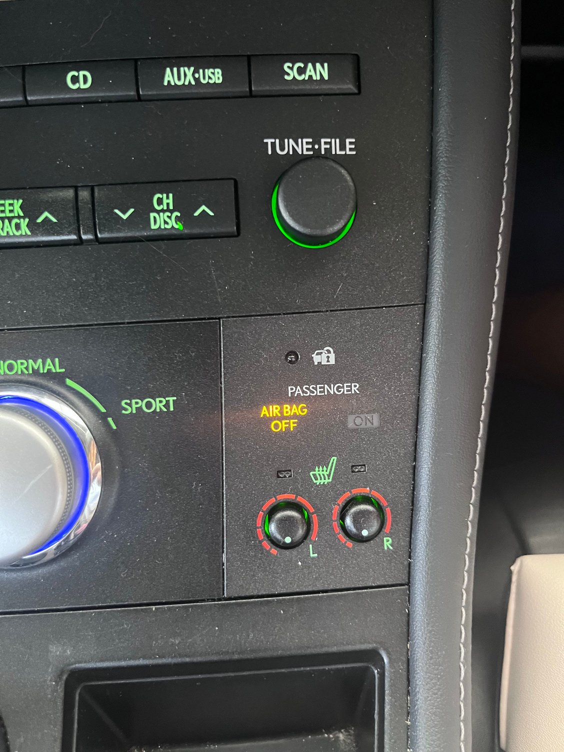

Hello everyone, need help.
My 2012 CT200h has an airbag off light that stays on. I checked the glove box but couldn't find the switch. Where can I find a place to turn it on?

The seat weight sensor will turn the "off" light "on" if the seat belt is not latched. I get this frequently if I throw my laptop bag on the passenger seat. The only way to turn the airbag "on" is to have the seat weight sensor detect weight and have the seat belt latched.
So if you don't have anything laying on your seat while driving, this could be a faulty seat weight sensor or seat belt buckle switch. Same goes for if you have a belted passenger with the "off" light present.

That is normal. That light should be on, unless someone is sitting in the passenger seat, in which case, the light will change to "ON" instead.

it’s on every time and doesn’t change.
